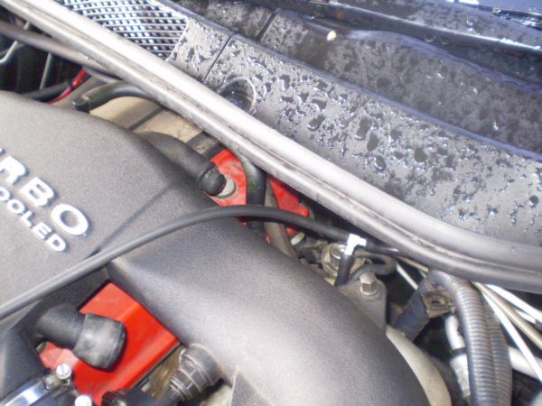

XR666Turbz Member 18 Member For: 16y 7m 3d Gender: Male Location: Adelaide Posted 24/10/08 10:12 PM Share Posted 24/10/08 10:12 PM Howdy!I installed a boost guage the other night and I was wondering if someone could send me a diagram or photo outlining the line I need to cut into to put the t peice so I can start reading za boost :D Cheers! Link to comment https://www.fordxr6turbo.com/forum/topic/51026-boost-guage-install/ Share on other sites More sharing options...
sensoryamusia Member 398 Member For: 17y 1m 20d Gender: Male Location: leeming, PERTH Posted 24/10/08 11:02 PM Share Posted 24/10/08 11:02 PM (edited) here ya go mate took a quick snap.if you're running a stock blow off valve it might be a little harder to get to (might even have to remove the crossover) Edited 24/10/08 11:16 PM by sensoryamusia Link to comment https://www.fordxr6turbo.com/forum/topic/51026-boost-guage-install/#findComment-755249 Share on other sites More sharing options...
XR666Turbz Member 18 Member For: 16y 7m 3d Gender: Male Location: Adelaide Posted 25/10/08 07:20 AM Author Share Posted 25/10/08 07:20 AM thanks cheif, greatly appreciated Link to comment https://www.fordxr6turbo.com/forum/topic/51026-boost-guage-install/#findComment-755404 Share on other sites More sharing options...
phantom xr6t Talks Cheap, Let's Race Member 596 Member For: 18y 5m 15d Gender: Male Location: Atherton, FNQ Posted 03/11/08 09:20 AM Share Posted 03/11/08 09:20 AM I was given a boost gauge the other day, I plumbed it into that pipe with a tee piece and it works great, shows vac and boost. Link to comment https://www.fordxr6turbo.com/forum/topic/51026-boost-guage-install/#findComment-761537 Share on other sites More sharing options...
marek Member 32 Member For: 16y 6m Gender: Male Posted 07/11/08 10:56 AM Share Posted 07/11/08 10:56 AM same way ive done it works great Link to comment https://www.fordxr6turbo.com/forum/topic/51026-boost-guage-install/#findComment-763915 Share on other sites More sharing options...
