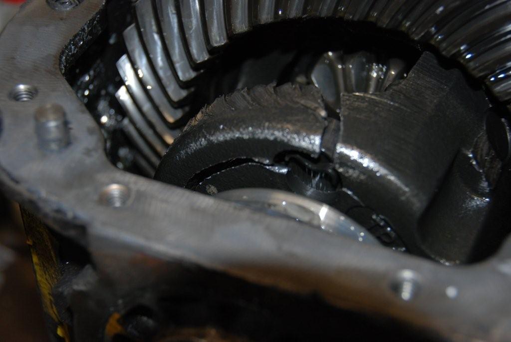

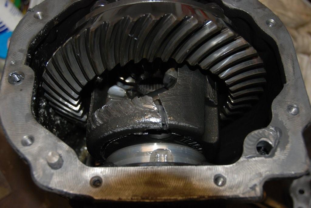

GreenXR6T Donating Members 630 Member For: 19y 8m 23d Gender: Male Location: NSW Posted 29/08/09 11:22 AM Author Share Posted 29/08/09 11:22 AM After breaking a few more cv's and axels (5 in all) I went down the path of getting the replacement hardened cages and star for the standard driveshafts that Danny mentioned earlier in the thread. I also had Haden from Albins gears (brilliant mob there) arrange a set of axles.I originally avoided this because I didn't like the look of the parts I had to re-use (slightly worn) but all the others options failed me.I wasn't keen to fork out $3400 on KPM shafts and Nizpoo were a bit to pricey as well.They are definitely a lot stronger (done more passes down WSID in one night than all the other replacement ones put together) but I came across the next weak link in the driveline...Here's a couple of shots of the damage. Link to comment https://www.fordxr6turbo.com/forum/topic/49515-broke-a-cv-again/page/5/#findComment-926797 Share on other sites More sharing options...
qik1 Silver Donating Members 2,720 Member For: 17y 15d Gender: Male Location: Loitering in SEQ Posted 29/08/09 01:39 PM Share Posted 29/08/09 01:39 PM buggar, bloody manuals. lol.Whats it getting replaced with? Link to comment https://www.fordxr6turbo.com/forum/topic/49515-broke-a-cv-again/page/5/#findComment-926855 Share on other sites More sharing options...
