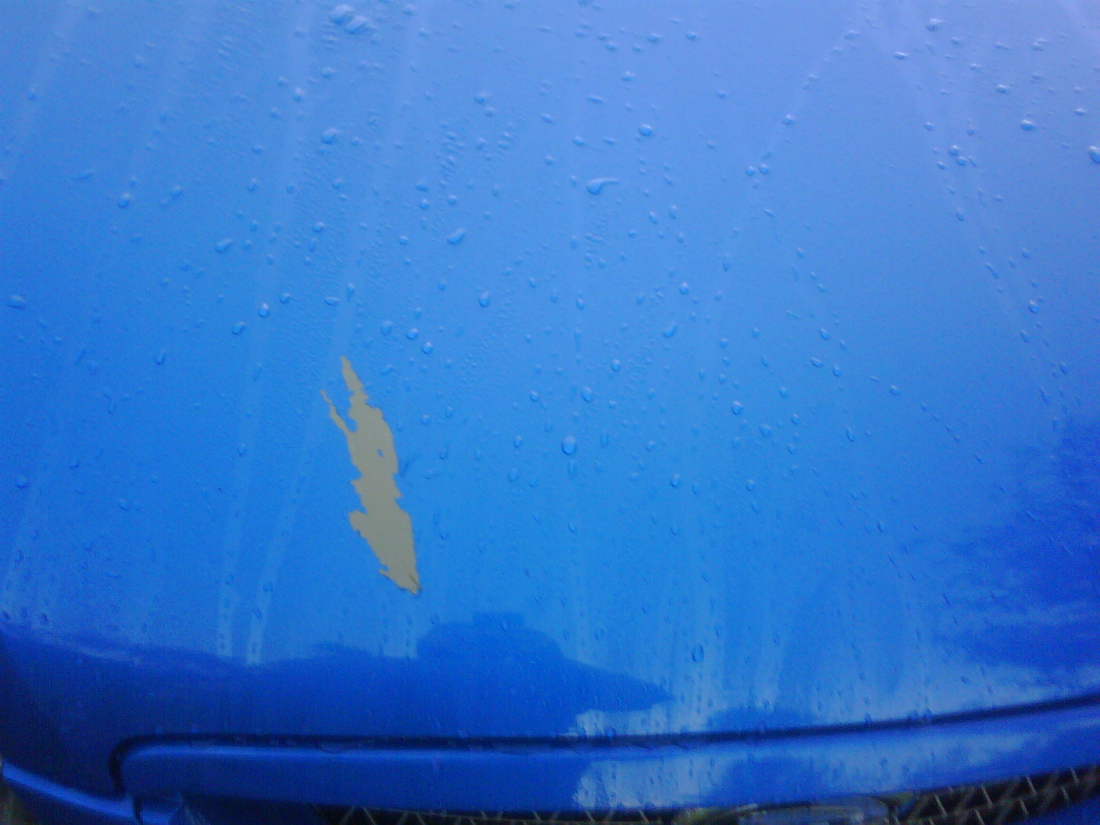

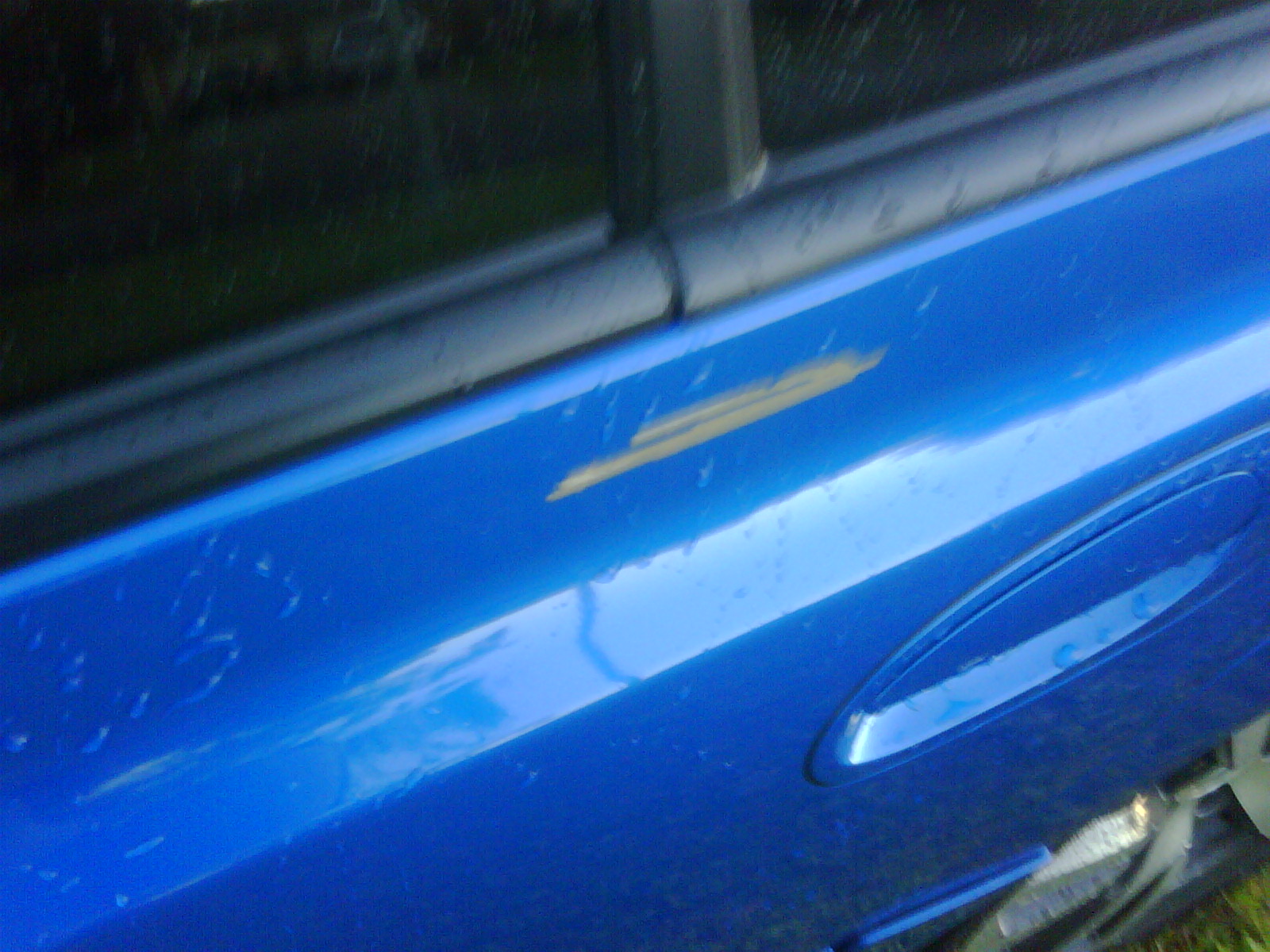

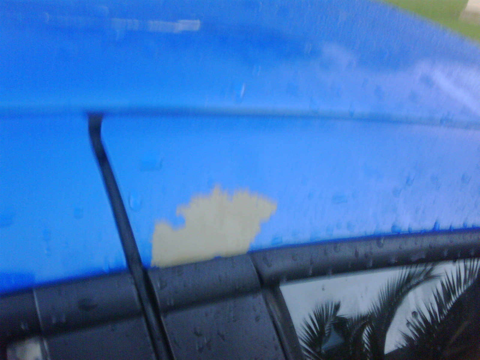

BF_F6Shockwave Member 444 Member For: 16y 2m 26d Gender: Male Location: Newcastle NSW Posted 13/07/09 11:28 PM Share Posted 13/07/09 11:28 PM see the pics as to how my paint has deteroirated over the past few months..On the plus side I recieved a call from Ford this morning and they have approved the whole car for a respray Finally Link to comment https://www.fordxr6turbo.com/forum/topic/49022-ba-mkii-shockwave-paint-problems/page/8/#findComment-906255 Share on other sites More sharing options...
CHLAXN Donating Members 932 Member For: 16y 10m 29d Gender: Male Location: north QLD Posted 14/07/09 02:19 AM Share Posted 14/07/09 02:19 AM good to hear its getting a full respray mate Link to comment https://www.fordxr6turbo.com/forum/topic/49022-ba-mkii-shockwave-paint-problems/page/8/#findComment-906318 Share on other sites More sharing options...
