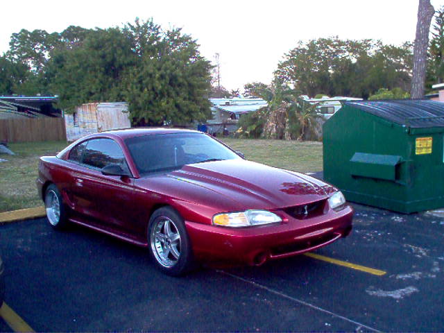

mustangman57 Member 11 Member For: 16y 10m 17d Posted 15/06/08 10:16 PM Author Share Posted 15/06/08 10:16 PM thanks a lot. the T5 is a pretty dirty word around here also. I am actually on my 4th T5 in my mustang. but I have been having trouble deciding on going with a T56, TKO, or a C4 automatic in my stang. it isnt hard to register a RHD car in the states my best friend has a RHD Skyline that he drives daily, the hardest part is getting the car here in the states. I would love to get one of these cars. I really appreciate all the help here keep the info coming. this is probably a dumb question but, did this motor make it to the states in any car over here. maybe just the block or just the head.... so that way I can get the bottom end or the head or something here then I would only have to order what I cant get here. im probably getting annoying with all of these questions but I am truly and absolute newbie with this car. I know everything about mustangs but I know pretty much nothing about the XR6T. just for the hell of it here is a pic of MY BABY. Link to comment https://www.fordxr6turbo.com/forum/topic/46648-new-to-the-xr6t/page/2/#findComment-693665 Share on other sites More sharing options...

kaldek Member 71 Member For: 17y 9m 5d Posted 15/06/08 11:23 PM Share Posted 15/06/08 11:23 PM (edited) mustangman57 said: everyone think of the stang? beautiful isn't it? australia wasn't lucky enough to get the stang right? they are pretty rare over there right? oh and is the 302 HO (5.0 liter) an available engine over there? just curious.The Mustang has been sold here on and off over the years. The latest version is a a nice car, but you'll find a lot of folks here (including myself) who hated the '90s Mustang shape. Basically the Mustang would be unlikely to sell here, as the Falcon performance models (XR6T, XR8, FPV F6 and FPV GT) handle better, are faster, and are made to a higher quality because the Australian market is very demanding.Consider that the Mustang is still sold with a live rear axle and every Falcon model has a seriously well designed independent rear suspension setup (since 2002), and the Mustang just can't hold its own in this market. Believe me, the day you drive one of these cars you will wonder what Ford USA is thinking with regards to chassis dynamics.The only V8 used by Ford at the moment is the Triton 5.4 litre DOHC engine (but they call is "Boss" here). Currently it's putting out 315kw, 5kw more than the latest 4 litre turbo six but less torque. Most of the car magazines don't like this motor as it's not as fast as the turbo six and a bit underwhelming. Ford is considering moving straight to the 5.0 litre direct-injected V8 to replace the 5.4 litre engine. The price of Fuel is seriously affecting the direction our local manufacturers are going. Edited 15/06/08 11:25 PM by kaldek Link to comment https://www.fordxr6turbo.com/forum/topic/46648-new-to-the-xr6t/page/2/#findComment-693676 Share on other sites More sharing options...
