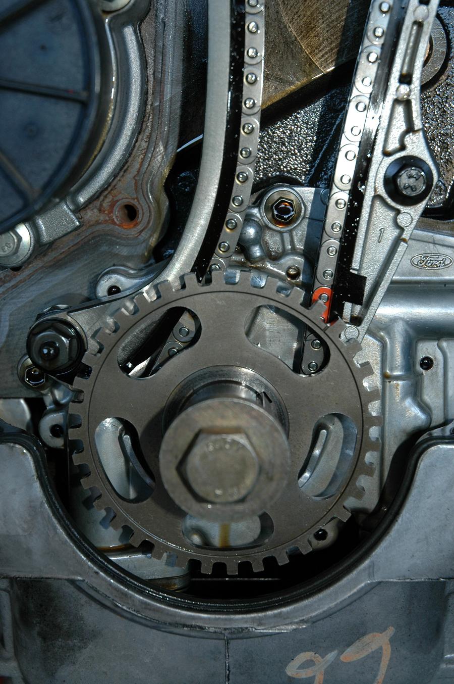

destino Member 25 Member For: 17y 8m 2d Posted 01/06/08 08:42 AM Share Posted 01/06/08 08:42 AM Does anyone know how to install the timing chain on the xr6t's?The top is self evident (two yellow links align with 2 markings on cam pulleys)But not to sure on the bottom. I think my chain might have skipped a link on a heavy down gear. Car rev’s died and engine shutdown. When I tried starting it, sounded as if it was out of time.Not to sure if the marking on the bottom pulley is were the bottom yellow link of the chain must line up.Here’s a pic of the bottom timing pulley.Any help appreciated-Daniel Link to comment Share on other sites More sharing options...
ETM Member 1,194 Member For: 18y 23d Gender: Male Location: syd south Posted 01/06/08 08:48 AM Share Posted 01/06/08 08:48 AM sit the cams dots up, the yelow (I think) marks will line up with the dots.the crank should be at tdc as you have it in the picture, now there is 2 painted links down there, one yellow one orange from memory, now one of those coloured link should sit directly behind that mark on the sprocket that you pointed out (6 oclock) the other painted link will be at about 5 oclock. Link to comment Share on other sites More sharing options...

destino Member 25 Member For: 17y 8m 2d Posted 01/06/08 11:46 AM Author Share Posted 01/06/08 11:46 AM Hey guys thanks alot for the help. much appreciated. will buy new chain and pulley and hope everything else is ok.have a good one-Daniel Link to comment Share on other sites More sharing options...
