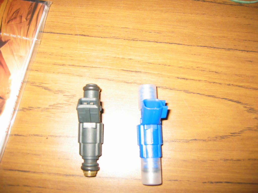

bjc Donating Members 2,823 Member For: 21y 8m 9d Gender: Male Location: Townsville Posted 31/03/08 02:54 AM Share Posted 31/03/08 02:54 AM Well as the title says I bought some Eugene Injectors new off Muzza on this forum just recently and although was told they are a direct fit to XR8's, they are not!Although I am extremely dirty about this sh*t happens as I should have investigated more into this before purchasing so dont take anyones word when buying items, do your research.Please view the photos to the difference in injectors and also an Ebay site that sells adapters to suit instead of modifying the harness.Cheers,BrettAdapter 1Adapter 2 Link to comment https://www.fordxr6turbo.com/forum/topic/44044-eugene-injectors-dont-fit-ba-xr8s/ Share on other sites More sharing options...

Wranglerfpr000 New Member 20 Member For: 8y 6m 11d Posted 23/05/17 01:09 AM Share Posted 23/05/17 01:09 AM im pretty sure you can get plug adaptors to suit, the nozels and fitment at bothe ends are identical. Its just the plug, I have seen adaptors. Link to comment https://www.fordxr6turbo.com/forum/topic/44044-eugene-injectors-dont-fit-ba-xr8s/#findComment-1639684 Share on other sites More sharing options...

Ralph Wiggum Moar Powar Babeh Lifetime Members 19,332 Member For: 19y 7m 19d Gender: Male Location: Perth Posted 23/05/17 01:34 AM Share Posted 23/05/17 01:34 AM On 23/05/2017 at 1:09 AM, Wranglerfpr000 said: im pretty sure you can get plug adaptors to suit, the nozels and fitment at bothe ends are identical. Its just the plug, I have seen adaptors. Expand USCAR to EV1 adaptors. Common as big toes these days. Link to comment https://www.fordxr6turbo.com/forum/topic/44044-eugene-injectors-dont-fit-ba-xr8s/#findComment-1639687 Share on other sites More sharing options...
