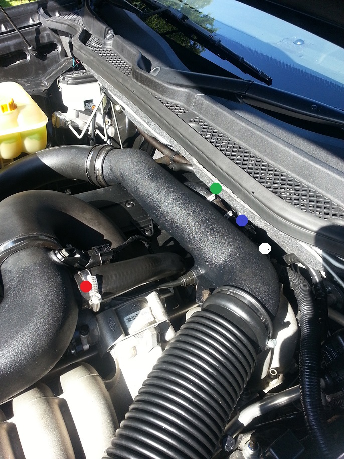

PH1LLO Member 56 Member For: 12y 9m 20d Gender: Male Location: SE suburbs, Vic Posted 08/09/13 05:08 AM Share Posted 08/09/13 05:08 AM So I feel dumb for asking, but can someone help me out with this on my Terry. New to turbos, and wanna try this for a day or so.So the red dot is is post intercooler, and the 30odd mm hose goes to the BOVthe green dot is the air intake that goes to the other side of the BOV,The white dot is like a 8mm line coming off the end of the BOVThe blue isss the BOV.What and where do I block/vent? The write up is good, but as it looks a bit different on the terry I just want to make sure im doing it correct. Cheers boys Link to comment https://www.fordxr6turbo.com/forum/topic/43919-venting-the-stock-bov/page/27/#findComment-1422381 Share on other sites More sharing options...
Doddo22 Member 135 Member For: 12y 1m 18d Gender: Male Location: Newcastle Posted 08/09/13 05:59 AM Share Posted 08/09/13 05:59 AM On 08/09/2013 at 5:08 AM, PH1LLO said: So I feel dumb for asking, but can someone help me out with this on my Terry. New to turbos, and wanna try this for a day or so.So the red dot is is post intercooler, and the 30odd mm hose goes to the BOVthe green dot is the air intake that goes to the other side of the BOV,The white dot is like a 8mm line coming off the end of the BOVThe blue isss the BOV.What and where do I block/vent? The write up is good, but as it looks a bit different on the terry I just want to make sure im doing it correct. Cheers boysignore the red dot end of the hose, remove hose from green dot(where it enters blow off valve) use a chair stopper to plug this hose and use existing clamp to hold it in, now this end of the blow off valve will be free, if you want to block it off to make the tu tu tu sound (flutter) put a chair stopper in this end as well and clamp it on, if you want to make a whoosing sound, either but the mini breather on it or a rubber stopper with a 8mm or thereabouts hole in it Link to comment https://www.fordxr6turbo.com/forum/topic/43919-venting-the-stock-bov/page/27/#findComment-1422408 Share on other sites More sharing options...
PH1LLO Member 56 Member For: 12y 9m 20d Gender: Male Location: SE suburbs, Vic Posted 08/09/13 09:14 AM Share Posted 08/09/13 09:14 AM (edited) On 08/09/2013 at 5:59 AM, Doddo22 said: ignore the red dot end of the hose, remove hose from green dot(where it enters blow off valve) use a chair stopper to plug this hose and use existing clamp to hold it in, now this end of the blow off valve will be free, if you want to block it off to make the tu tu tu sound (flutter) put a chair stopper in this end as well and clamp it on, if you want to make a whoosing sound, either but the mini breather on it or a rubber stopper with a 8mm or thereabouts hole in itThanks mate, exactly the explanation I was chasing. will have a crack at this tomorrow.Just out of curiosity, the Red and the Green dot, which is the inlet/outlet Edited 08/09/13 09:16 AM by PH1LLO Link to comment https://www.fordxr6turbo.com/forum/topic/43919-venting-the-stock-bov/page/27/#findComment-1422536 Share on other sites More sharing options...
Doddo22 Member 135 Member For: 12y 1m 18d Gender: Male Location: Newcastle Posted 08/09/13 10:43 AM Share Posted 08/09/13 10:43 AM green dot is outlet of blow off valve, hence the whooshing sound when it is disconnected and vented straight to atmosphere instead of just being plumbed back Link to comment https://www.fordxr6turbo.com/forum/topic/43919-venting-the-stock-bov/page/27/#findComment-1422596 Share on other sites More sharing options...
