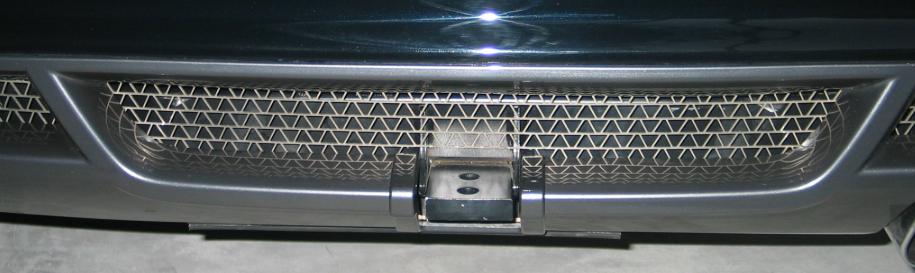

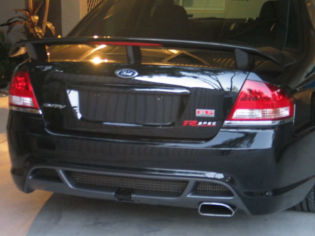

MADF6 Member 399 Member For: 17y 4m 19d Posted 13/03/08 09:01 AM Author Share Posted 13/03/08 09:01 AM bigmat said: That way people like myself wouldn't be concerned and get in your face about it,....... isn't this a performance car not a $500 tow car, if you want to do that why didn't you buy a HSV they do that sort of thing all the time.... but hey they are w a n k e r s...It's nice to know you have so concern for my car. Now go away -> Back to the towbar. I decided to go with the factory ford one and had the dealership (Denmac) at Darra do it. I'm very happy with the job they did. I went with the factory tongue jobbie because I only need to tow a few times a year and I can take the tongue/tow ball off when I'm not using it. I think it looks very discrete. The flashing that's mounted around the towbar comes with the towbar kit but you can purchase it seperately.Wadaya think ¿Rear ShotClose up Link to comment https://www.fordxr6turbo.com/forum/topic/43430-typhoon-towbar/page/3/#findComment-645417 Share on other sites More sharing options...
R-SPEC You are a dead set goose Silver Donating Members 3,968 Member For: 19y 6m 12d Gender: Male Location: Melbourne Posted 13/03/08 09:14 AM Share Posted 13/03/08 09:14 AM (edited) Looks factory. that's about as good as you're gonna get a F6 with a towbar to look!Oh and the RSpec looks absolutely mint in black! Edited 13/03/08 09:14 AM by R-SPEC Link to comment https://www.fordxr6turbo.com/forum/topic/43430-typhoon-towbar/page/3/#findComment-645424 Share on other sites More sharing options...

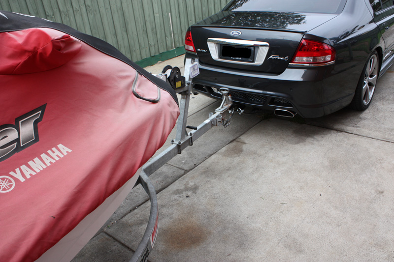

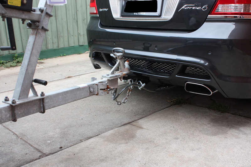

arm79 Donating Members 214 Member For: 16y 3m 16d Gender: Male Location: Melbourne Posted 13/04/09 01:14 PM Share Posted 13/04/09 01:14 PM R-SPEC said: Looks factory. that's about as good as you're gonna get a F6 with a towbar to look!Nah, there is better... And I'd hate to say to all the previous posters, I managed to get there.This is how Ford should have done it for those of us that actually need to tow with these things.Sorry about dragging up an old thread, but it seems there is a solution for us if needed. I actually pulled up next to another Force 6 on the way to Geelong on Saturday and the guy wanted to know how I did it, as he had to chop his bar like everyone else. He wasn't happy. Link to comment https://www.fordxr6turbo.com/forum/topic/43430-typhoon-towbar/page/3/#findComment-859969 Share on other sites More sharing options...
Mist Member 54 Member For: 18y 10m 27d Posted 14/04/09 02:19 AM Share Posted 14/04/09 02:19 AM Looks great.So what's it called? Where did you get it? (although living in NZ I'm more interested in what it is called than where you got it!). Link to comment https://www.fordxr6turbo.com/forum/topic/43430-typhoon-towbar/page/3/#findComment-860091 Share on other sites More sharing options...
arm79 Donating Members 214 Member For: 16y 3m 16d Gender: Male Location: Melbourne Posted 15/04/09 04:37 AM Share Posted 15/04/09 04:37 AM (edited) Its a standard Hayman Reese 1600kg towbar with a spacer inserted between the bar and tongue.This gets the tongue low enough to go "under" the bar, rather than through the middle of it.I measured and cut the hole myself with a stanley knife (these bars are thin as - I had to use a jigsaw to do the same on my EL) and the cutout just hangs there like a door, so when you take the tongue off you can close it back up and its barely noticable there is a towbar hidden behind there.Total cost was $320 including the Ford reverse sensor loom. Does not include the cost of replacement underwear for the first few cuts I made into the bar though. Edited 15/04/09 04:38 AM by arm79 Link to comment https://www.fordxr6turbo.com/forum/topic/43430-typhoon-towbar/page/3/#findComment-860979 Share on other sites More sharing options...

arm79 Donating Members 214 Member For: 16y 3m 16d Gender: Male Location: Melbourne Posted 17/04/09 12:33 AM Share Posted 17/04/09 12:33 AM There was alot of measuring and checking involved to make sure I got the right bar. I did approach a half dozen towbar manufacturers in Melbourne to work out which is the best one, and the Hayman Reese one came up as the one.There still was a need to cut some of the mesh below the bumper line, but you cant see it at all.I should have taken pics, and I will soon. I have to take the rear bar back off to make some more mods and check what I've done. So pics can be taken then.Also want to get the spacers welded to the actual towbar itself to save having them float around my boot.But that is the only slightly illegal thing about this whole setup. In order to make this work, you need to put one extra spacer between the tongue and bar to drop it low enough. This means the trailer drawbar sits lower to the ground than normal. For me its not a problem as I don't tow heavy loads. But if you were towing heavy loads, it may be a problem. I'm looking for a new tongue that I can get to overcome these problems for me. Link to comment https://www.fordxr6turbo.com/forum/topic/43430-typhoon-towbar/page/3/#findComment-862059 Share on other sites More sharing options...
