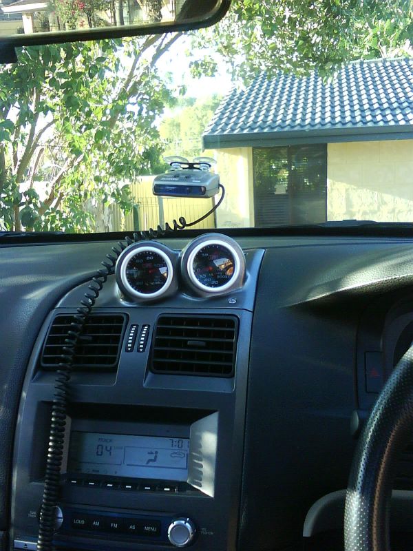

sensoryamusia Member 398 Member For: 16y 10m 17d Gender: Male Location: leeming, PERTH Posted 17/05/08 05:56 AM Share Posted 17/05/08 05:56 AM shaun mine is the twin ss inductions one with the screws in it (got alys pod coming in the mail)with 2 auto gauges (boost, oil pressure)I might take a pic with my camera phone Link to comment Share on other sites More sharing options...
sensoryamusia Member 398 Member For: 16y 10m 17d Gender: Male Location: leeming, PERTH Posted 17/05/08 07:58 AM Share Posted 17/05/08 07:58 AM (edited) pics are pretty crappy, but you get the idea.I'm changing the pod when I get ally's in the mail, those screws just piss me off!edit: I'm also going to hardwire my radar detector Edited 17/05/08 07:59 AM by sensoryamusia Link to comment Share on other sites More sharing options...

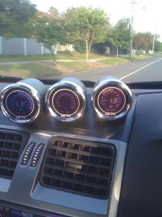

Coley Member 110 Member For: 16y 8m 25d Gender: Male Location: Ipswich Posted 06/09/08 09:01 AM Share Posted 06/09/08 09:01 AM (edited) Does the distance between your bov and the t piece matter? I have my bov near the battery and the t piece is where the vac line is (where factory bov usually is). The boost sensor is also mounted inside the cabin so about a metre from the t piece. Will the extra length in tubing have any effect on the accuracy of the gauge? At the moment I'm using the factory tune which I thought was 6psi. My boost gauge says 5psi when your pushing it but most the time 4psi when accelerating. It reads -20 when idling so I know that's correct. Here is a pic of my gauges that I took with my phone. I haven't connected the oil temp or AFR yet just run the power to them. Edited 06/09/08 09:02 AM by Coley Link to comment Share on other sites More sharing options...

Coley Member 110 Member For: 16y 8m 25d Gender: Male Location: Ipswich Posted 17/09/08 11:25 AM Share Posted 17/09/08 11:25 AM My gauges during the day with sun on them. (For those who wanted to see how they looked during the day) Link to comment Share on other sites More sharing options...
