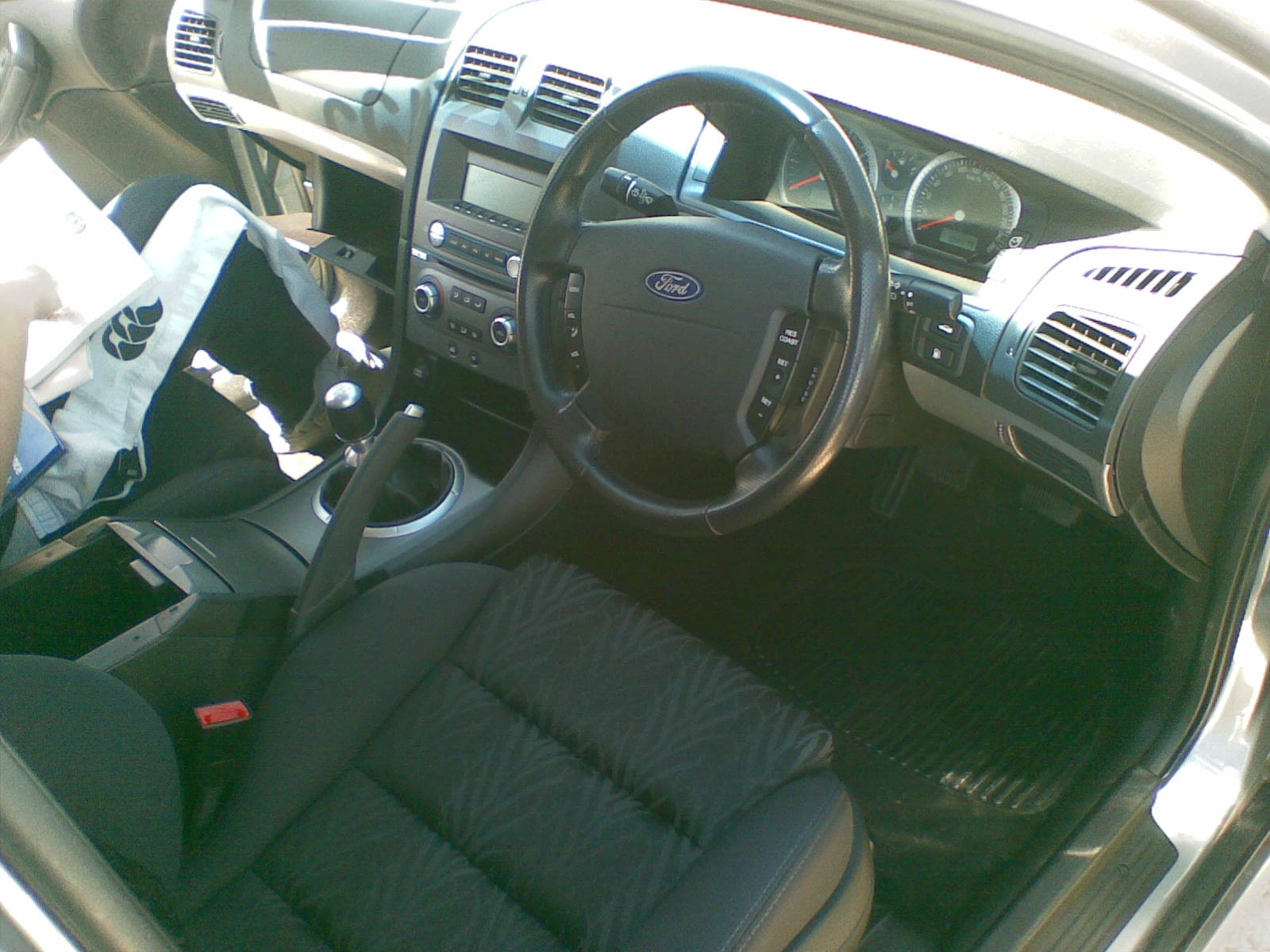

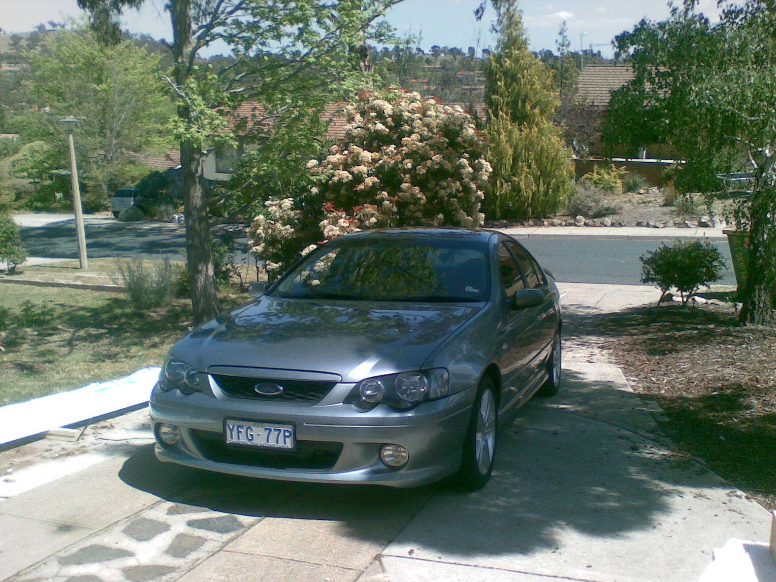

angermagnt Member 57 Member For: 17y 5m 8d Gender: Male Location: Darwin Posted 07/01/08 01:01 AM Author Share Posted 07/01/08 01:01 AM hmmm im only gettin about 365 km a tank.... awell... here are some pics I took of my car... its stock looking aat the moment. Link to comment https://www.fordxr6turbo.com/forum/topic/41436-how-much-boost/#findComment-617897 Share on other sites More sharing options...
