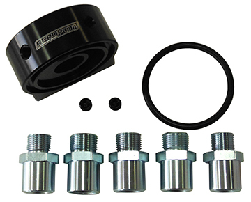

arronm Dropping a turd Gold Donating Members 9,520 Member For: 17y 6m 6d Gender: Male Location: Perth Posted 30/04/18 04:29 AM Share Posted 30/04/18 04:29 AM Glad you sorted it. Most sensors are all the same thread. The sandwich blocks fitted for coolers and sensors have those plugs with fittings. Example... Link to comment https://www.fordxr6turbo.com/forum/topic/41068-boost-sensor/page/3/#findComment-1656517 Share on other sites More sharing options...
