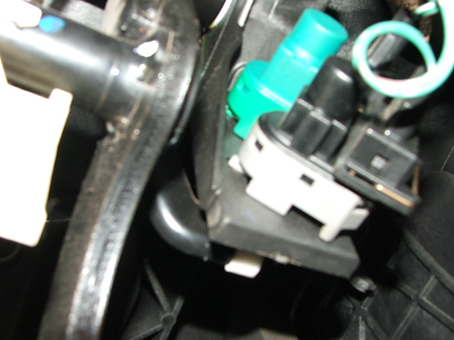

kinggee Member 28 Member For: 22y 5m 17d Gender: Male Location: Townsville, QLD Posted 27/11/07 09:49 AM Share Posted 27/11/07 09:49 AM (edited) Check to see if the light/cruise control switch on the brake pedal has come unclipped. Stick your head down with the pedals and look for the switch that is activated when you press the brake pedal (if your car is a manual there will be one on the clutch pedal as well). The switch turns (like a keyhole lock) to lock into the bracket.This happened to me earlier this year and this is what was wrong with it. Edited 27/11/07 09:57 AM by kinggee Link to comment https://www.fordxr6turbo.com/forum/topic/40149-no-cruise-control-and-no-brake-lights/#findComment-601165 Share on other sites More sharing options...

Jordz xr6 fan Member 44 Member For: 17y 6m 29d Gender: Male Location: Melbourne Posted 27/11/07 12:54 PM Share Posted 27/11/07 12:54 PM My dads ute had a problem with the switch under the brake pedal that stopped the lights from working.We ended up putting some duck tape on the switch and fixed it for the time being.Driving in heavy traffic with a $50,000 boat on the back with no tail lights is risky business.I think it was $50 for a new switch.I have no idea about the cruise control. Link to comment https://www.fordxr6turbo.com/forum/topic/40149-no-cruise-control-and-no-brake-lights/#findComment-601317 Share on other sites More sharing options...
XR_Brute Member 120 Member For: 18y 2m 16d Gender: Male Location: melbourne Posted 28/11/07 07:40 AM Share Posted 28/11/07 07:40 AM reset the switchs, this fixes them 90% of the time, all you need to do is remove both switch, pull the push rods all the way so theyre fully extended, then, with you hand pushing down the pedal, refit both switchs, release the pedal, and theyll click into adjustment, DONT pull up on the pedal, it'll undo your hard work Link to comment https://www.fordxr6turbo.com/forum/topic/40149-no-cruise-control-and-no-brake-lights/#findComment-601552 Share on other sites More sharing options...
