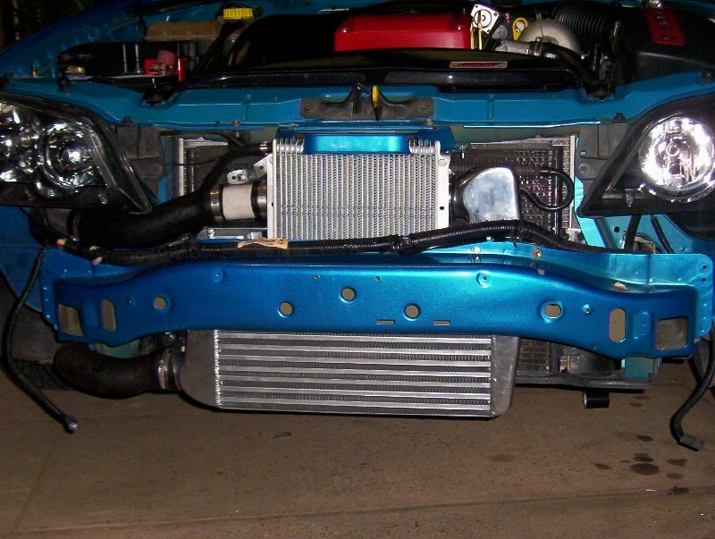

Ralph Wiggum Moar Powar Babeh Lifetime Members 19,332 Member For: 19y 7m 9d Gender: Male Location: Perth Posted 25/10/07 01:06 PM Share Posted 25/10/07 01:06 PM (edited) DAVO61 said: yes i bypassed the radiator so i dont have any water problems . think i might have to think about g/box mod to continue towing the boat.. trans cooler should do the job ??two of those coolers piggybacked would be my preference with a thermo if you have to tow your boat alot. Personally i hate coolers in the front or radiators and intercoolers. Have you seen the cooler package Goldie has on his car? its tucked up at the back of the car. Edited 25/10/07 01:06 PM by hiddeous Link to comment https://www.fordxr6turbo.com/forum/topic/39184-temp-light-flashing/page/2/#findComment-588622 Share on other sites More sharing options...
