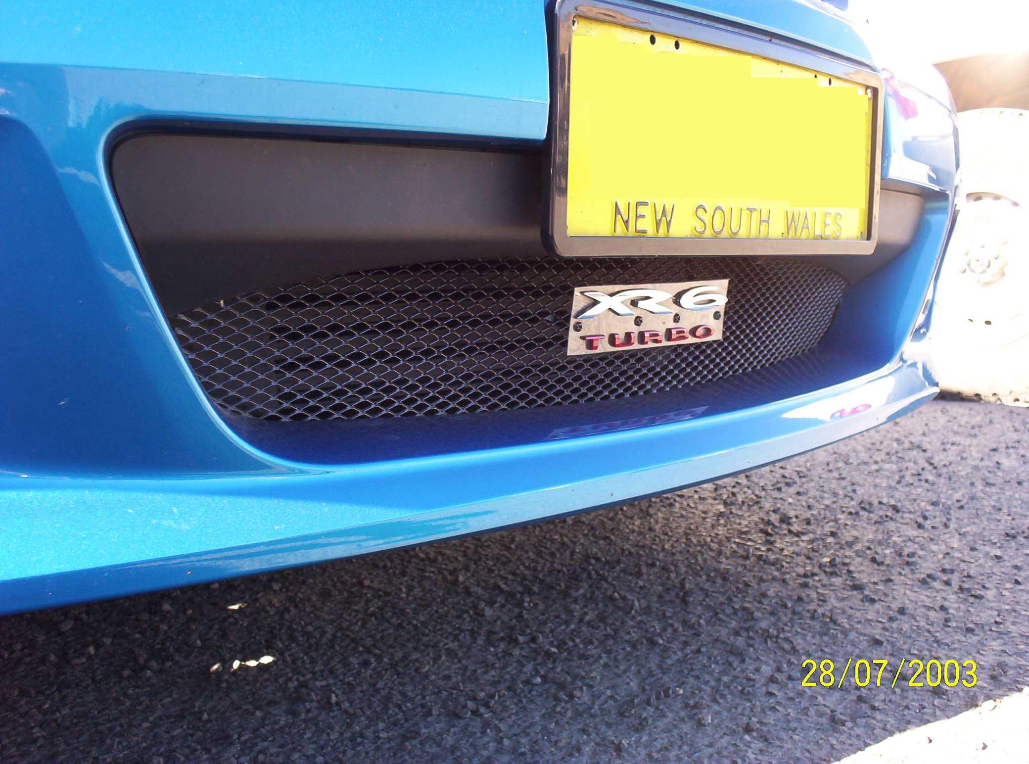

ASNU Member 261 Member For: 22y 3m 6d Location: Brooklyn Posted 12/07/03 10:29 PM Share Posted 12/07/03 10:29 PM Marc.I dont no if you have posted a picture of the mesh you fitted plus badge but would like to see a picture of the front of your car if possible.Craig from ELN said he has done about 6 cars so far so I am sure there is someone on this forum that could supply a picture of there work.I Like the factory look that's not over the top. Link to comment https://www.fordxr6turbo.com/forum/topic/3898-cracked-fog-light/page/4/#findComment-35505 Share on other sites More sharing options...

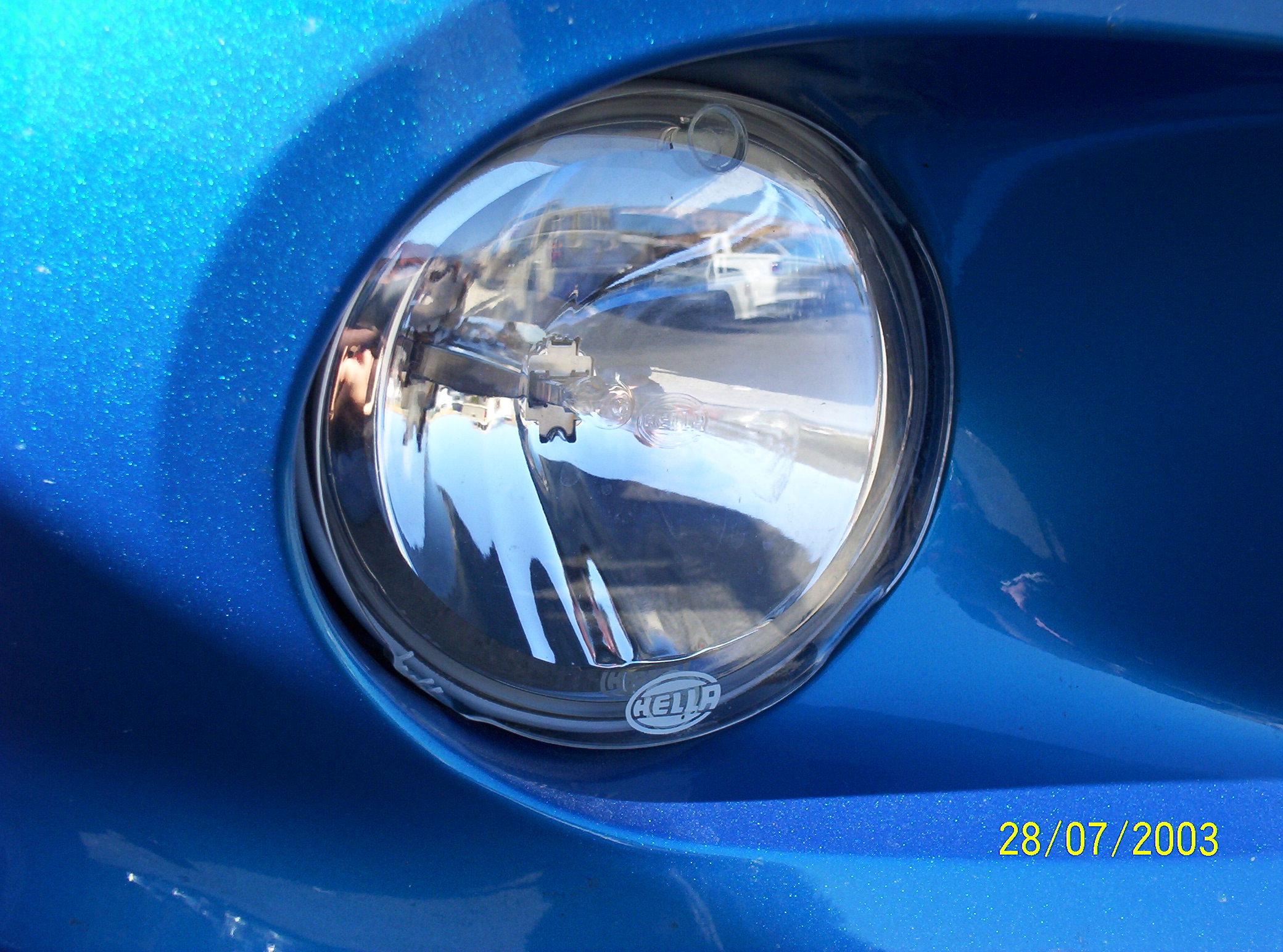

Cashie Donating Members 663 Member For: 22y 3m 5d Gender: Male Location: Perth Posted 20/07/03 03:10 AM Share Posted 20/07/03 03:10 AM I attempted to cut the 3M stick-on light protector material to fit the driving lights today, is there a trick to this?I tried for a couple of hours and couldn't get an acceptable result, can anyone please provide some guidance?I also priced the inserts through Autobarn, would you believe they tried to charge $90+gst? I phoned Repco and they claim they are not a Hella agent anymore, anyone know where I can get these for a fair price?I am going to wire a relay as 56Mainline has done, I had a bit of a look and I think I might mount the relay in the relay/fuse box behind the battery. There is a gap in the rear right hand side that looks big enough for the relay and wiring. Did you look at doing this 56Mainline? Link to comment https://www.fordxr6turbo.com/forum/topic/3898-cracked-fog-light/page/4/#findComment-37473 Share on other sites More sharing options...
sixfan Flaccid Member Donating Members 2,503 Member For: 21y 11m 10d Gender: Male Location: NOONAMAH, go figure..... Posted 20/07/03 03:26 AM Share Posted 20/07/03 03:26 AM I've posted this elsewhere, but.... I noticed both sides of the plastic nosecone had "pooped" out from under the front guards, and I suspect the fog lights are cracking because of the close fit in the nose, it flexes and the lights crack. I didn't have any stone chips on mine and it cracked from the bottom to the top, like it had been squashed. I suspect the protectors may not work and the flexing is the cause of the fractured lights.... Just a thought. Link to comment https://www.fordxr6turbo.com/forum/topic/3898-cracked-fog-light/page/4/#findComment-37478 Share on other sites More sharing options...
Cashie Donating Members 663 Member For: 22y 3m 5d Gender: Male Location: Perth Posted 20/07/03 07:22 AM Share Posted 20/07/03 07:22 AM Whilst I was looking at my lights I noticed a fair amount of pitting in the glass lens, appears to be from gravel/stones etc.I feel the lights are at a bad height for collecting road debris. Link to comment https://www.fordxr6turbo.com/forum/topic/3898-cracked-fog-light/page/4/#findComment-37502 Share on other sites More sharing options...
sixfan Flaccid Member Donating Members 2,503 Member For: 21y 11m 10d Gender: Male Location: NOONAMAH, go figure..... Posted 20/07/03 07:25 AM Share Posted 20/07/03 07:25 AM That makes sense too!I guess time will tell..... Link to comment https://www.fordxr6turbo.com/forum/topic/3898-cracked-fog-light/page/4/#findComment-37503 Share on other sites More sharing options...
