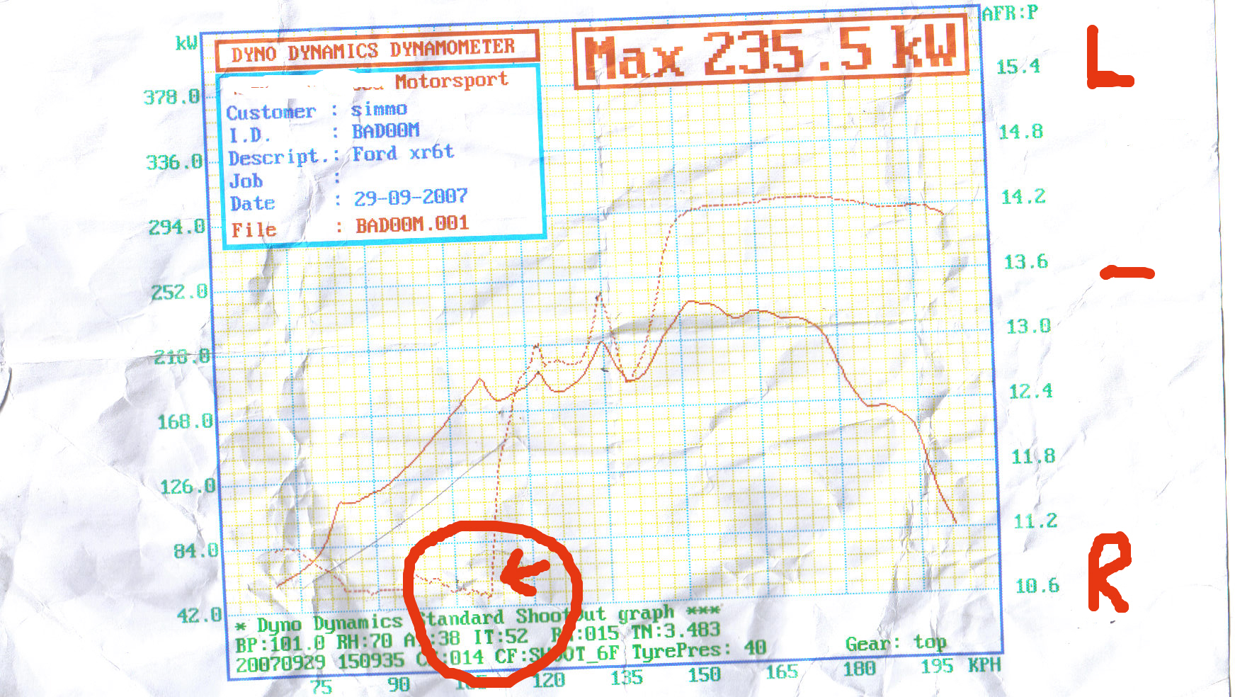

simmo Member 431 Member For: 22y 2m 4d Gender: Male Location: byron bay more underarm hair per square km Posted 06/10/07 04:46 AM Share Posted 06/10/07 04:46 AM ive had an edit for a couple of years now and it has never been right ,the car has constant drivability problems ,I have an I/c , fuel pump ,k+n filter,typhoon intake.I recently installed a high flow fuel pump after a dyno run showed massive lean out which was put down to a crook fuel pump?.since installation performance has slightly improved but again as I upgrade parts a different set of problems occur now the car goes good until 3000rpm then seems to hesitate and chug like its boost spiking,which is alot different to the usual pinging.the car is very well maintained and has new .8 gapped plugs and new fuel filter.I tell you I am coonsidering puttting the car back to standard and getting rid of it.I am constantly hearing of cars going really well edited but so far I am not convinced!! is it an edit or a tuner problem because the car seems to change how it runs quite often too??wtf.anyhelp would be appriciated. Link to comment https://www.fordxr6turbo.com/forum/topic/38845-whats-with-the-edit/ Share on other sites More sharing options...

simmo Member 431 Member For: 22y 2m 4d Gender: Male Location: byron bay more underarm hair per square km Posted 06/10/07 05:16 AM Author Share Posted 06/10/07 05:16 AM heres the last dyno sheet. Link to comment https://www.fordxr6turbo.com/forum/topic/38845-whats-with-the-edit/#findComment-581944 Share on other sites More sharing options...
Dillz Three pedals are better then two.. Donating Members 15,637 Member For: 17y 10m 18d Gender: Male Location: Melbourne Posted 06/10/07 05:28 AM Share Posted 06/10/07 05:28 AM That looks bad Link to comment https://www.fordxr6turbo.com/forum/topic/38845-whats-with-the-edit/#findComment-581946 Share on other sites More sharing options...
shitbmxrider Donating Members 420 Member For: 19y 13d Gender: Male Location: Mill Park, Victoria Posted 06/10/07 05:45 AM Share Posted 06/10/07 05:45 AM id say get a tuner that isnt made of fail. Link to comment https://www.fordxr6turbo.com/forum/topic/38845-whats-with-the-edit/#findComment-581951 Share on other sites More sharing options...
SavageF6 Donating Members 1,622 Member For: 20y 11m 25d Gender: Male Location: Sydney Posted 06/10/07 05:58 AM Share Posted 06/10/07 05:58 AM (edited) They sent you out the door with a dyno graph like that???I'm not sure which is worse - the epileptic power curve, or the AFR line touching on 14.3!Never go back to that shop. Edited 06/10/07 06:08 AM by SavageF6 Link to comment https://www.fordxr6turbo.com/forum/topic/38845-whats-with-the-edit/#findComment-581956 Share on other sites More sharing options...
jetute Donating Members 4,553 Member For: 21y 2m 12d Gender: Male Location: brisbane Posted 06/10/07 08:20 AM Share Posted 06/10/07 08:20 AM what cat have you got?? have you checked to see if its farked???????????????????if the cats farked you just cant make power......... and wanting to make more power usually results in somehting like that.... id be checking your cat and changing your actuator as well.something is a miss, im guessing hardware related.... I saw your car about two years ago... nice ride.... now get the issue diagnosed before you go any furthere.... trying to diagnose over the keyboard is not the way to do it as you will just get a million different ideas. Link to comment https://www.fordxr6turbo.com/forum/topic/38845-whats-with-the-edit/#findComment-581983 Share on other sites More sharing options...
Buf-Phoon loitering with intent Lifetime Members 13,318 Member For: 21y 7m 25d Gender: Male Location: Zombie Birdhouse Posted 06/10/07 09:10 AM Share Posted 06/10/07 09:10 AM They sent you out the door with a dyno graph like that???I'm not sure which is worse - the epileptic power curve, or the AFR line touching on 14.3!Never go back to that shop.What he said. I wouldn't be giving the T too much stick until you get it sorted.That is not a good tune Link to comment https://www.fordxr6turbo.com/forum/topic/38845-whats-with-the-edit/#findComment-581993 Share on other sites More sharing options...
seventytwo Still have a turbo, it's just on a diesel. Lifetime Members 5,368 Member For: 19y 9m 6d Gender: Male Location: The 8th Dimension Posted 06/10/07 10:33 AM Share Posted 06/10/07 10:33 AM That is one of the worst tunes I have ever seen, Do not drive it, That tune will kill your engine, get it to a decent tuner asap. Link to comment https://www.fordxr6turbo.com/forum/topic/38845-whats-with-the-edit/#findComment-582007 Share on other sites More sharing options...
