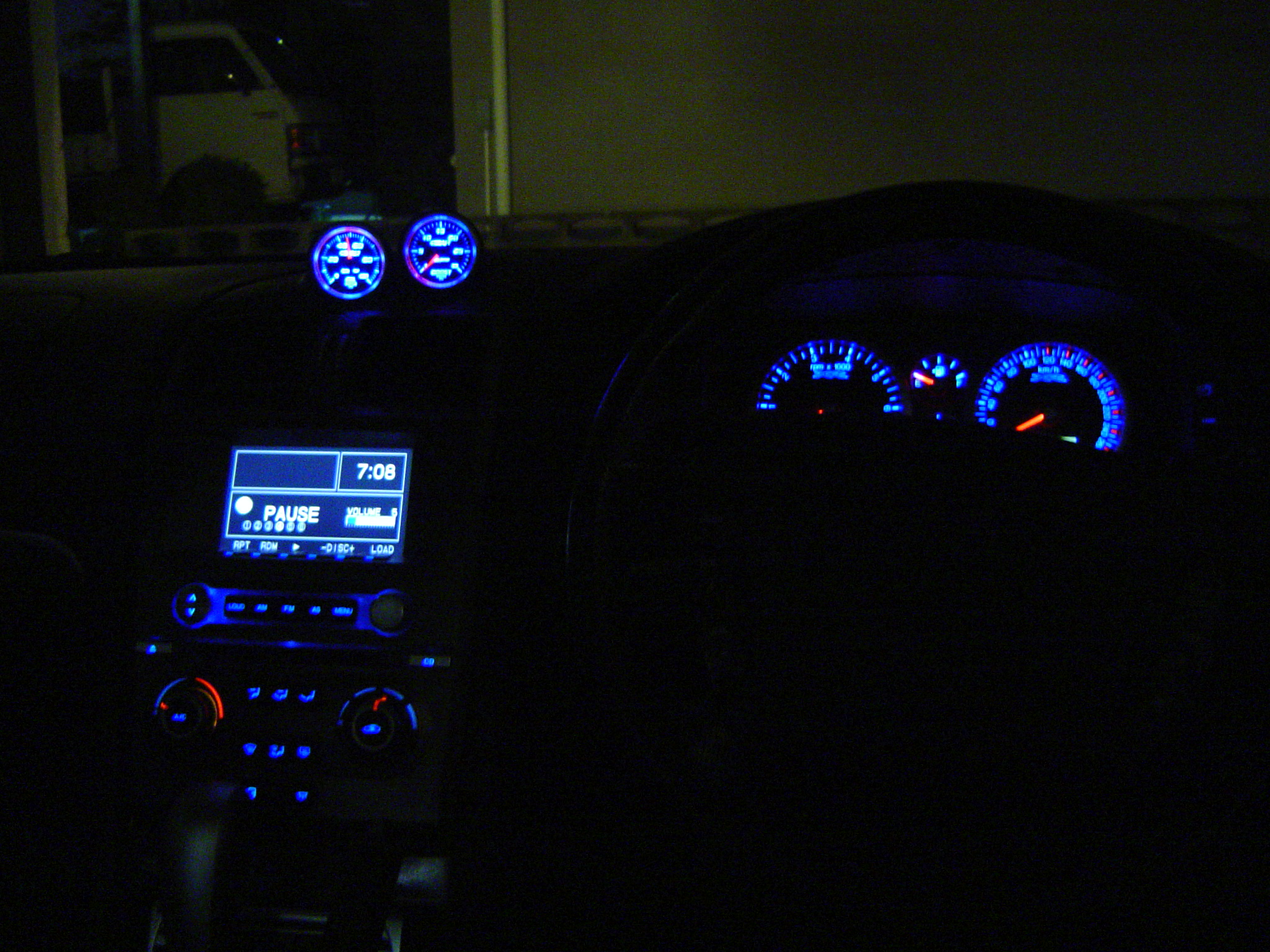

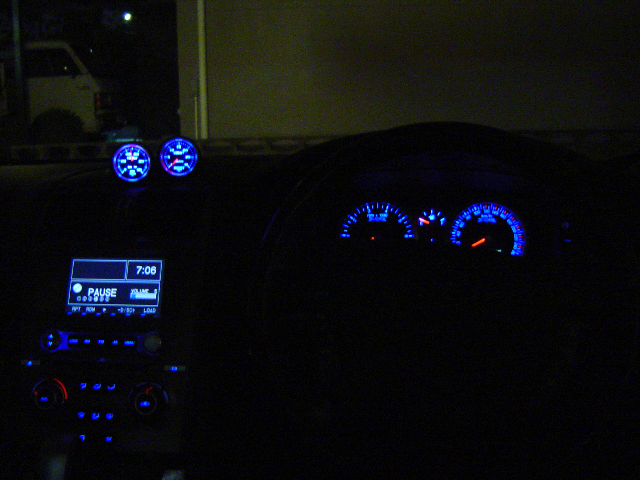

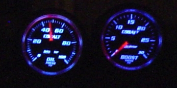

81CJH Member 204 Member For: 19y 5m 20d Gender: Male Location: Brisvegas Posted 25/09/07 09:59 AM Author Share Posted 25/09/07 09:59 AM Sorry about the crap photography, I need a tripod or a better camera... or both.So, there's one of each dimmer setting, and a couple more on max brightness trying to get a good shot of the gauges. Link to comment Share on other sites More sharing options...
XF Falcon <put funny sh*t here> Member 3,365 Member For: 18y 4m Gender: Male Location: Perth, NOR Posted 25/09/07 10:32 AM Share Posted 25/09/07 10:32 AM Well it looks the goods! Nice work mate. I gotta hurry up and order these gauges in! Link to comment Share on other sites More sharing options...
