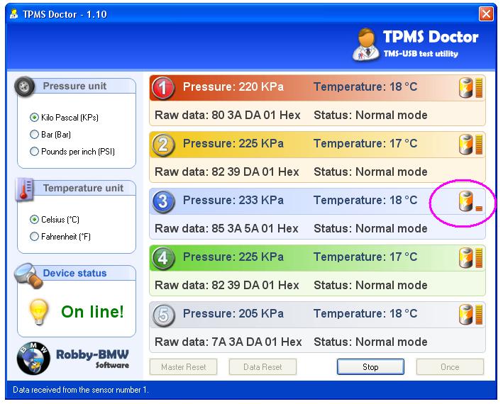

MrBean Member 400 Member For: 18y 11m 12d Location: Melbourne Posted 06/02/08 11:35 AM Author Share Posted 06/02/08 11:35 AM Hello Guys,Just a quick feedback on the TPMS system - I had the pressure transducers fitted, and trained the RF Receiver to the sensors......and guess what?It's alive - yeay.Attached is screenshot of the testprogram the software developer wrote, to wel...err...test the communication, and sensor data.Looking pretty good, sensor 1 = LF, 2=RF, 3=RR, 4=LR and 5=Spare. Temperatures, as well as pressures are spot-on, there's a little bug in the software incorrectly detecting sensor 3's battery status, as the original display shows that as full.Well, we're making good progress here, another guy on Fluxmedia is developing the plugin for CentraFuse, and there is an existing plugin for RoadRunner. This is an excellent musthave for your car, and the way I have now made my unit is to display on the old, original LCD, as well as sending data to the carputer via the USB interface- for comparison.Of course, both methods can be used simultaneously, and permanently, if so desired.I am off to Finland till next Sunday (17th Feb), but will provide more feedback then on progress. I will be departing Friday afternoon.Let me know what you guys think.Kind regards,MrBean Link to comment https://www.fordxr6turbo.com/forum/topic/38483-carputer-project/page/9/#findComment-631124 Share on other sites More sharing options...

tab Sucker Moderating Team 32,303 Member For: 20y 11m 24d Gender: Male Location: Brisbane Posted 08/02/08 11:26 PM Share Posted 08/02/08 11:26 PM (edited) :oohwoah:That thing looks bloody hideous Mr Bean - impressive yet again. You should really run your tyres at the same pressure though! Edited 08/02/08 11:28 PM by tab Link to comment https://www.fordxr6turbo.com/forum/topic/38483-carputer-project/page/9/#findComment-631967 Share on other sites More sharing options...
