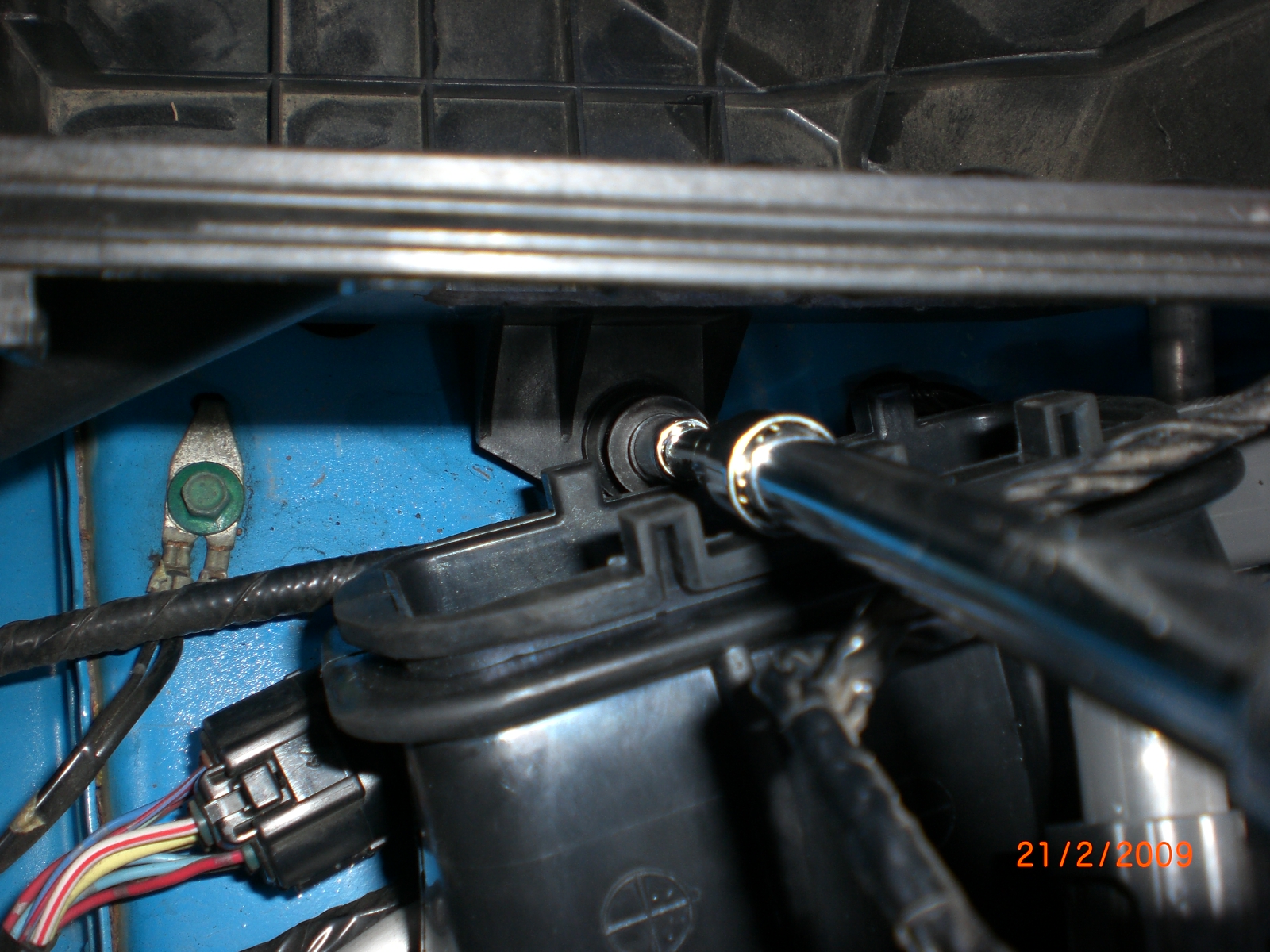

bluey1 Member 68 Member For: 16y 26d Gender: Male Location: Melbourne Posted 22/02/09 03:18 AM Share Posted 22/02/09 03:18 AM intalled it yesterday without a single hassle (also used the dremel) somehow. I was initially quite scared of doing this myself as ive never touched a power tool before, but it was good fun, saved some cash, the car sounds heaps better and fuel economy gets down to ridiculous numbers such as 0.2l /100k on the hills. measurements were great thanks for posting them! only thing I would add is I did this during a mildly windy and dusty day so I covered the top half of the box with a plastic bag to be 100% safe and not let anything through, especially since I thought I might take a while due to my inexperience. third bolt was also no hassle all you gota do is really shove that bottom snorkle as far as you can under the headlight, place the box down and there should be plenty of space. I took some photos ill try upload but ive never uplaoded anything on this site before so not sure how thatll work out...in short, great fun way to save money and improve your cars sound and economy. and with the posted measurements, you cant go wrong! Link to comment Share on other sites More sharing options...
bluey1 Member 68 Member For: 16y 26d Gender: Male Location: Melbourne Posted 22/02/09 03:29 AM Share Posted 22/02/09 03:29 AM these were the only ones I could upload as I forgot to turn the quality down for the other ones and theyre too big to upload. Link to comment Share on other sites More sharing options...
