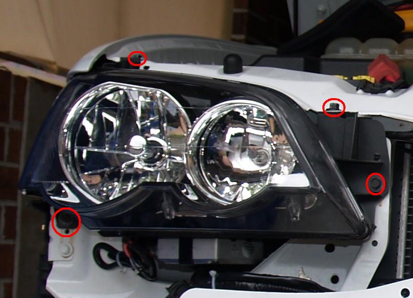

Ford Grunt Member 159 Member For: 22y 4m 5d Location: Newcastle Posted 10/08/07 08:21 AM Share Posted 10/08/07 08:21 AM Hey,Just after a little help. I am trying to remove a headlamp (battery side) and while I think I have removed all the bolts (two top near guard, one on top near grill assemby and one behind front bar on RHS) it still seems to stuck around where the indicators are in the headlight assemby. Trying pushing from behind and it still wont come. Any suggestions, by someone who has removed them before?Cheers,Ben. Link to comment https://www.fordxr6turbo.com/forum/topic/37368-headlamp-removal/ Share on other sites More sharing options...
aussieturtle Member 39 Member For: 17y 10m 21d Gender: Male Location: Sydney Area Posted 10/08/07 05:07 PM Share Posted 10/08/07 05:07 PM Hi Ben,If you have the bumper and the shock absorber(white plastic bumper support) off the lamp assy should come out with the bolts removed. I found that I had to have all the plugs disconnected as well as the indicator wire was a little tight.Hope this helps.Tom Link to comment https://www.fordxr6turbo.com/forum/topic/37368-headlamp-removal/#findComment-563279 Share on other sites More sharing options...

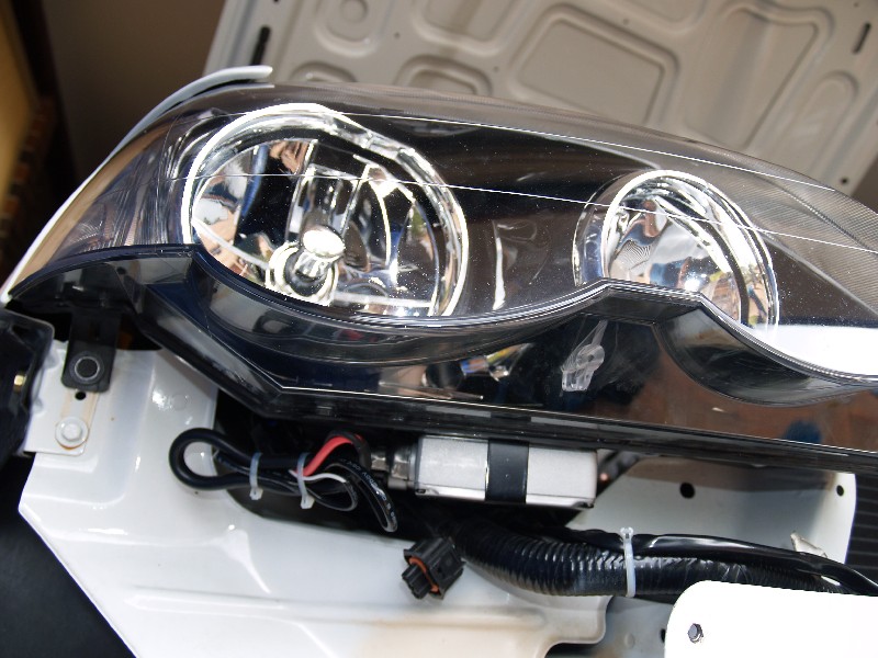

XF Falcon <put funny sh*t here> Member 3,365 Member For: 18y 7m 2d Gender: Male Location: Perth, NOR Posted 10/08/07 05:41 PM Share Posted 10/08/07 05:41 PM nice pics.silly question, but how the hell do we get to the front indicators if one was to blow? im guessing we have to take off that plastic inner guard lining to get to behind the headlight unit? Link to comment https://www.fordxr6turbo.com/forum/topic/37368-headlamp-removal/#findComment-563287 Share on other sites More sharing options...
hanra Into the laaaake Member 1,532 Member For: 17y 11m 27d Gender: Male Location: Nrth Qld Posted 10/08/07 11:19 PM Share Posted 10/08/07 11:19 PM Yep u certainly do, but that's only quick. Just undo the inner guard, reach up to the bottom of the headlight, twist the entire body of the indicator bulb assy to remove the bulb from the headlight, provided u have undone the 3 plugs on the headlight and the 4 bolts holding the headlight in. Then it will just fall out. Easy!!!! Link to comment https://www.fordxr6turbo.com/forum/topic/37368-headlamp-removal/#findComment-563316 Share on other sites More sharing options...
