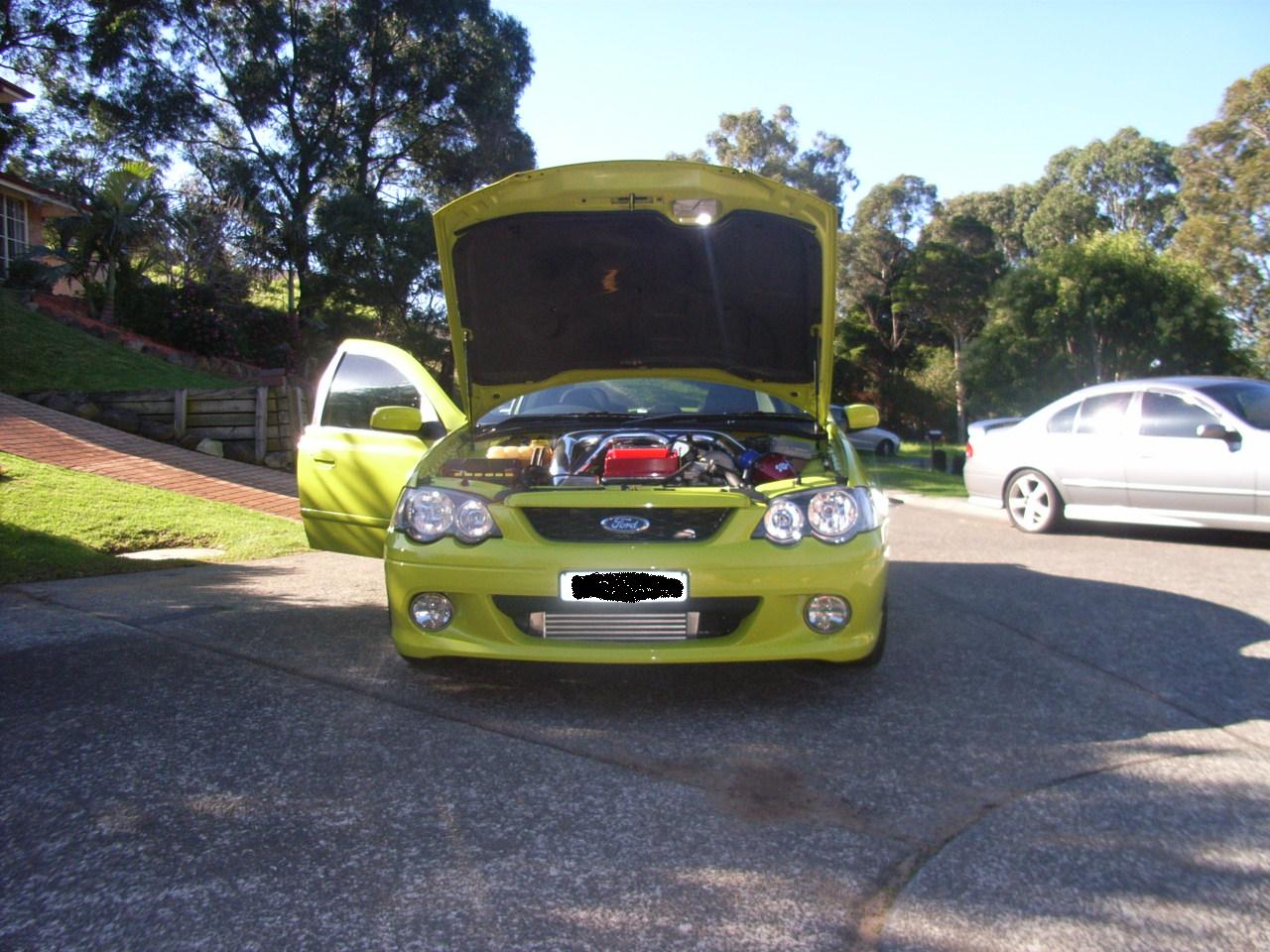

TornadoJudd Donating Members 818 Member For: 19y 22d Posted 16/07/07 12:43 AM Share Posted 16/07/07 12:43 AM this is what one looks like installed Link to comment Share on other sites More sharing options...

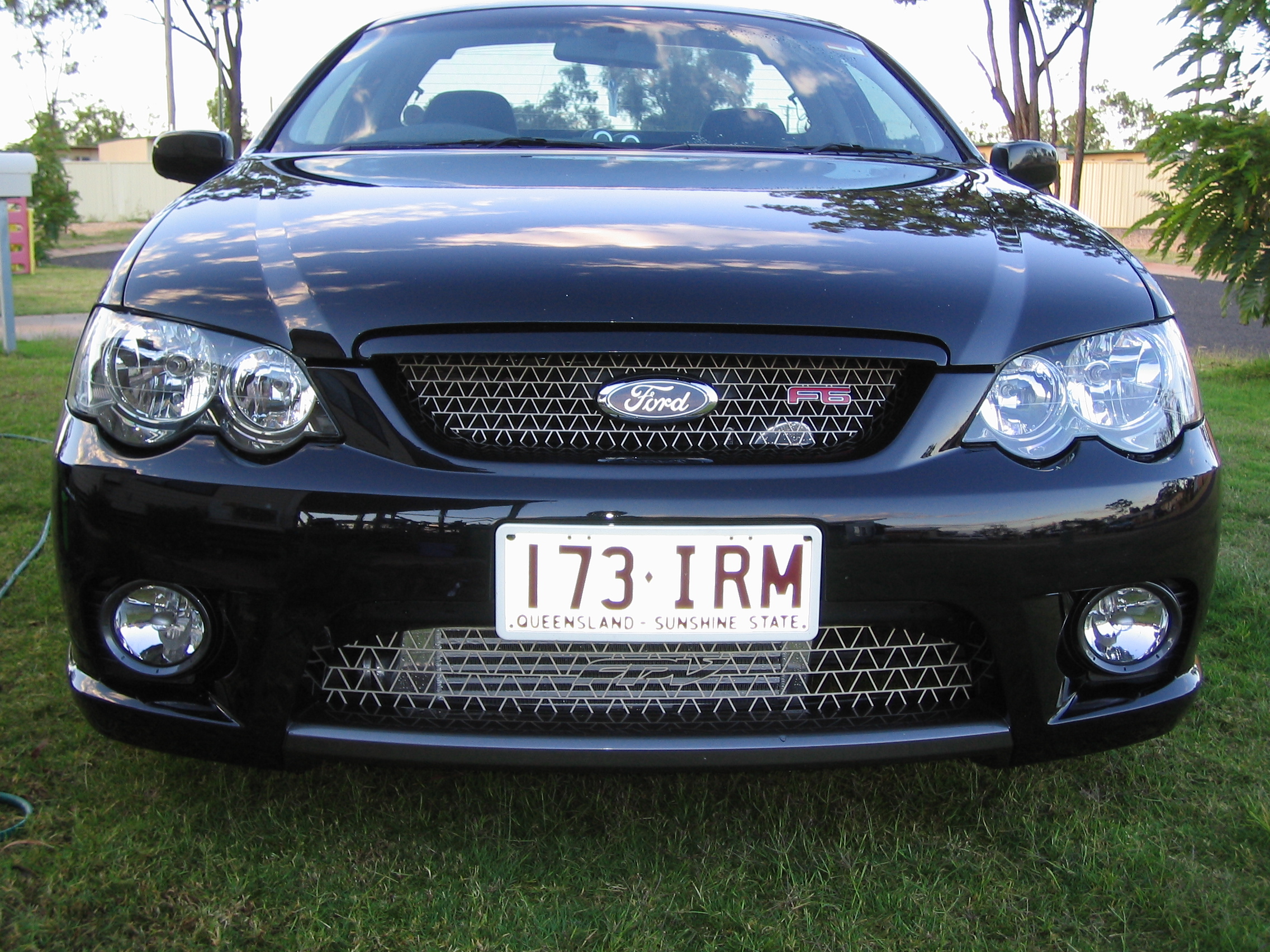

rhys86 Donating Members 443 Member For: 18y 2m 7d Gender: Male Location: Wollongong Posted 16/07/07 02:49 AM Share Posted 16/07/07 02:49 AM This is mine. Link to comment Share on other sites More sharing options...
