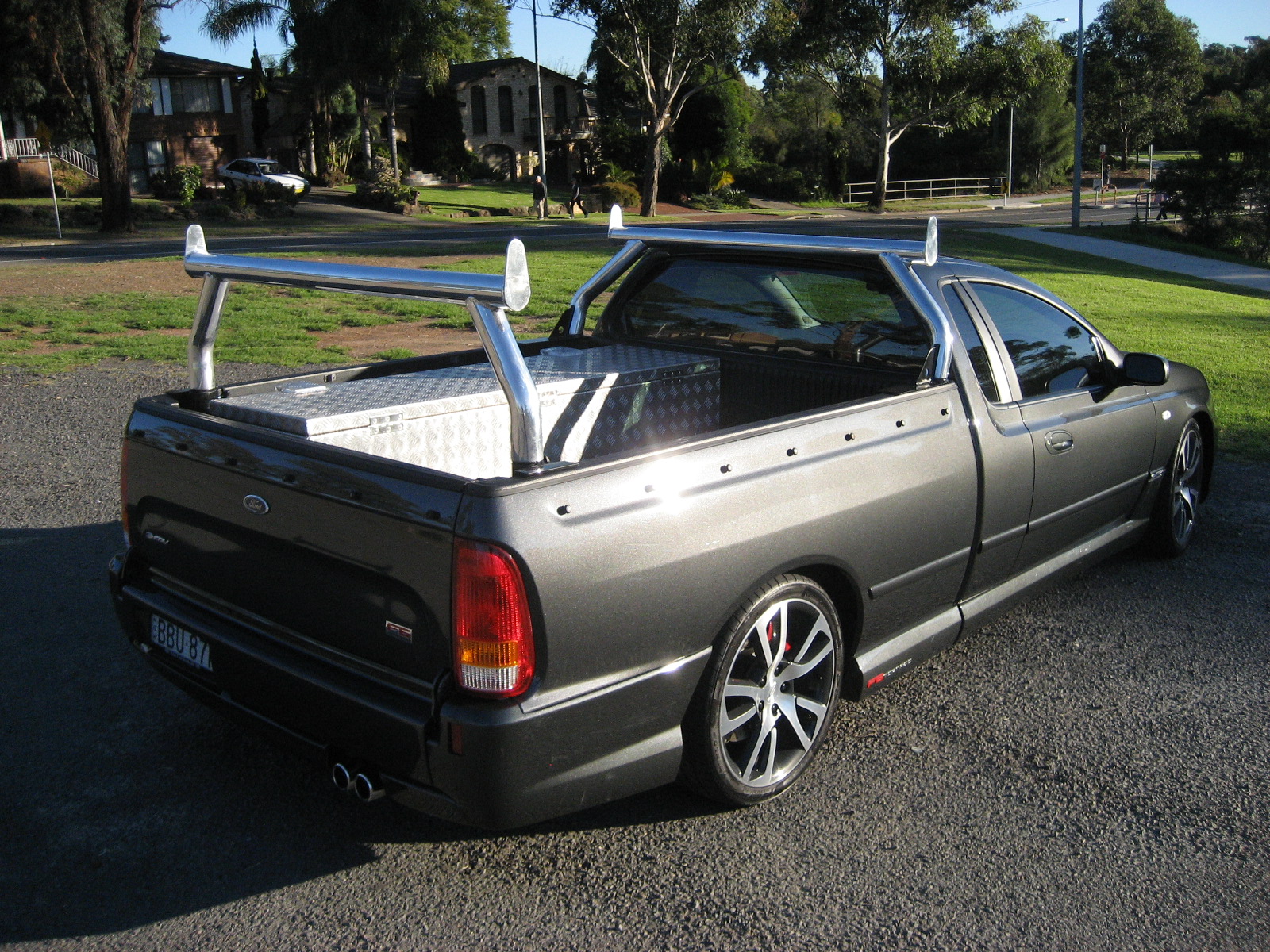

XR_Jet Member 69 Member For: 19y 12d Location: South of the Border Posted 06/07/07 08:16 AM Share Posted 06/07/07 08:16 AM (edited) Hi Guys,Just sold my Turbo sedan and now have a 05 XR8 ute, mainly for work purposes.I brought a big toolbox that goes accross the back of my ute right near the tailgate for easy access. It sits about 10mm under my hard lid.Anyway I was looking at the tub floor and it appears that there is no metal backing under the rather thin plastic tray. I was going to bolt it down but dont think it will be strong enough to hold the weight of the box and stop it slipping around.I also need to do this so I can remove the toolbox every so often for holidays etc. This is why I was thinking bolts as they are easily undone.Any help would be appreciated.Rgds,Jet. Edited 06/07/07 08:18 AM by XR_Jet Link to comment https://www.fordxr6turbo.com/forum/topic/36442-tool-box-in-tub-liner/ Share on other sites More sharing options...
turtle33 Member 578 Member For: 20y 1m 24d Gender: Male Location: brisbane Posted 06/07/07 08:44 AM Share Posted 06/07/07 08:44 AM I used 8mm turn buckles to the tie down point but depending on the width of the box, it may not work Link to comment https://www.fordxr6turbo.com/forum/topic/36442-tool-box-in-tub-liner/#findComment-552438 Share on other sites More sharing options...
MRAH33 Member 34 Member For: 17y 11m 9d Gender: Male Location: MElbourne Posted 06/07/07 09:28 AM Share Posted 06/07/07 09:28 AM I have a big toolbox in my ute as well and I use those tie down rachet things to hold it in place...1 around the back and 1 around the front doesnt move an inch. Link to comment https://www.fordxr6turbo.com/forum/topic/36442-tool-box-in-tub-liner/#findComment-552464 Share on other sites More sharing options...
tab Sucker Moderating Team 32,303 Member For: 20y 11m 22d Gender: Male Location: Brisbane Posted 07/07/07 12:38 AM Share Posted 07/07/07 12:38 AM Why not just some rubber matting given you don't need to secure it? I got some magic stop or something from Clarke Rubber, and nothing slides on that sh*t. Link to comment https://www.fordxr6turbo.com/forum/topic/36442-tool-box-in-tub-liner/#findComment-552607 Share on other sites More sharing options...
groper Member 611 Member For: 18y 2m 15d Posted 07/07/07 12:52 AM Share Posted 07/07/07 12:52 AM (edited) yep, put down rubber first, do the whole tray as it stops EVERYTHING else in there from sliding around aswell, and then use chains with padlocks or turnbuckles etc from the handles on the side of the tool box to the tie down points, it wont move... and yes, ive had the tub liner out, the sheet metal underneath is VERY thin, 1.2-1.6mm. Edited 07/07/07 12:55 AM by groper Link to comment https://www.fordxr6turbo.com/forum/topic/36442-tool-box-in-tub-liner/#findComment-552609 Share on other sites More sharing options...
XR_Jet Member 69 Member For: 19y 12d Location: South of the Border Posted 07/07/07 07:59 AM Author Share Posted 07/07/07 07:59 AM Yeah, I already have some slip proof rubber I brought from clark rubbey last week, it works but I dont think that will do the job alone.I tried tiedowns from the handles of the toolbox to the tie down points (this is along the backside near the tailgate). It stops 80% of movement, but it still moves a bit. When I tighten the tiedowns to stop the movement it lifts the toolbox up so my toolbox hits against the hardlid as the toolbox's handles are lower than the tie down points, which are right at the top of the tubliner (seems a stupid place to put them)I dont know, anyone tried rivets or something similar?Jet Link to comment https://www.fordxr6turbo.com/forum/topic/36442-tool-box-in-tub-liner/#findComment-552703 Share on other sites More sharing options...
XR_Jet Member 69 Member For: 19y 12d Location: South of the Border Posted 08/07/07 02:29 AM Author Share Posted 08/07/07 02:29 AM Just had an idea.Im thinking magnets. If I can get some really strong magnets, put two or so of them under the metal backing and put the opposites in the bottom of the toolbox, the magnets should be able to penetrate through the plastic tubliner and still have a strong attraction to eachother.Ill let you know how I go.any critism is welcome.Jet Link to comment https://www.fordxr6turbo.com/forum/topic/36442-tool-box-in-tub-liner/#findComment-552933 Share on other sites More sharing options...
Craig. Member 563 Member For: 18y 27d Gender: Male Location: Sunshine Coast QLD Posted 08/07/07 08:07 AM Share Posted 08/07/07 08:07 AM You could also use some timber to section of the floor of the tub. There are sections of the plastic liner that have been moulded to take timber pieces and instructions on how to do it and the dimensions and length of timber to do it in the owners manual. This, when combined with the rubber matting would stop the box from moving all the way forward in an emergency stop. Link to comment https://www.fordxr6turbo.com/forum/topic/36442-tool-box-in-tub-liner/#findComment-553019 Share on other sites More sharing options...
NATHOON Donating Members 197 Member For: 18y 8m 28d Gender: Male Location: Sydney Posted 08/07/07 11:33 AM Share Posted 08/07/07 11:33 AM XR_Jet said: Just had an idea.Im thinking magnets. If I can get some really strong magnets, put two or so of them under the metal backing and put the opposites in the bottom of the toolbox, the magnets should be able to penetrate through the plastic tubliner and still have a strong attraction to eachother.Ill let you know how I go.any critism is welcome.JetI have two utes with tool boxes and I screw it down to the steel sections using the bolts that hold the old factory tie downs with.( they both have trade racks) they do not move an inch. Pilot drill the holes then screw. Make sure you set the depth of the drill. Link to comment https://www.fordxr6turbo.com/forum/topic/36442-tool-box-in-tub-liner/#findComment-553103 Share on other sites More sharing options...
