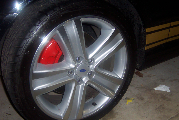

seventytwo Still have a turbo, it's just on a diesel. Lifetime Members 5,368 Member For: 19y 9m 10d Gender: Male Location: The 8th Dimension Posted 01/07/07 02:39 AM Share Posted 01/07/07 02:39 AM Looks like you did a great job, How did you do the FPR bit Link to comment https://www.fordxr6turbo.com/forum/topic/36224-painting-brake-calipers/page/2/#findComment-550400 Share on other sites More sharing options...
neoppg Member 89 Member For: 17y 10m 17d Location: brisbane Posted 01/07/07 03:39 AM Share Posted 01/07/07 03:39 AM good job,when we did mine we took 1 of the 2 bolts that hold the caliper in place and pullled it up to one side wich made it easier to mask up. also removed the pads so the end result looks a bit more tidy (leaving the pads black) Link to comment https://www.fordxr6turbo.com/forum/topic/36224-painting-brake-calipers/page/2/#findComment-550423 Share on other sites More sharing options...
billsxr6t Member 10 Member For: 18y 2m 17d Location: Perth (morley) Posted 01/07/07 04:11 AM Author Share Posted 01/07/07 04:11 AM yeh kinda wished I had removed the pads but new ones will go in soon along with some new slotted rotors.first I paitned the cailpers 3 coats I think it was used heat gun to dry it off then found had an fpr tag off of a jacket which has the logo cut out which was near the perfect size to fit the cailiper just masked it on and sprayed over it in white then pulled it all off..... Link to comment https://www.fordxr6turbo.com/forum/topic/36224-painting-brake-calipers/page/2/#findComment-550431 Share on other sites More sharing options...
