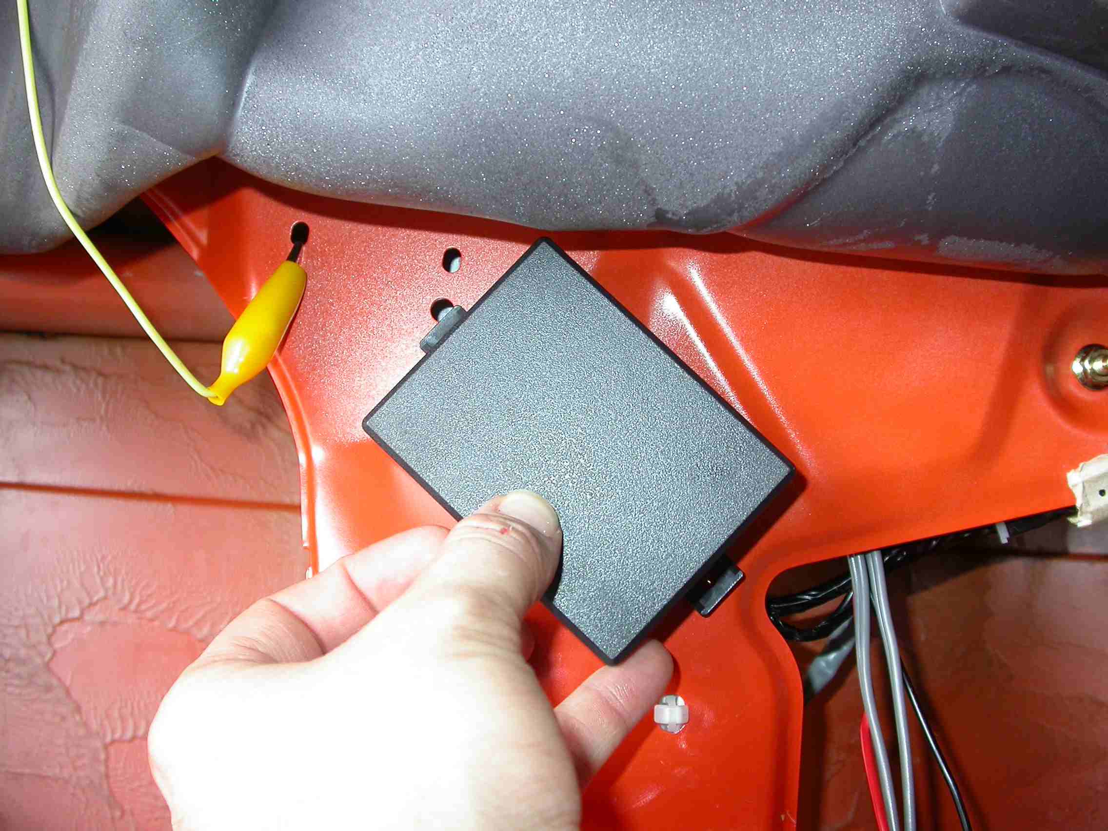

gragraaa Member 21 Member For: 18y 7m 19d Gender: Male Location: mackay Posted 05/02/08 01:25 PM Share Posted 05/02/08 01:25 PM the wiring was easy, however the power in the door was tricky,I found 2 power 2 use, the one that goes dead when ignition is off is no good, asafter 30 min, the computer senses a drain and unlocks the car for some reason, I didnt notice for around 3 months ! but now perfect. all the wiring is in drivers door for all windows , not sure of the part number, but if you go into your local jaycar and ask for the kit they should have.the trimpot required must be changed as the motors on the windows require more drain than older styles, so the unit keeps thinking the window is up.I think from memory I used a 1.5k ohm trimpotwhich was the next resistance up from the one they had.PS: this mod is not for everyone and you need to know a little about soldering and electrical before you have your door wires.hope this helps guys Link to comment https://www.fordxr6turbo.com/forum/topic/3586-automatic-windows-on-all-4-windows/page/3/#findComment-630742 Share on other sites More sharing options...

Ralph Wiggum Moar Powar Babeh Lifetime Members 19,332 Member For: 19y 7m 8d Gender: Male Location: Perth Posted 28/04/16 05:47 AM Share Posted 28/04/16 05:47 AM I've been using on of these modules for quite a while. Works for closing only. It's triggered by either locking the car with the remote or pressing the central locking button in the ICC. http://www.rapidelectronics.com.au/products/4-door-window-lift.html Vid- They aren't water proof though, so if you plan to mount in the door seal it first or do as I did and seal it up in a plastic bag. 1 Link to comment https://www.fordxr6turbo.com/forum/topic/3586-automatic-windows-on-all-4-windows/page/3/#findComment-1587881 Share on other sites More sharing options...
