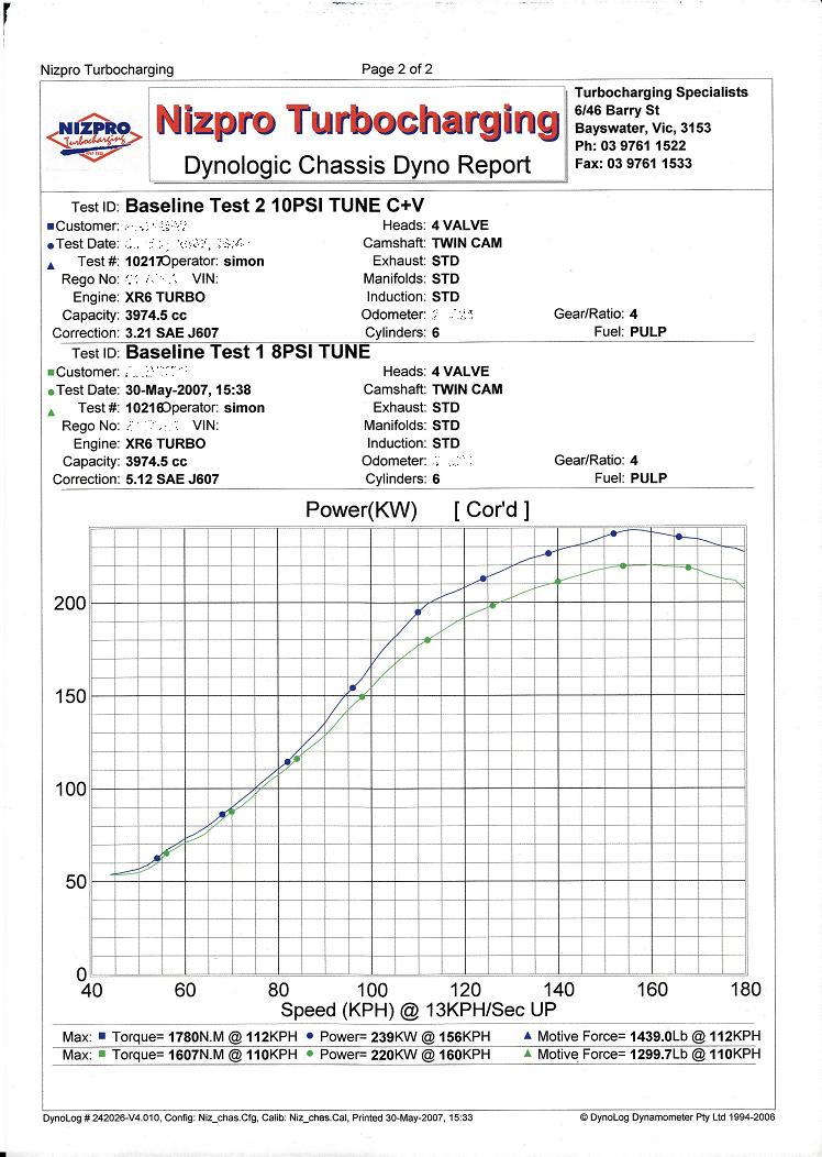

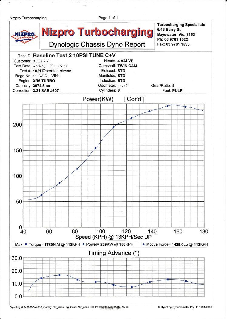

SCRIBR Yaris member Member 4,486 Member For: 18y 10m 25d Gender: Male Posted 31/05/07 08:13 AM Author Share Posted 31/05/07 08:13 AM Timing, boost, lambda... all over the place... lucky its booked in soon(ish) im running the 8psi... which u can see in the 3rd graph.. I can post up the info on that 1 if people want. Link to comment https://www.fordxr6turbo.com/forum/topic/35434-what-mods-do-i-need/page/2/#findComment-539156 Share on other sites More sharing options...
Fat-Tony Member 5,364 Member For: 19y 1m 25d Posted 31/05/07 08:27 AM Share Posted 31/05/07 08:27 AM Dude its actually not that bad for a generic tune, AFR's are kept in the safe range, the boost is tapered down as you see to be able to work around the stock injectors, timing could do with a bit more work, but its a generic tune. Link to comment https://www.fordxr6turbo.com/forum/topic/35434-what-mods-do-i-need/page/2/#findComment-539168 Share on other sites More sharing options...
groper Member 611 Member For: 18y 3m 15d Posted 31/05/07 09:34 AM Share Posted 31/05/07 09:34 AM well you already got the injectors on the way, the pump is good for up to 330rwkw as some have proven, so that's fuel sorted... if ya do the intercooler youll get safer power, go for the best you can afford, and you might aswell get a new CAT as they dont cost much, before you go get that nispro tune! Link to comment https://www.fordxr6turbo.com/forum/topic/35434-what-mods-do-i-need/page/2/#findComment-539200 Share on other sites More sharing options...
