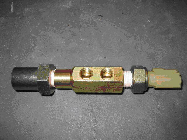

Adrian6T T.P.I.S. Donating Members 2,578 Member For: 20y 6m 2d Gender: Male Location: SoR, WA Posted 22/05/07 08:01 AM Share Posted 22/05/07 08:01 AM As we speak one of our works machine shops is pricing up for me a custom fitting to allow 2 1/8 NPT fittings to be fitted to the block where the factory sender is.It will be made from a piece of brass hex rod. One end will be Male 1/4BSP and the other Female 1/4 BSP. Between them on one face will be 2 off 1/8 NPT females for both my Electric Oil Pressure and Electric Oil Temp gauges.When I get a price ill post it up. I know it wont be too cheap as it is a one off. Link to comment https://www.fordxr6turbo.com/forum/topic/35212-oil-temp-sender-to-sump-plug/#findComment-535701 Share on other sites More sharing options...

Adrian6T T.P.I.S. Donating Members 2,578 Member For: 20y 6m 2d Gender: Male Location: SoR, WA Posted 22/05/07 12:46 PM Share Posted 22/05/07 12:46 PM Here is a quick photo chop of what I am getting made.CheersAdrian Link to comment https://www.fordxr6turbo.com/forum/topic/35212-oil-temp-sender-to-sump-plug/#findComment-535928 Share on other sites More sharing options...
benjam Member 137 Member For: 20y 2m 1d Location: Sydney NSW Posted 22/05/07 01:37 PM Author Share Posted 22/05/07 01:37 PM (edited) Thanks for the replies guys.Wish I was back in high school metalwork class, oh the projects I could have done by now! Russ that setup looks like what I need, glad it can be done. Adrian, how's the depth for the 1/8" threads compared with the length of your oil temp sender? I have an autometer sender and it is too long or the brass hex rod of the current t-piece is not big enough in diameter. Looks good the pic you made up, please post a pic of the real thing! Cheers.Ben Edited 22/05/07 01:38 PM by benjam Link to comment https://www.fordxr6turbo.com/forum/topic/35212-oil-temp-sender-to-sump-plug/#findComment-535950 Share on other sites More sharing options...
Adrian6T T.P.I.S. Donating Members 2,578 Member For: 20y 6m 2d Gender: Male Location: SoR, WA Posted 22/05/07 02:16 PM Share Posted 22/05/07 02:16 PM Thanks for the replies guys.Wish I was back in high school metalwork class, oh the projects I could have done by now! Russ that setup looks like what I need, glad it can be done. Adrian, how's the depth for the 1/8" threads compared with the length of your oil temp sender? I have an autometer sender and it is too long or the brass hex rod of the current t-piece is not big enough in diameter. Looks good the pic you made up, please post a pic of the real thing! Cheers.BenBenI have to wait for a couple of weeks for my gauges to arrive and then I will be taking the two electronic senders to the machine shop to get fitted up so they are spot on.I'll re-visit this thread in a couple of weeks with pics.CheersAdrian Link to comment https://www.fordxr6turbo.com/forum/topic/35212-oil-temp-sender-to-sump-plug/#findComment-535957 Share on other sites More sharing options...
