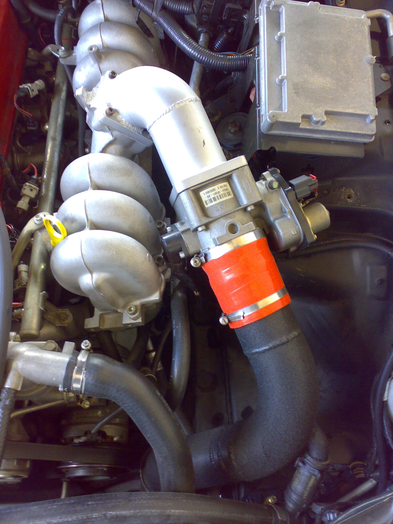

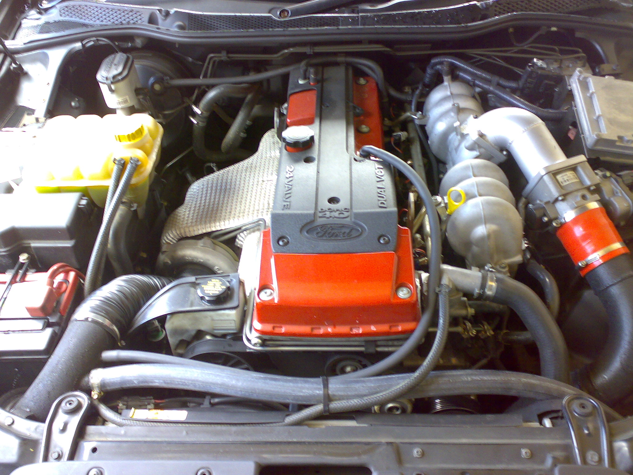

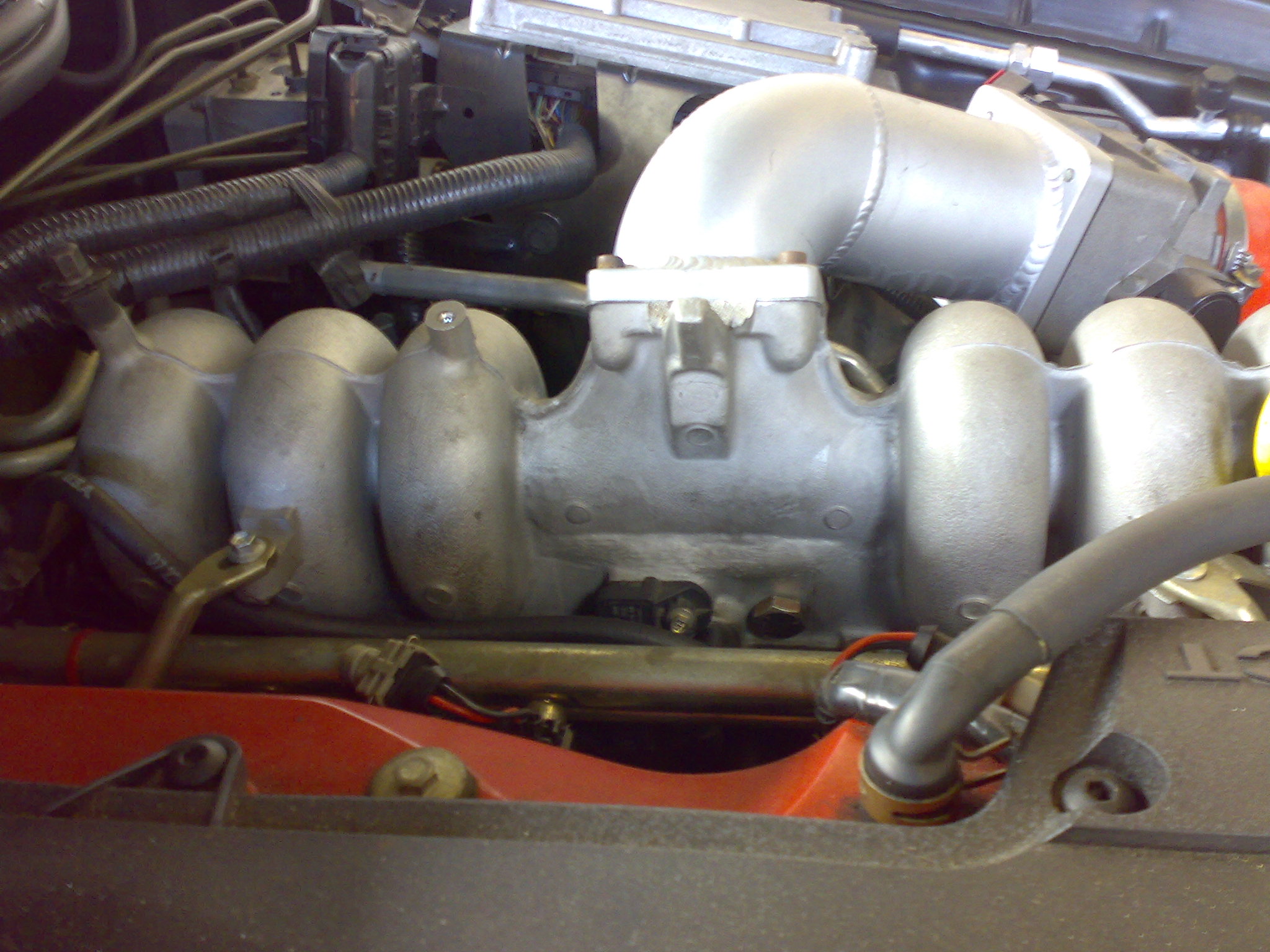

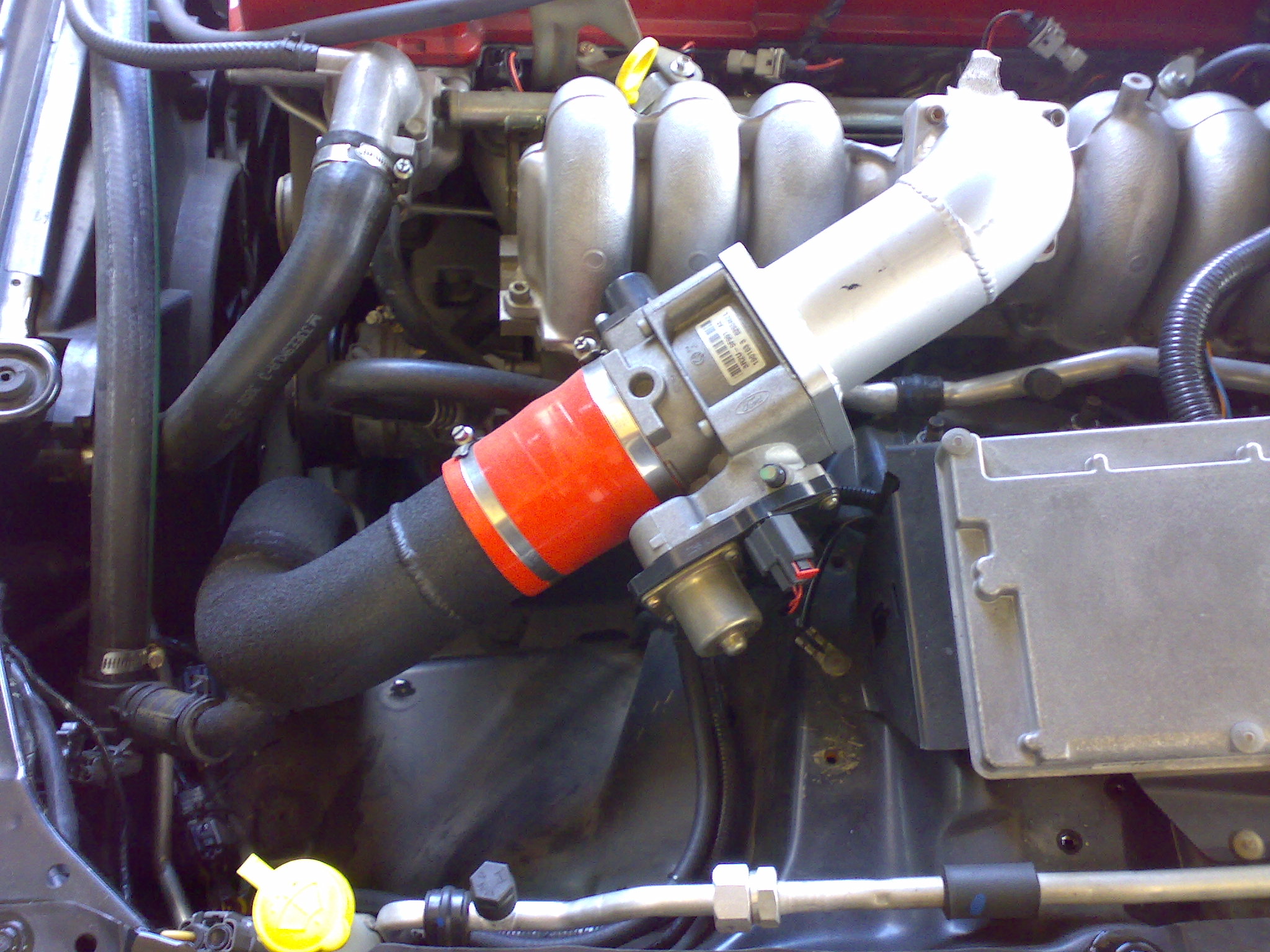

exahsix Member 296 Member For: 19y 4m 23d Location: Monterey, NSW Posted 18/03/07 04:28 AM Share Posted 18/03/07 04:28 AM Close....but no cigar. EXAHSIX...he he heSee attachments for the best plenum modification ever, notice the cylinders still get filled evenlycheers Link to comment Share on other sites More sharing options...
