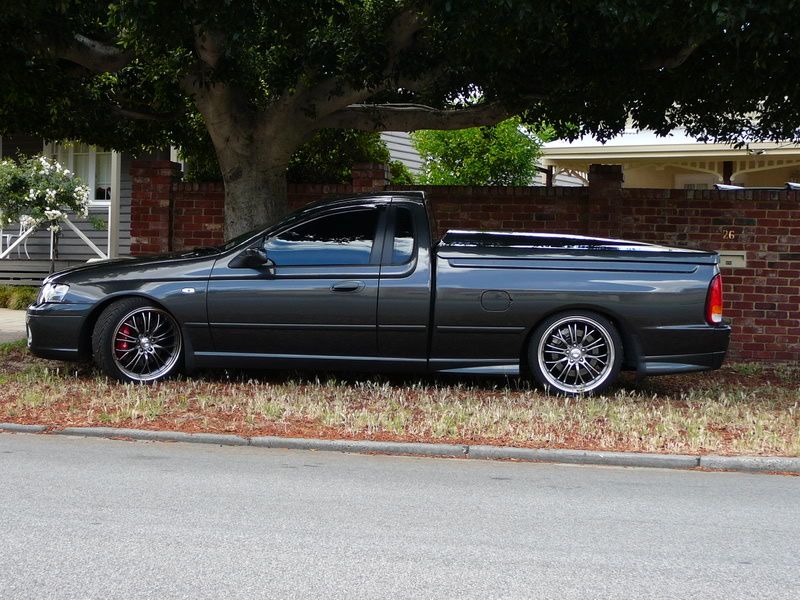

quigebo Member 134 Member For: 19y 10d Location: blue planet Posted 08/03/07 02:03 AM Share Posted 08/03/07 02:03 AM (edited) hiddeous said: check this out mate:http://www.fordxr6turbo.com/forum/index.ph...topic=31726&hl=Personally I dont like pedders an feel there gear is over priced. that's purely my opinion.I got the front srings changed. Koni reds all round and the rear adjusted so the ute is 15mm lower at the front and 20mm at the rear. I also have a 30mm front sway bar and a 21mm rear bay. My car hands like a go kart now. I rear bar may not be to everybodys tastes though as I does add a bit of oversteer.Lemme know if you would like to take it for a spin to compare it to Rus's ute. Luke←is that thing even lowered? I had ian at wilko's fit the konis all round, kings ssl, reset rears as I dont use it as a ute and a front 30mm bar.. its probably too low now its settled but it looks dam fine.. simon(xtreme) has now changed my dyno printouts and account name to daves stupidest lowest ute ever wont even go up his new workshop driveway without scraping the exhaust.. if I can make time and come up for the sunday night cruise hopefully I will get over the speedhumps in kings park! Edited 08/03/07 02:06 AM by quigebo Link to comment https://www.fordxr6turbo.com/forum/topic/32733-suspension-and-handling/page/2/#findComment-505427 Share on other sites More sharing options...
