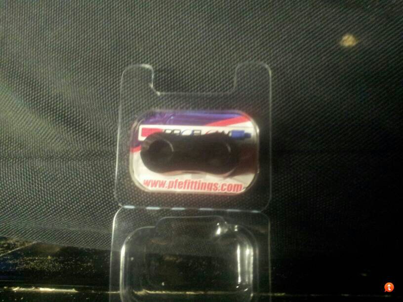

FiftyOne Bronze Donating Members 1,145 Member For: 11y 11m 28d Gender: Male Posted 07/03/15 12:17 PM Share Posted 07/03/15 12:17 PM Been looking around for a thread that was started a little while back re the earls filter. Someone used some aeroflow fittings & P clamps to mount the filter to the front of the block instead of the side. It had a list of the bits he used. Can anyone point me in the right direction? Link to comment https://www.fordxr6turbo.com/forum/topic/32461-turbo-oil-supply-screen-cleaning/page/44/#findComment-1533686 Share on other sites More sharing options...
bamk2f6tornado Bronze Donating Members 777 Member For: 11y 6m 26d Gender: Male Location: Rockhampton Qld Posted 07/03/15 12:43 PM Share Posted 07/03/15 12:43 PM These clamps? About 3-4$ from Pirtek Link to comment https://www.fordxr6turbo.com/forum/topic/32461-turbo-oil-supply-screen-cleaning/page/44/#findComment-1533688 Share on other sites More sharing options...
