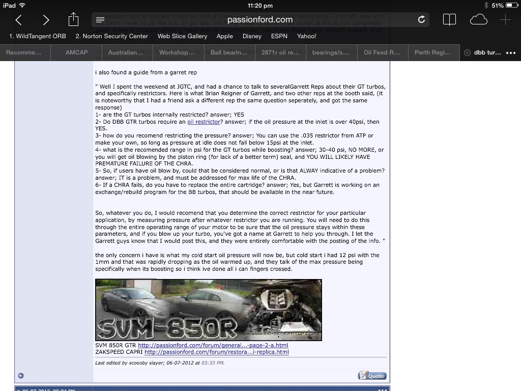

ljf12 Donating Members 20 Member For: 14y 6m 10d Posted 11/07/14 02:35 PM Share Posted 11/07/14 02:35 PM Yep 0.8mm in the inlet.From what I have been told by Garrett (it is also on their website) the oil pressure should not be higher than 45 PSI upstream of the turbo .I am pretty sure that all Garrett ball bearing turbochargers have a built in restrictor, according to them it would appear you need to fit a restrictor in the line if the pressure is too high. Link to comment https://www.fordxr6turbo.com/forum/topic/32461-turbo-oil-supply-screen-cleaning/page/42/#findComment-1484705 Share on other sites More sharing options...
ljf12 Donating Members 20 Member For: 14y 6m 10d Posted 11/07/14 03:39 PM Share Posted 11/07/14 03:39 PM I fitted a braided in line filter kit to an FG, oil was getting past the turbo seals. 1mm restrictor fitted in the line dropped the pressure to recommended levels, no more problems with oil past the seals. Obviously not happening to everyone. Link to comment https://www.fordxr6turbo.com/forum/topic/32461-turbo-oil-supply-screen-cleaning/page/42/#findComment-1484715 Share on other sites More sharing options...
arronm Dropping a turd Gold Donating Members 9,520 Member For: 17y 8m 11d Gender: Male Location: Perth Posted 12/07/14 02:17 AM Share Posted 12/07/14 02:17 AM So to drop oil pressure you put a 35 thou (0.9mm) restrictor in front of the smaller 0.8mm restrictor already in the turbo. Doesnt sound right to me Link to comment https://www.fordxr6turbo.com/forum/topic/32461-turbo-oil-supply-screen-cleaning/page/42/#findComment-1484769 Share on other sites More sharing options...
ljf12 Donating Members 20 Member For: 14y 6m 10d Posted 12/07/14 03:44 AM Share Posted 12/07/14 03:44 AM So to drop oil pressure you put a 35 thou (0.9mm) restrictor in front of the smaller 0.8mm restrictor already in the turbo. Doesnt sound right to meI could be mistaken but I am pretty sure that this is what the manufacturer is telling you to do. I only went down this path because I was having issues. When you consider that the vast majority of the time your engine revs would be under 2000 (prior to fitting a restrictor hot pressure was 45psi @2000), I don't think that higher pressure at higher revs is a problem, I don't think you can damage the seals. From what I have read providing oil is not getting past the seals you have nothing to worry about, but if (like me) oil is evident a restrictor might help.With ball bearing turbos Garrett do not appear to have any interest in flow rate only pressure prior to the turbo, it is my understanding they need very little oil to operate. Link to comment https://www.fordxr6turbo.com/forum/topic/32461-turbo-oil-supply-screen-cleaning/page/42/#findComment-1484793 Share on other sites More sharing options...
