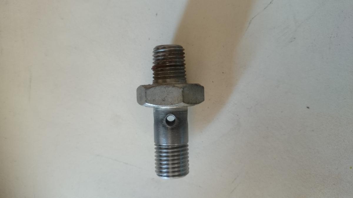

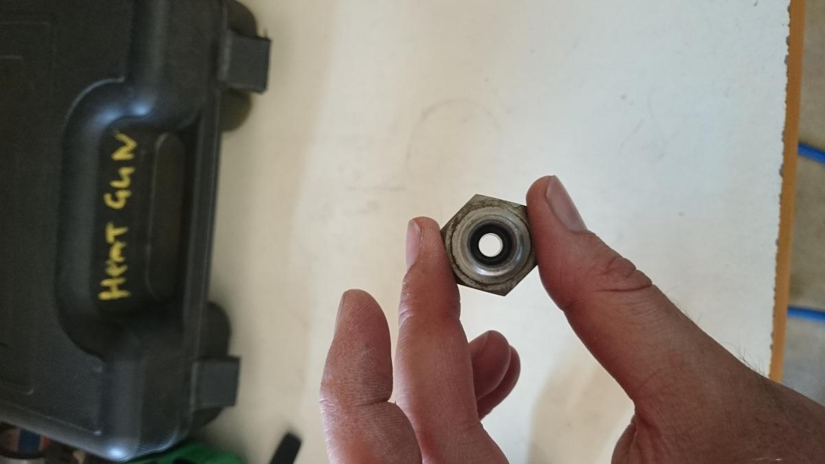

Jstplyn Member 65 Member For: 11y 5m 4d Gender: Male Location: Melbourne, Victoria Posted 23/12/13 06:59 AM Share Posted 23/12/13 06:59 AM Today I decided to try this and remove the screen but I have pulled it all apart and have found there wasn't a screen at all, had a look in the block and couldn't see any, doesn't look like there ever was one Link to comment https://www.fordxr6turbo.com/forum/topic/32461-turbo-oil-supply-screen-cleaning/page/36/#findComment-1446919 Share on other sites More sharing options...
arronm Dropping a turd Gold Donating Members 9,520 Member For: 17y 5m 21d Gender: Male Location: Perth Posted 23/12/13 09:08 AM Share Posted 23/12/13 09:08 AM that's because the previous owner sorted it. Link to comment https://www.fordxr6turbo.com/forum/topic/32461-turbo-oil-supply-screen-cleaning/page/36/#findComment-1446938 Share on other sites More sharing options...
