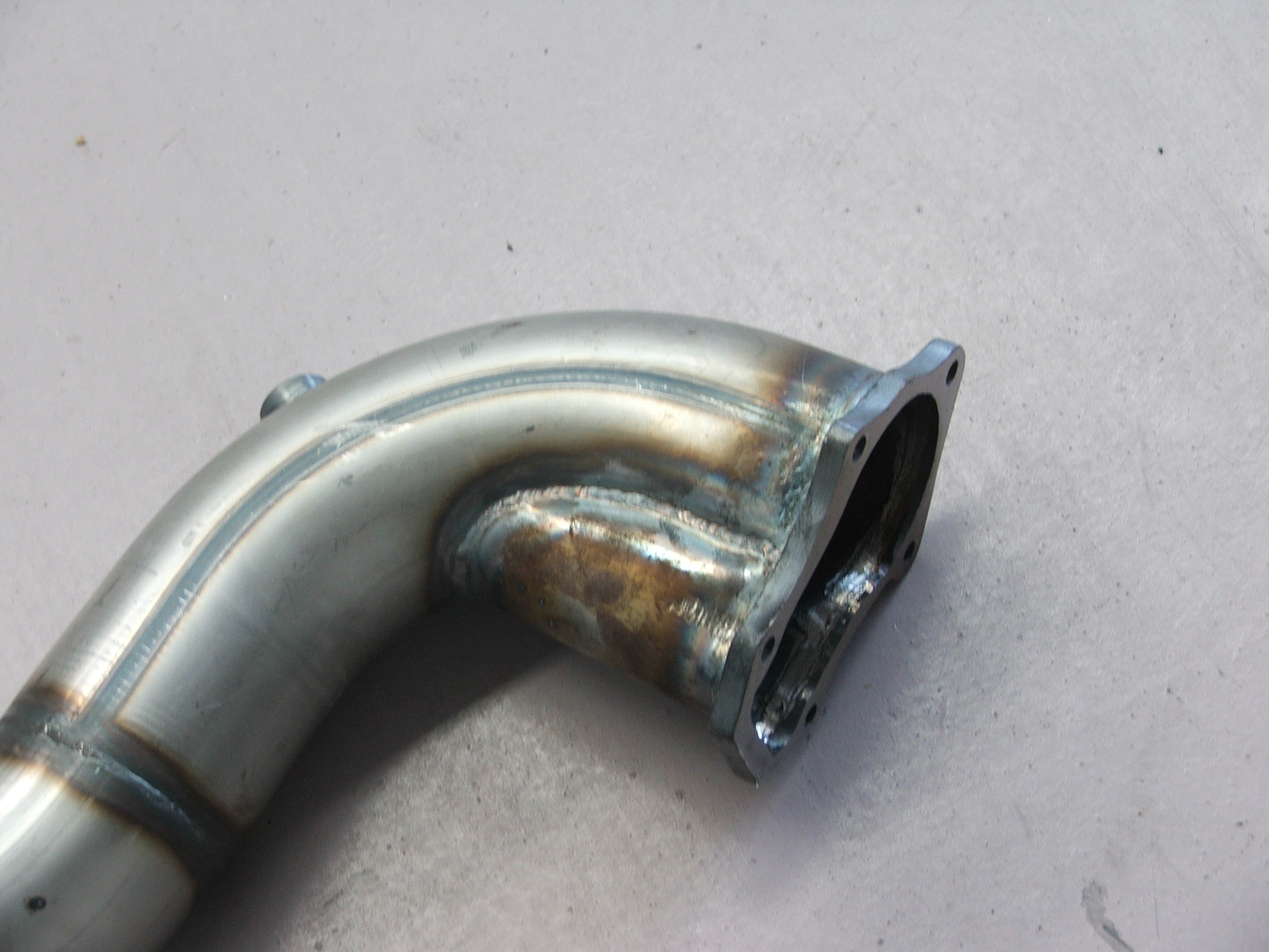

dynosteve Dyno Tuner Member 426 Member For: 21y 8m 2d Location: Redcliffe Posted 26/01/07 05:12 AM Share Posted 26/01/07 05:12 AM this is one of our dump pipes Link to comment Share on other sites More sharing options...
DennisRB30 Member 49 Member For: 21y 6m 9d Posted 26/01/07 08:41 AM Author Share Posted 26/01/07 08:41 AM that's pretty much like the one I made. Link to comment Share on other sites More sharing options...
