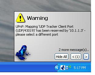

XR06T Silver Donating Members 4,146 Member For: 19y 10m 6d Gender: Male Posted 06/02/07 11:59 AM Author Share Posted 06/02/07 11:59 AM (edited) okay guys, another problem..my dads mac is on this network too and it just seems to take the port that azerus on my computer wants to use. attached is the error that comes up when I load azureus..the problem doesn't always show its head when 1st creating the network (I've had to make a few now...) but in the end it always happens..I see that in the azureus options you can change the port which it uses for UDP (whatever that is ) so do I just punch another number in there and hope for the best?is there a way I can get the mac to leave this port alone so azureus can use it?cheers in advance..bloody macs......... Edited 06/02/07 12:05 PM by XR06T Link to comment https://www.fordxr6turbo.com/forum/topic/31609-problem-with-wireless-router/page/2/#findComment-494500 Share on other sites More sharing options...
shockF6 Member 478 Member For: 19y 6m 25d Location: Melbourne Posted 06/02/07 01:18 PM Share Posted 06/02/07 01:18 PM just tell azureus to use a different port that doesnt conflict with anything else on your network.oh and dont forget to forward the port you choose in your router/firewall/modem etc aswell and 1 last thing, your dropouts that you were complaining about at the start of this thread have nothing to do with azureus. it has nothing to do with any part of your internet connection for that matter either. your only pinging your local router. Id say its some 2.4ghz devices in the area that are causing you hassles.Maybe your neighbour has just bought himself a new 2.4ghz cordless phone???? just my 2c. Link to comment https://www.fordxr6turbo.com/forum/topic/31609-problem-with-wireless-router/page/2/#findComment-494517 Share on other sites More sharing options...
XR06T Silver Donating Members 4,146 Member For: 19y 10m 6d Gender: Male Posted 07/02/07 12:28 AM Author Share Posted 07/02/07 12:28 AM thanks shock..I think our home phone is 2.4ghz :rl:guess it is something that I'll have to live with as when I search for wireless networks another one come up, next door as a guess..as for the other port for azureus, can I just choose the next number, ie 43020?or is there some other specific number I should choose?thanks for the insight shock Link to comment https://www.fordxr6turbo.com/forum/topic/31609-problem-with-wireless-router/page/2/#findComment-494608 Share on other sites More sharing options...
shockF6 Member 478 Member For: 19y 6m 25d Location: Melbourne Posted 07/02/07 02:08 AM Share Posted 07/02/07 02:08 AM XR06T said: as for the other port for azureus, can I just choose the next number, ie 43020?or is there some other specific number I should choose?you can use any port number you like as long as its below 65536 and not being used by any other application or PC on your network.Your very unlucky to be using a port number that high that is already in use but the ods are that the next number up should be ok to use, or just change the 43020 to 53020.maybe you have more than 1 pc on your network that is running azureus and both may be configured to use the same port???just remember to forward the port you choose in all the appropriate places otherwise it will still give you grief Link to comment https://www.fordxr6turbo.com/forum/topic/31609-problem-with-wireless-router/page/2/#findComment-494645 Share on other sites More sharing options...
