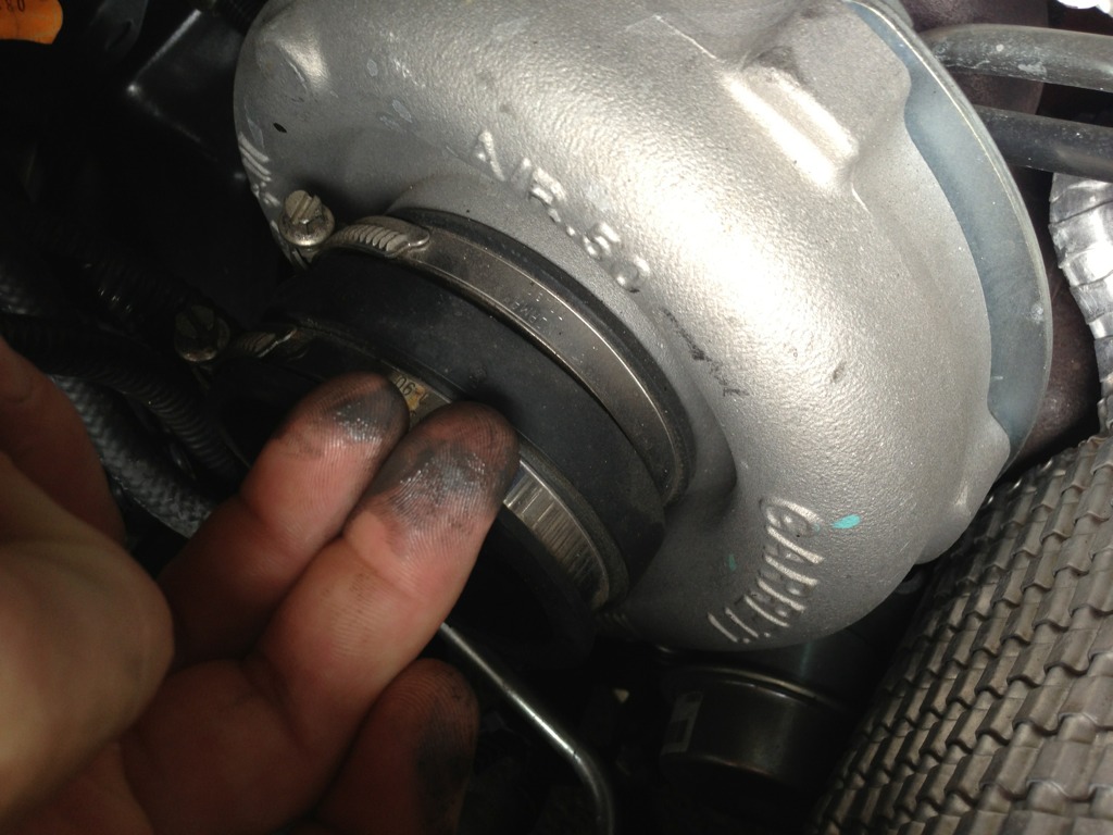

turboBA Member 28 Member For: 12y 3m 7d Gender: Male Location: Perth Posted 17/01/13 03:18 AM Share Posted 17/01/13 03:18 AM After reading this post I have just pulled mine apart. clamp wasnt removable but managed to get it off with the clamp... and back on. If I loose everything ill know where to look and have to go buy a small clamp. Its on its 5 min idle at the moment, then a test drive :jump: 1 Link to comment https://www.fordxr6turbo.com/forum/topic/31329-boost-solenoid-maintenance/page/56/#findComment-1350644 Share on other sites More sharing options...
visine Member 144 Member For: 12y 5m 30d Posted 28/02/13 01:36 AM Share Posted 28/02/13 01:36 AM Decided to do this today and manifold bolts just about to pull off heat shield notice some build up around turbo anything to worry about. Link to comment https://www.fordxr6turbo.com/forum/topic/31329-boost-solenoid-maintenance/page/56/#findComment-1367369 Share on other sites More sharing options...
Kosij Donating Members 2,045 Member For: 13y 8m 1d Gender: Male Posted 28/02/13 01:53 AM Share Posted 28/02/13 01:53 AM That's normal! Link to comment https://www.fordxr6turbo.com/forum/topic/31329-boost-solenoid-maintenance/page/56/#findComment-1367374 Share on other sites More sharing options...
visine Member 144 Member For: 12y 5m 30d Posted 28/02/13 02:22 AM Share Posted 28/02/13 02:22 AM Cool thanks. Link to comment https://www.fordxr6turbo.com/forum/topic/31329-boost-solenoid-maintenance/page/56/#findComment-1367383 Share on other sites More sharing options...
