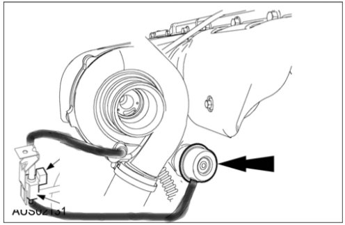

Paulie2256 Donating Members 7,441 Member For: 16y 4m 11d Gender: Male Location: SE Melbourne Posted 17/05/11 06:05 AM Share Posted 17/05/11 06:05 AM Hey gasman, make sure the solenoid is connected like so.If it already is connected this way make sure you get it checked on a dyno.PS: I apologise about the diagram Link to comment Share on other sites More sharing options...
Gasman Ford Nub Member 412 Member For: 13y 11m 25d Gender: Male Location: Gold Coast Posted 17/05/11 09:01 AM Share Posted 17/05/11 09:01 AM (edited) hey thanks its actually clearer than the image in the manual. that's how it is now.heres how I found it(ignore your hoses), why would it have been connected this way do you think? Edited 17/05/11 09:02 AM by Gasman Link to comment Share on other sites More sharing options...
SuckSqueezeBangBlow ʎǝʞuoɯ ɹoıuǝs Donating Members 1,808 Member For: 16y 3m 17d Gender: Male Posted 17/05/11 10:23 AM Share Posted 17/05/11 10:23 AM when did you buy it? was the seller trying to sell it as a mostly stocker? by bypassing the solenoid you would run only what boost setting the wastegate actuator is set for I.e. stock = around 5 psi. I would say that your tune isn't the factory one since its now boosting higher than normal with the solenoid connected. Link to comment Share on other sites More sharing options...

Gasman Ford Nub Member 412 Member For: 13y 11m 25d Gender: Male Location: Gold Coast Posted 18/05/11 08:01 AM Share Posted 18/05/11 08:01 AM the injectors are the stock bosch items according to google.Just a thought, I was reading in the forum somewhere that the soleniod may be bypassed due to the exhaust system being fitted , maybe in an attempt to cure overboosting. Link to comment Share on other sites More sharing options...
Paulie2256 Donating Members 7,441 Member For: 16y 4m 11d Gender: Male Location: SE Melbourne Posted 18/05/11 08:44 AM Share Posted 18/05/11 08:44 AM If the exhaust and cooler are aftermarket and it wasn't tuned it would be overboosting hard. If that's the case you are up for a custom tune. Link to comment Share on other sites More sharing options...
