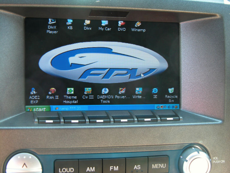

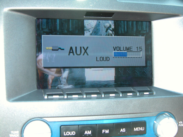

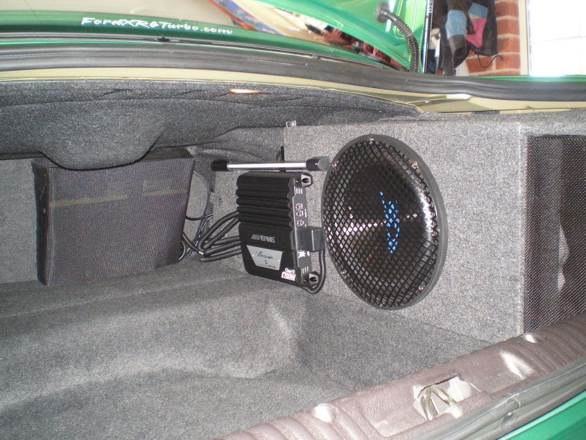

veczar Gold Platinum Member Member 1,081 Member For: 20y 6m 19d Gender: Male Location: Victoria Posted 24/11/06 12:37 PM Share Posted 24/11/06 12:37 PM As I have completed the hardest stages of my XR6T's Audio Visual project I decided to post up some details and photos. I will leave out the photos of the cut and bruised knuckles and the soldering iron imprinted foot. The summary (for those lazy sods who dont like reading) is that I have finished the first few (main) stages which include custom sub install and notebook displaying on the BA ICC screen. This can be used for many things including music videos, MP3s, DVD/DIVX, PC games, GPS/SatNav, internet etc etc. Its turns on via a switch on my fuse panel (will be changed so it turns on when I unlock my car) and off when the key has been out for 10 mins. The normal ICC controls (heater, volume etc) come over-layed on the screen when one of the buttons on the ICC is pressed. There is also and on off button on the fuse panel to change the BA ICC screen from normal to carbook mode.Thanks for the pics Gary/EvilDaufu...Stage One: The premium sub and amp in the BA-BF sucks and is only comparable to some decent aftermarket 6x9's. The only part of this project I did not do myself was construsct the custom box, I got a mate to do this for me as he knows all about the required capacities and porting for sub enclosures. The main advantages of the style of sub setup I chose are that it doesn't limit the use of my boot and also keeps a neat semi-stealth look. I originally had Sony equipment but I changed to the new Alpine stuff.Basic tech details are hi input taken from the rear speakers converted to low output into the mono amp. The remote amp on line was taken from an unused trailer line rewired at the fuse panel to become and acc line. One tip I strongly give for those doing any car AV project is: Do not underestimate the importance of proper grounding. My sub had major quality issues until I put in a 60cm 4GA ground line (as opposed to my original thiner 2m ground). Stage Two: carBook, same as a carputer only its a notebook This project was more difficult than I have time to write here as problems never stopped popping up! Ill just write some basic info below;2.1 was proof of concept. This took one weekend to get the basic concepts mapped out and my laptop video car outputting onto the BA ICC screen. I could not seem to get the sync, res, refresh, interlace etc options correct. Finally I got the settings working but I had the issue that when I turned the car off then on the screen would scroll to a dodge position. Fun fun but finally I got working just before I went blind. PM Panda for one of his cables! Also, thanks Panda for your help along the way!2.2. was the physical carbook install. I made a painted aluminum harness that I bolted and riveted to the rear of the rear right seat (only one hole in the seat from an unko drilling moment by my brother but it's behind the cup holder so no-one will ever see it). The carbook is suspended in foam to absorb bumps that could damage the hard drive. There is less and 10mm left above and below the laptop that's how tight the fit is! 2.3 was a cover for the carbook as I didnt want people to see a laptop in my boot. I used a mesh material that is full of holes to allow the notebook fans to work yet it is not see thru from above due to the angle of the holes. Its similar to what a lot of ricer cars use for the front grill.2.4 was to run the audio, remote-on line and usb line to the front of the car thru the passenger side panels. I made my own audio cable using neutrik connectors and expensive canare cable. The remote-on line I use a phone cable so I could easily disconnect the laptop from the car. A second line is soldered to a little plug on the laptop from the on button. I am using a wireless mouse for most of the input at the moment (receiver is under the seat) but this will change to involve other devices eg remote and touchscreen shortly.2.5 was to run a negative, positive and another line (for changing laptop between battery and AC power) on the drive side panels to the car battery. I installed the DC-AC inverter with metal brackets behind the sub box along with the laptops power suply. I originally tried to use different types of DC laptop chargers but these made the screen flicker due to some sort of ground loop through the VGA cable. ShockF6 helped me considerably in this stage by offering his electrical expertise and an ear for me to complain to. Thanks mate I couldn't have done it without ya!! We tried to fix the screen flicker at different points in the system with combinations of capacitors, filters, inductors, resistors and different inverters. Finally we came up with an acceptable setup that is not perfect yet (when the laptop is charging) but is acceptable as most people do not notice the slight flicker that is left.2.5 was the switch panel. All but one of the nine switches is now in use. Im saving the last one for NOS or a James bond style revolving number plate. Most of the switches are on relays so they only work when car is going or on acc. I also got a 'shockBox' to fix the audio whine issue. PM ShockF6 for one of his shockBoxen as they work amazingly <plug> It is worth every penny and more. Buy one today for only $99.97 and get free installation help! </plug>.2.6 was to put the T back together and clean out all the metal fragments, sawdust etc :D Stage Three: This involves the software side of the CarBook. DVD's, DIVX and MP3's are fully working. The bulk of the time I use the CarBook to play my MP3's while the ICC screen is displaying full-screen winamp AVS visualizations (of which I have installed hundreds of them). I have some games (Age of Empires, Full throttle, Risk, Street Rod, Stunts, Theme hospital, Civ IV, etc) but I am still working on making more full screen games work. I am also experimenting with carputer front ends.In the near future the next stages include touch screen overlay (high priority), replace speakers (high priority), DVD drive below the ICC for easy access, unlock switch on, GPS/SatNav, WarDrive setup, rear headrest screens (low priority), 2nd sub and amp identical mirror to the current one, remote control and amps for speakers. Link to comment Share on other sites More sharing options...
Typhoon Member 564 Member For: 20y 3m 22d Gender: Male Posted 24/11/06 12:47 PM Share Posted 24/11/06 12:47 PM Umm screens a bit small dont you think? Link to comment Share on other sites More sharing options...

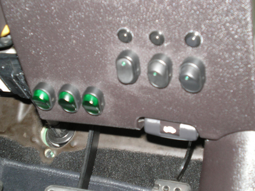

veczar Gold Platinum Member Member 1,081 Member For: 20y 6m 19d Gender: Male Location: Victoria Posted 24/11/06 01:56 PM Author Share Posted 24/11/06 01:56 PM Here is fuse panel picture with my nine switches: Link to comment Share on other sites More sharing options...

Adam Here since the start... Lifetime Members 10,282 Member For: 21y 8m 19d Gender: Male Location: Victoria Posted 25/11/06 11:36 AM Share Posted 25/11/06 11:36 AM Or just recording you doing naughty stuff on the back seat!Tim, from what I understand there isn't a touch screen overlay the same size as the screen in the ICC. Link to comment Share on other sites More sharing options...
