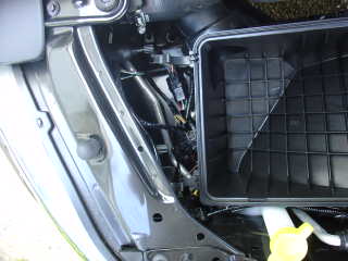

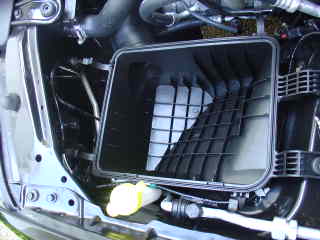

bugster70 Donating Members 1,326 Member For: 20y 2d Location: Canberra Posted 09/11/06 03:26 AM Share Posted 09/11/06 03:26 AM First, I thought the BFs had the 2nd CAI as a standard feature? Second, larger injectors aren't all about more outright power. We have already seen a few cases of Ts pushing 280-300rwkw on stock injectors, but that's only half the story. I think there are a couple of issues here. One, at those power levels, the stock injectors will be close to or actually maxxing out, not ideal. Two, whilst the peak power may read in the high 200s, it's the driveability/sheer grunt of the car lower in the rev range that suffers. Larger injectors will allow more fuel at those crucial points lower in the rev range where lots of torque is being developed. More fuel will mean more torque lower down, which is where you really feel it in most (street) driving conditions. My larger injectors didn't result in a great deal more overall power, but the pull I now have lower down is chalk and cheese compared to when I was running stock injectors. Link to comment https://www.fordxr6turbo.com/forum/topic/30092-first-mods/page/2/#findComment-461854 Share on other sites More sharing options...
Tex Member 56 Member For: 20y 11m 12d Location: Brisbane Posted 09/11/06 03:37 AM Share Posted 09/11/06 03:37 AM After thinking about it your point about the larger injectors makes sense. Maximum power is not the main consideration as you don't spend much time there, driveability is the most important thing. Quote First, I thought the BFs had the 2nd CAI as a standard feature?I thought so to. Apparently there is some confusion with the spare parts catalog. My new BFIIT does not have a second CAI Link to comment https://www.fordxr6turbo.com/forum/topic/30092-first-mods/page/2/#findComment-461859 Share on other sites More sharing options...
