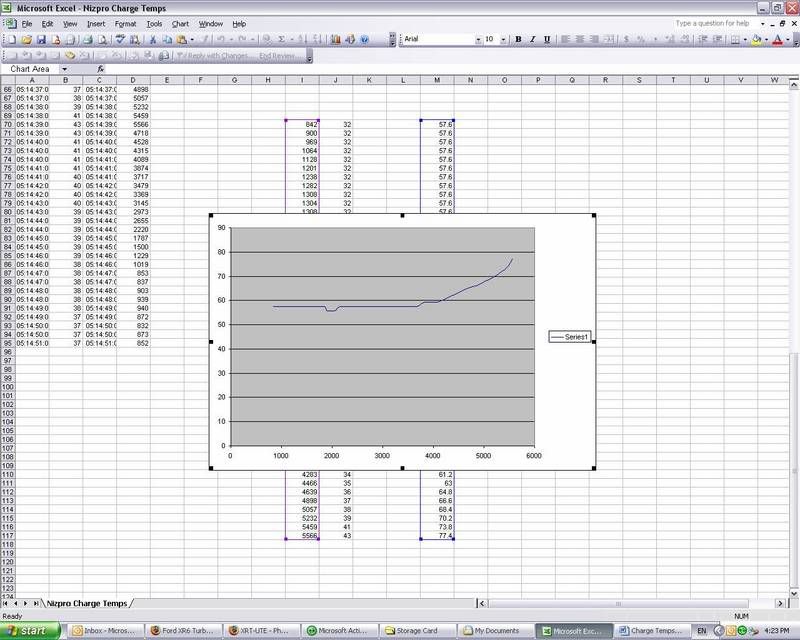

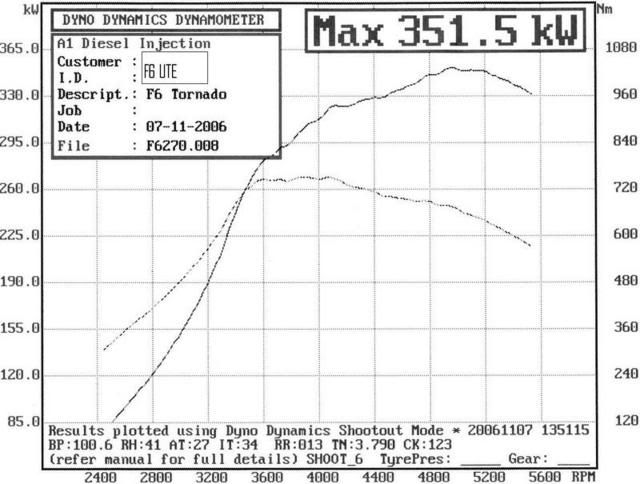

F6 UTE - Track Bound EVO III - Member 3,367 Member For: 20y 5m 23d Gender: Male Location: Strapped in and holding on Posted 07/11/06 08:39 AM Author Share Posted 07/11/06 08:39 AM (edited) OK, just got back from the dyno.Wog tune was a no-go, as the injector scalers need tweaking up, and I'll do that next time..Simon put a tune in for me..Results of the cooler install..Here are the charge temps with the Nizpro cooler. Pretty massive improvement considering 34deg intake temps.. (61 deg F for the sake of the graph ) Consider also intake temps only rise 11 degrees on the dyno run, compared to the stocker it's quite amazing.. Another way of looking at it.After a full dyno pull, to max power, the charge temps are still colder than the F6 unit at IDLE with the factory piping.. Compared to the STOCK F6 coolerResulting in351.5RWKW.To clarify, the Mods areInjectorsNizpro Cooler- F6 UTE piping as per pix. 8psi Actuator4" dump4" punched CATCentre Section removalEdit, Xede controlling boostFuel is 12.0 and we could have wound her up to 370rwkw fairly easily.. I have a small boost leak which I will get welded up, and that might help a touch aswell.All in all, very nice on the road and effortless with this power..EDIT: Effectively, the cooler install and pipework has gained roughly 50rwkw.... taking into consideration intake temps. I'll go to the drags wednesday, all things going well (clutch ) and see what happens. Edited 07/11/06 08:43 AM by F6 UTE Link to comment https://www.fordxr6turbo.com/forum/topic/29699-my-intercooler-install/page/5/#findComment-461084 Share on other sites More sharing options...

RAP1D Member Donating Members 3,739 Member For: 19y 19d Gender: Male Location: Sydney NSW Posted 07/11/06 11:07 AM Share Posted 07/11/06 11:07 AM Nice and awesome results. Goes to show the massive benefits in fitting a decent intercooler system. How's it feel on the road? Link to comment https://www.fordxr6turbo.com/forum/topic/29699-my-intercooler-install/page/5/#findComment-461175 Share on other sites More sharing options...
RAP1D Member Donating Members 3,739 Member For: 19y 19d Gender: Male Location: Sydney NSW Posted 07/11/06 11:09 AM Share Posted 07/11/06 11:09 AM oh and what psi are you getting the 351kws at? Link to comment https://www.fordxr6turbo.com/forum/topic/29699-my-intercooler-install/page/5/#findComment-461176 Share on other sites More sharing options...

F6 UTE - Track Bound EVO III - Member 3,367 Member For: 20y 5m 23d Gender: Male Location: Strapped in and holding on Posted 07/11/06 12:23 PM Author Share Posted 07/11/06 12:23 PM Tnx gents.The damn camera still has no bats, I'll try and raid the remotes to grab a pik..Boost, well it's running a bit less than it was for 313rwkw, on the 11.8 run. Don't worry, there's still a bit dialed in..I'm keeping that bit of 'research' under my hat until I have done my plenum to gauge any positive/negative benefit.. Link to comment https://www.fordxr6turbo.com/forum/topic/29699-my-intercooler-install/page/5/#findComment-461227 Share on other sites More sharing options...
