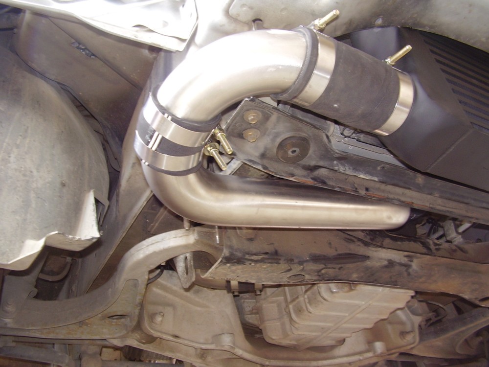

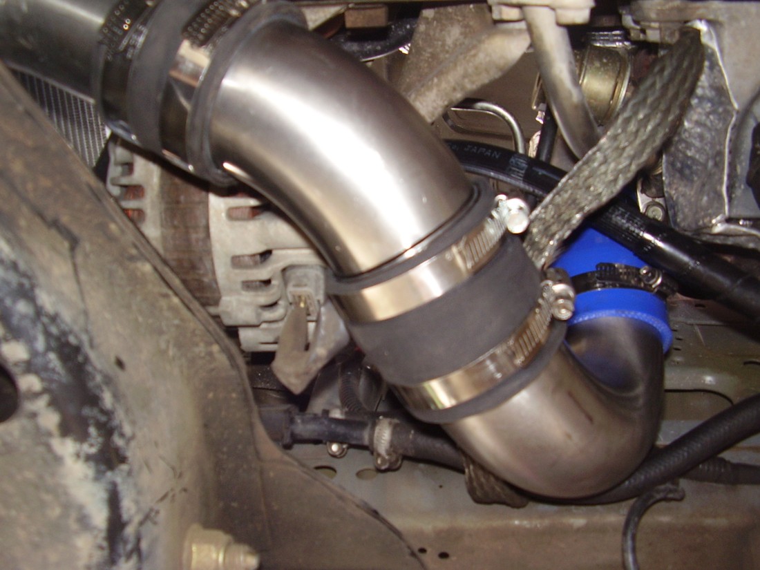

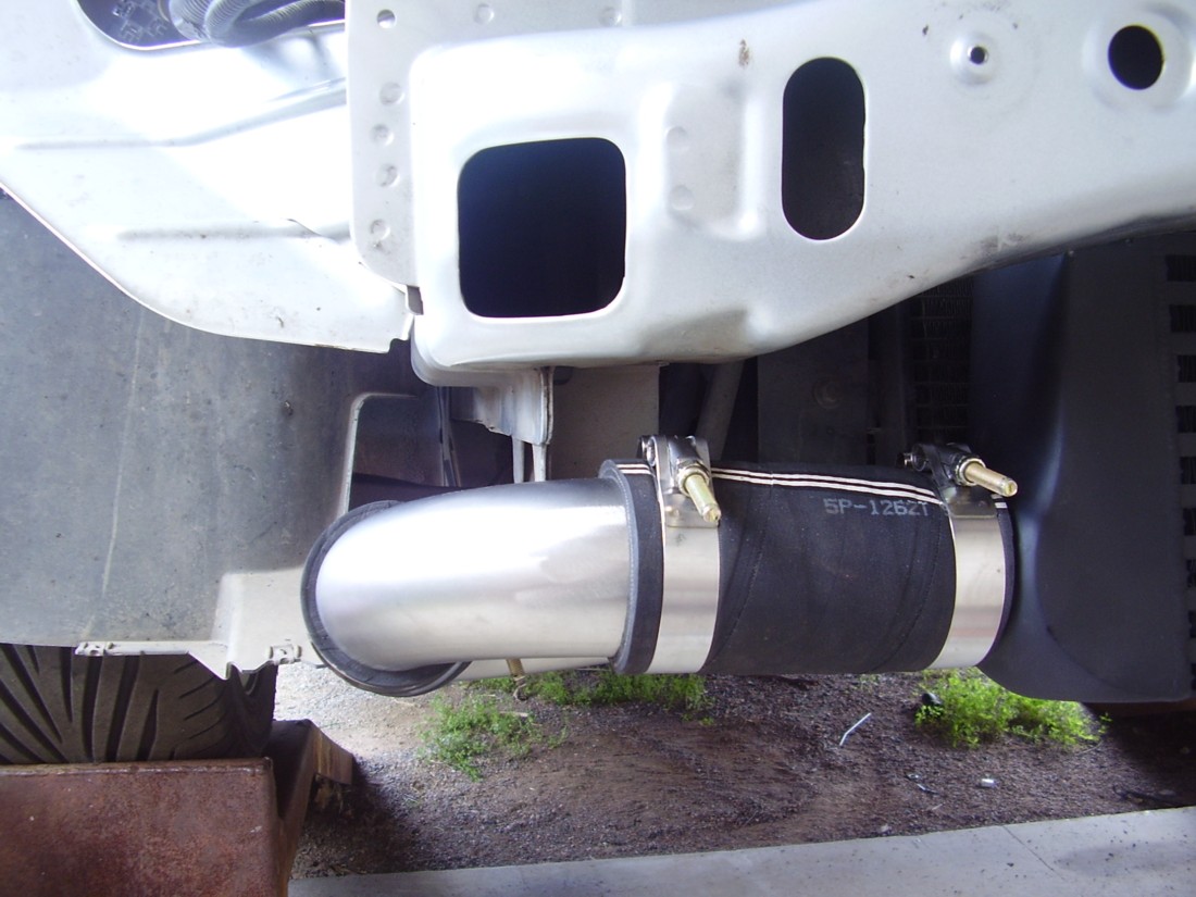

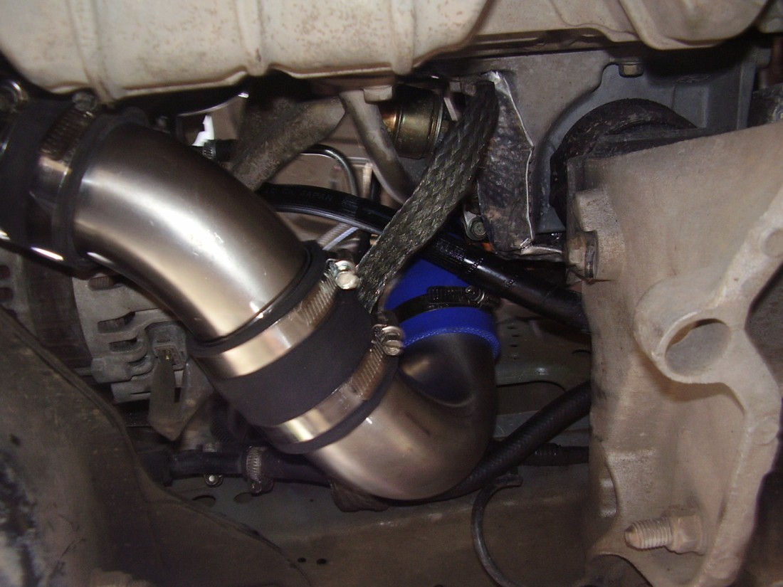

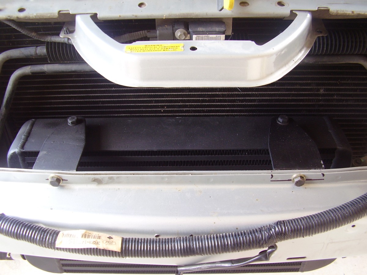

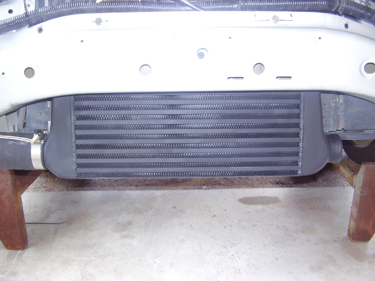

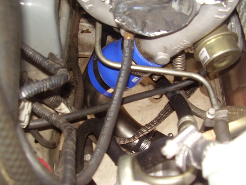

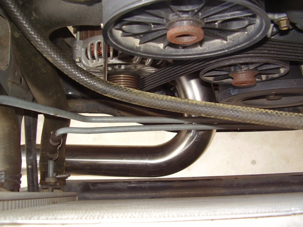

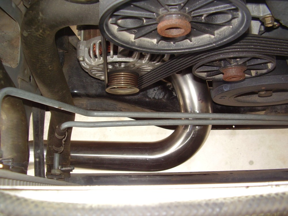

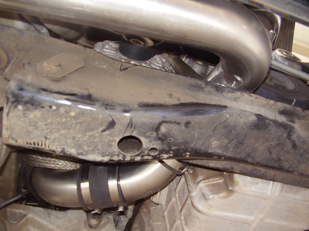

Eugene Member 670 Member For: 20y 8m 4d Gender: Male Location: Newcastle NSW Posted 11/11/06 05:58 AM Author Share Posted 11/11/06 05:58 AM Piping from turbo to cooler is done, the cooler is mounted too, (hybrid 450x300x80 with 2.5" in and out).All the pipes have to be removed aagin, cleaned inside and out then painted black, but here they are fitted.All pretty straight foward, I ran out of HD clamps, so the regular ones are there for the pics only, more HD clamps will be fitted on the final install. Link to comment https://www.fordxr6turbo.com/forum/topic/29381-custom-aftermarket-piping-from-turbo-to-cooler/page/2/#findComment-462903 Share on other sites More sharing options...
