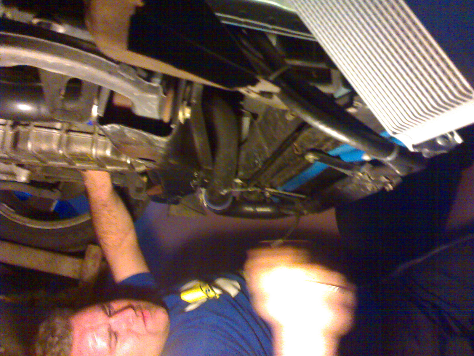

DBOSS Faster than any BTA,XTC,Autotech, Nizpro and Tunehouse car Member 3,918 Member For: 21y 9m 20d Location: D SHIRE! Posted 23/10/06 01:08 AM Share Posted 23/10/06 01:08 AM Some pic's of Stealthxr's setup Link to comment https://www.fordxr6turbo.com/forum/topic/29347-oil-cooler/page/3/#findComment-452843 Share on other sites More sharing options...
stealthxr Donating Members 553 Member For: 19y 2m 5d Gender: Male Location: The Shire Sydney AUS Posted 23/10/06 01:16 AM Share Posted 23/10/06 01:16 AM DBOSS said: Some pic's of Stealthxr's setup←I figure your phone is alive... Link to comment https://www.fordxr6turbo.com/forum/topic/29347-oil-cooler/page/3/#findComment-452846 Share on other sites More sharing options...
DBOSS Faster than any BTA,XTC,Autotech, Nizpro and Tunehouse car Member 3,918 Member For: 21y 9m 20d Location: D SHIRE! Posted 23/10/06 01:24 AM Share Posted 23/10/06 01:24 AM stealthxr said: DBOSS said: Some pic's of Stealthxr's setup←I figure your phone is alive...←I found it saved on my PC Link to comment https://www.fordxr6turbo.com/forum/topic/29347-oil-cooler/page/3/#findComment-452853 Share on other sites More sharing options...

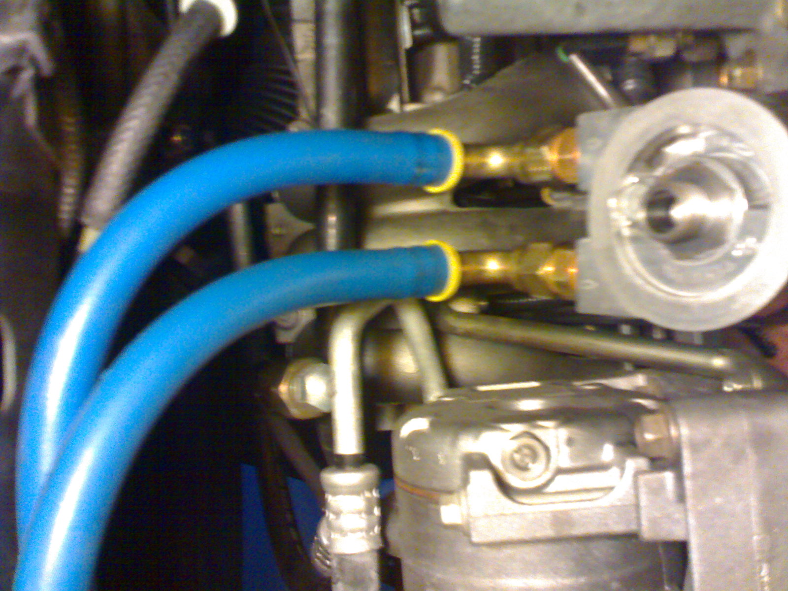

937 Member 266 Member For: 18y 9m 8d Posted 23/10/06 01:36 AM Author Share Posted 23/10/06 01:36 AM loopism said: Tell us the price, son!←81.00 $'s @ Auto Barn. Link to comment https://www.fordxr6turbo.com/forum/topic/29347-oil-cooler/page/3/#findComment-452861 Share on other sites More sharing options...
seventytwo Still have a turbo, it's just on a diesel. Lifetime Members 5,368 Member For: 19y 9m 4d Gender: Male Location: The 8th Dimension Posted 23/10/06 02:08 AM Share Posted 23/10/06 02:08 AM I take it, that's just for the adapter and the cooler is extra? Link to comment https://www.fordxr6turbo.com/forum/topic/29347-oil-cooler/page/3/#findComment-452871 Share on other sites More sharing options...
937 Member 266 Member For: 18y 9m 8d Posted 23/10/06 03:15 AM Author Share Posted 23/10/06 03:15 AM (edited) seventytwo said: I take it, that's just for the adapter and the cooler is extra?←Yes, just the Adaptor. 81.00$'sStill have to get some hose, once everything is in place.Just fund a bit of a problem, Inter-cooler hose Edited 23/10/06 03:27 AM by 937 Link to comment https://www.fordxr6turbo.com/forum/topic/29347-oil-cooler/page/3/#findComment-452889 Share on other sites More sharing options...

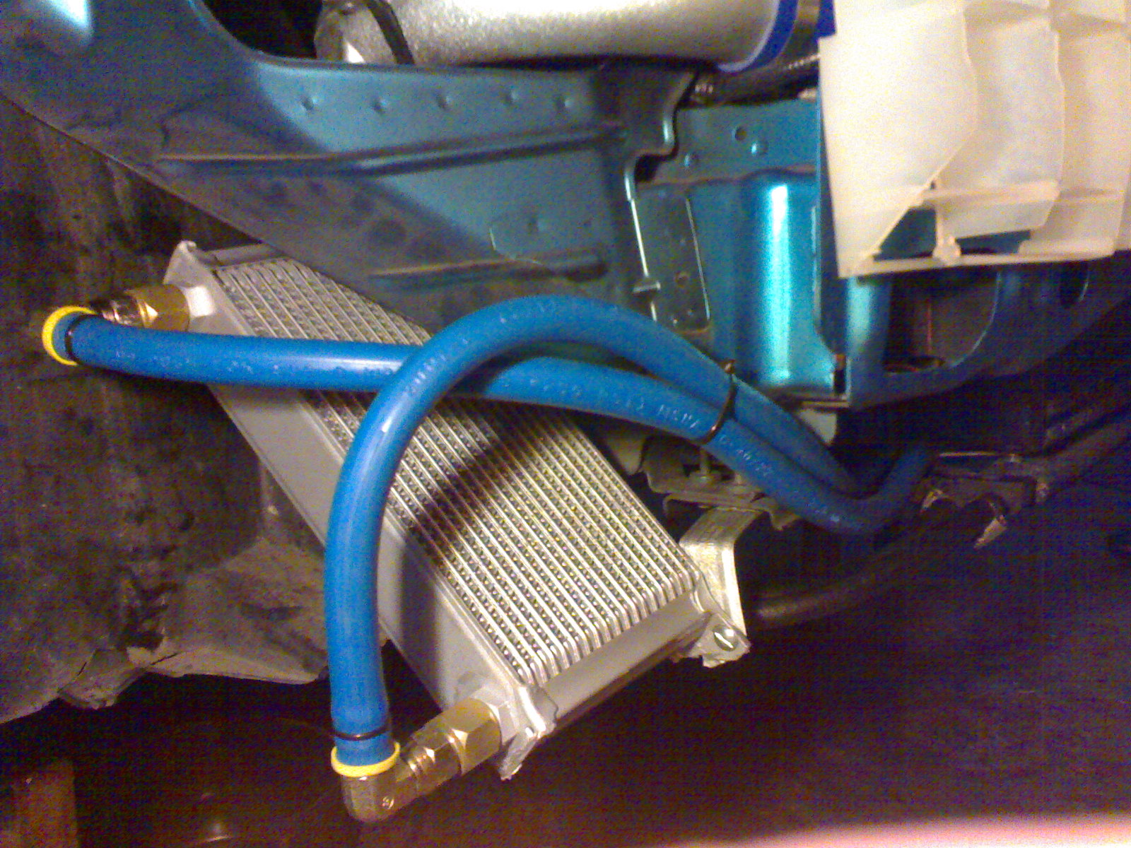

937 Member 266 Member For: 18y 9m 8d Posted 24/10/06 06:48 AM Author Share Posted 24/10/06 06:48 AM (edited) It is done !!!!Test drive Oil temp now 80 COil temp before Oil Cooler 100 C - 105 C normal driving.After and and I put the cooler in front of the Intercooler.Could not put it in to the space in front of the wheel on the driver side !! Intercooler Pipe !! Some people may say no good, but I think my Oil Temp is more important than a warmish Intercooler.I am so happy with the final product. Edited 24/10/06 06:56 AM by 937 Link to comment https://www.fordxr6turbo.com/forum/topic/29347-oil-cooler/page/3/#findComment-453596 Share on other sites More sharing options...
vincexr6t Member 31 Member For: 19y 2m 7d Location: Adelaide Posted 25/10/06 08:18 AM Share Posted 25/10/06 08:18 AM Looks sweet you have done a good job. What did you pay for your hose to be made up.My oil temp increased Once I had all my mods done to a bit higher then yours, So I would be very happy to get them down to 80-90c I still have to wait a few weeks before I can do mine, but its all good Link to comment https://www.fordxr6turbo.com/forum/topic/29347-oil-cooler/page/3/#findComment-454227 Share on other sites More sharing options...
937 Member 266 Member For: 18y 9m 8d Posted 25/10/06 08:32 AM Author Share Posted 25/10/06 08:32 AM vincexr6t said: Looks sweet you have done a good job. What did you pay for your hose to be made up.My oil temp increased Once I had all my mods done to a bit higher then yours, So I would be very happy to get them down to 80-90c I still have to wait a few weeks before I can do mine, but its all good←Hi there,Thank you.I got the fittings , 4 plus 2 for 149.00$'s.The hose was 50.00$'s for 2 metres. Push on, rated @ over 200 psi.Intercooler 78.00 $'s.Adaptor 81.00 $'sAbout 30.00$'s for the small bits. Link to comment https://www.fordxr6turbo.com/forum/topic/29347-oil-cooler/page/3/#findComment-454230 Share on other sites More sharing options...
