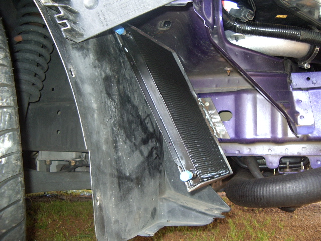

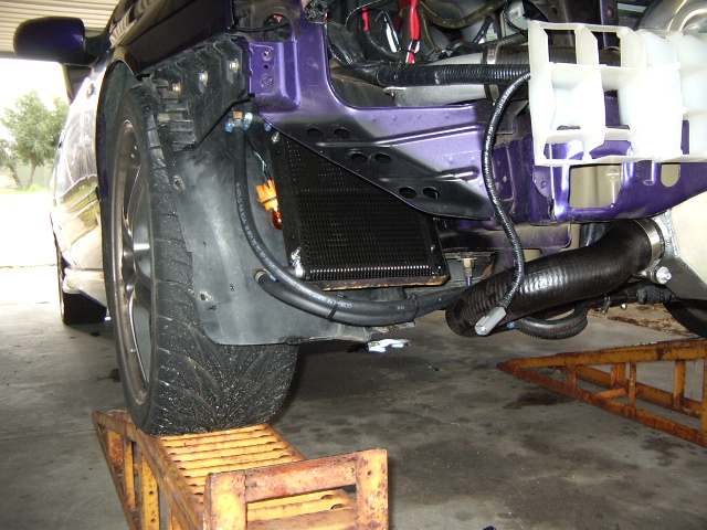

937 Member 266 Member For: 18y 9m 25d Posted 16/10/06 11:37 PM Share Posted 16/10/06 11:37 PM (edited) Has anyone fitted one of these.I,m about to get one and fit a complete system to my BA Mk2 Turbo.The big question is, where is the best place to mount the cooler ?Not much room left with all the in front of the radiator.If anyone done one, I would like to see some pictures so I can get a bit of an idea.Thank you.Measures 29cm x 14cm, 5cm thick (total length including brackets 33cm) Edited 16/10/06 11:39 PM by 937 Link to comment https://www.fordxr6turbo.com/forum/topic/29347-oil-cooler/ Share on other sites More sharing options...
TIMXR6T Member 116 Member For: 19y 7m 27d Location: Shire Posted 16/10/06 11:44 PM Share Posted 16/10/06 11:44 PM Will it fit between the bumper bar and the wheel arch. Link to comment https://www.fordxr6turbo.com/forum/topic/29347-oil-cooler/#findComment-450241 Share on other sites More sharing options...

Hitman Member 187 Member For: 21y 6m 23d Gender: Male Location: Sydney Posted 17/10/06 04:28 AM Share Posted 17/10/06 04:28 AM (edited) This is my setup... oh and it works Dave Edited 17/10/06 04:33 AM by Hitman Link to comment https://www.fordxr6turbo.com/forum/topic/29347-oil-cooler/#findComment-450344 Share on other sites More sharing options...
seventytwo Still have a turbo, it's just on a diesel. Lifetime Members 5,368 Member For: 19y 9m 21d Gender: Male Location: The 8th Dimension Posted 17/10/06 04:54 AM Share Posted 17/10/06 04:54 AM for that set up to work do you have to remove the undertray? Link to comment https://www.fordxr6turbo.com/forum/topic/29347-oil-cooler/#findComment-450353 Share on other sites More sharing options...
937 Member 266 Member For: 18y 9m 25d Posted 17/10/06 05:09 AM Author Share Posted 17/10/06 05:09 AM Dave, thank you very much for all that information.It's something I will have to look in to / explore. AAA+ Link to comment https://www.fordxr6turbo.com/forum/topic/29347-oil-cooler/#findComment-450361 Share on other sites More sharing options...

Hitman Member 187 Member For: 21y 6m 23d Gender: Male Location: Sydney Posted 17/10/06 09:11 PM Share Posted 17/10/06 09:11 PM seventytwo said: for that set up to work do you have to remove the undertray?←The undertray was put back on with the xr bar, these are old pic's I now have my GTP bar on the car (The GTP bar is lower) I will take some more pics when I can get under the car..Dave Link to comment https://www.fordxr6turbo.com/forum/topic/29347-oil-cooler/#findComment-450750 Share on other sites More sharing options...
