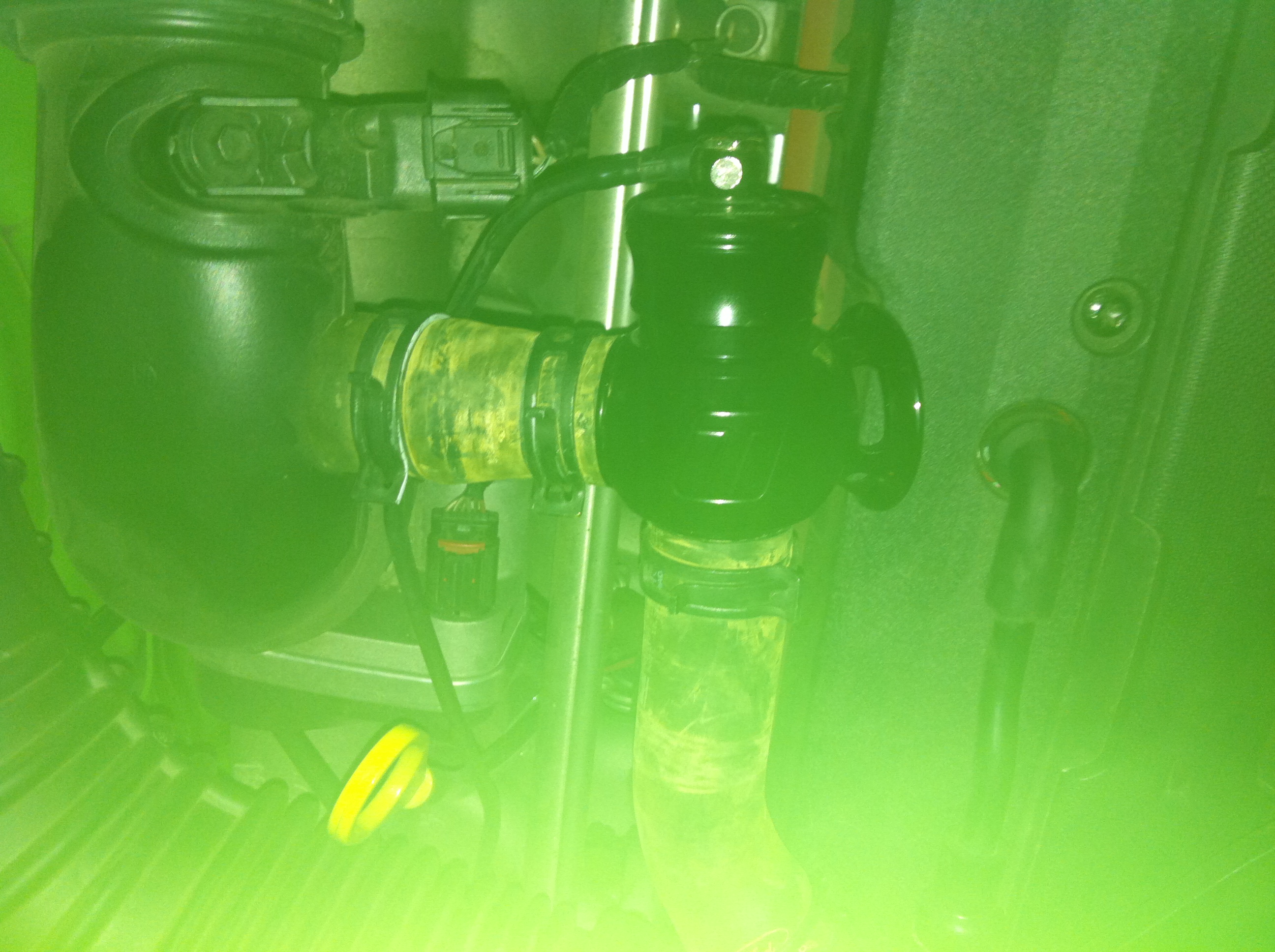

xr6turbosam Member 31 Member For: 15y 17d Gender: Male Posted 21/04/11 11:31 AM Share Posted 21/04/11 11:31 AM I got a turbosmart kompact.... fitted it to my FG and lets of a PSHHHHHHHH sound. the sound says, I got something under my bonnet, but its not too loud to say im a try hard. probably the best way you could have it. however if you are running some serious PSI and have a serious engine.... I reckon you would want some serious doessssss.Hi does anyone have a pic?I have a kompact plumbback fully vented and its not loud at all!I have posted a bad photo hopefully I have it right! Link to comment https://www.fordxr6turbo.com/forum/topic/25971-turbosmart-blow-off-valves-thread/page/21/#findComment-1098785 Share on other sites More sharing options...
xr6turbosam Member 31 Member For: 15y 17d Gender: Male Posted 21/04/11 11:59 AM Share Posted 21/04/11 11:59 AM Hi does anyone have a pic?I have a kompact plumbback fully vented and its not loud at all!I have posted a bad photo hopefully I have it right!photo facing the right way! Link to comment https://www.fordxr6turbo.com/forum/topic/25971-turbosmart-blow-off-valves-thread/page/21/#findComment-1098794 Share on other sites More sharing options...

steve_xr6t New Member 1 Member For: 13y 8m 9d Posted 10/10/11 12:24 PM Share Posted 10/10/11 12:24 PM hi just fitted one of the dual port compact series to my fg and I find the port doesn't fully close at idle does this mean I need to install some of the supplied washers?Hi. Yes you can either put some washers in there or buy the pink spring. Having a read at some of these posts with the flutter then wossh sound. It seems to me they are put on the wrong way around. The above pic of the fg is put on wrong. Replace the trumpet onto the other side and the vented port where the trumpet was. Then install it with the trumpet facing outwards. You will then notice no more flutter and woosh sound following. Link to comment https://www.fordxr6turbo.com/forum/topic/25971-turbosmart-blow-off-valves-thread/page/21/#findComment-1148008 Share on other sites More sharing options...
Dillz Three pedals are better then two.. Donating Members 15,637 Member For: 17y 11m 1d Gender: Male Location: Melbourne Posted 11/10/11 05:47 AM Share Posted 11/10/11 05:47 AM Yeah ya right it is around the wrong way. Link to comment https://www.fordxr6turbo.com/forum/topic/25971-turbosmart-blow-off-valves-thread/page/21/#findComment-1148102 Share on other sites More sharing options...
bossmang FREAKY Donating Members 12,440 Member For: 15y 4m 2d Gender: Male Location: Melbourne Posted 11/10/11 08:37 AM Share Posted 11/10/11 08:37 AM what the hell did you use to take that photo my god!!!!!!! Link to comment https://www.fordxr6turbo.com/forum/topic/25971-turbosmart-blow-off-valves-thread/page/21/#findComment-1148213 Share on other sites More sharing options...
