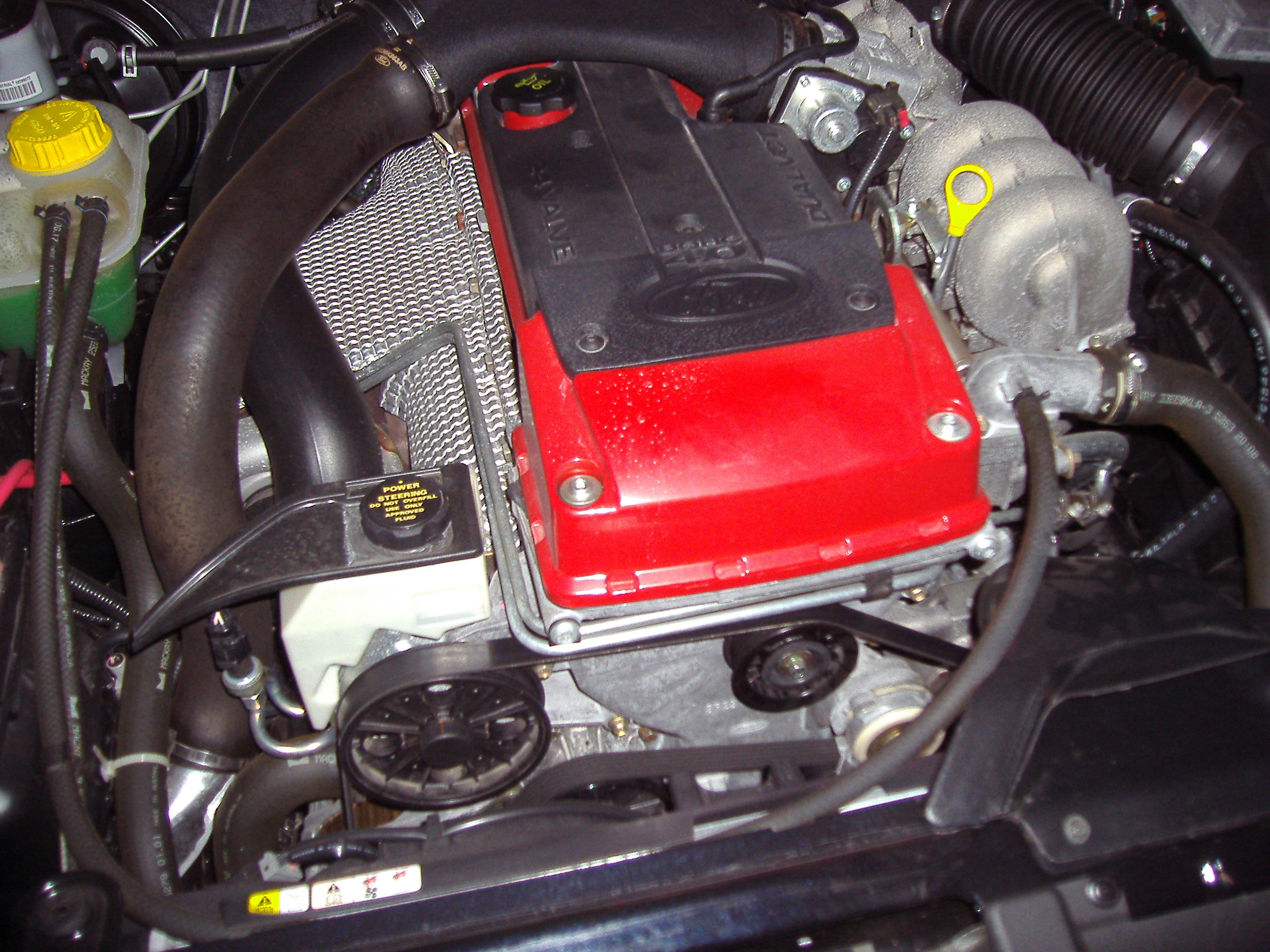

tab Sucker Moderating Team 32,303 Member For: 20y 10m 1d Gender: Male Location: Brisbane Posted 29/05/06 09:19 AM Share Posted 29/05/06 09:19 AM Hey Ford tech,I have a white residue build up on my engine tappet cover,(red section) its at the front and its also over the injection. What is it, sorry no pics.←Coolant perhaps?!?! Link to comment Share on other sites More sharing options...
FORDTECH Member 383 Member For: 21y 8m 27d Location: On the edge Posted 29/05/06 09:22 AM Share Posted 29/05/06 09:22 AM Hey Ford tech,I have a white residue build up on my engine tappet cover,(red section) its at the front and its also over the injection. What is it, sorry no pics yet.←Check your coolant level.Sounds like you may have a leak.Even though it's green normallywhen it dries it leaves a whitish powder stain.A pic would help. Link to comment Share on other sites More sharing options...
SHOCK Team Grandpa Donating Members 1,921 Member For: 18y 9m 27d Gender: Male Location: Hunter Valley Posted 29/05/06 09:22 AM Share Posted 29/05/06 09:22 AM Hey Ford tech,I have a white residue build up on my engine tappet cover,(red section) its at the front and its also over the injection. What is it, sorry no pics.←Coolant perhaps?!?! ←Tabster,Havent opened her up yet to spill any. Its starting to flake the paint. Also have rusted clips in the tray and slight rust in the lever section of the tailgate. Factory fitted I hear.... Link to comment Share on other sites More sharing options...
tab Sucker Moderating Team 32,303 Member For: 20y 10m 1d Gender: Male Location: Brisbane Posted 29/05/06 09:25 AM Share Posted 29/05/06 09:25 AM Hey Ford tech,I have a white residue build up on my engine tappet cover,(red section) its at the front and its also over the injection. What is it, sorry no pics.←Coolant perhaps?!?! ←Tabster,Havent opened her up yet to spill any. Its starting to flake the paint. Also have rusted clips in the tray and slight rust in the lever section of the tailgate. Factory fitted I hear....←Could be a leak though. The last time the clowns changed my radiator over it looked like a magpie was trapped in the engine bay and crapped itself everywhere.I missed out on the rust - touch wood though Link to comment Share on other sites More sharing options...
SHOCK Team Grandpa Donating Members 1,921 Member For: 18y 9m 27d Gender: Male Location: Hunter Valley Posted 29/05/06 09:28 AM Share Posted 29/05/06 09:28 AM Pic just taken on the way Link to comment Share on other sites More sharing options...
SHOCK Team Grandpa Donating Members 1,921 Member For: 18y 9m 27d Gender: Male Location: Hunter Valley Posted 29/05/06 09:45 AM Share Posted 29/05/06 09:45 AM here they are. Link to comment Share on other sites More sharing options...
FORDTECH Member 383 Member For: 21y 8m 27d Location: On the edge Posted 29/05/06 10:00 AM Share Posted 29/05/06 10:00 AM Have you washed you engine recently??Whatever it is there seems to be evidence around your power steering reservoir cap that there has been something pooled up around it.Also if you look at the inlet manifold all the white spots indicate something has been sitting on it as well.Your coolant level looks fine though so it's hard to say what it could be. Link to comment Share on other sites More sharing options...
SHOCK Team Grandpa Donating Members 1,921 Member For: 18y 9m 27d Gender: Male Location: Hunter Valley Posted 29/05/06 10:02 AM Share Posted 29/05/06 10:02 AM I have opened the bonnet to change the wiper fuild......that's it. No I didnt spill it over the engine. The ute has done 1750ks Link to comment Share on other sites More sharing options...
ZAP No boost, no bottle, just my foot on the throttle! Lifetime Members 7,935 Member For: 21y 12d Gender: Male Location: Sydney Posted 29/05/06 10:08 AM Share Posted 29/05/06 10:08 AM I would say the water pump O ring is gone and coolant is flicking up and onto the rocker cover. Is the underside of the bonnet stained as well ? Link to comment Share on other sites More sharing options...
SHOCK Team Grandpa Donating Members 1,921 Member For: 18y 9m 27d Gender: Male Location: Hunter Valley Posted 29/05/06 10:16 AM Share Posted 29/05/06 10:16 AM none what so ever on the thermal cover. The temp runs at about 11 to 11.30 at its hottest which is after about 10 min driving Link to comment Share on other sites More sharing options...
