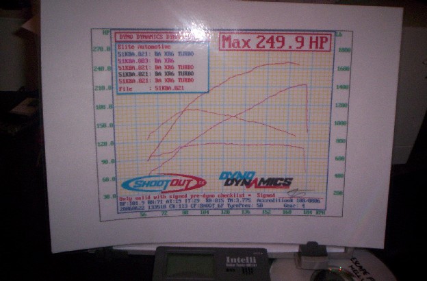

51KBA 2005 BA MK11 turbo Member 140 Member For: 19y 3m 8d Gender: Male Location: sunshine coast Posted 24/06/06 10:37 AM Author Share Posted 24/06/06 10:37 AM so I took my ute down to a mates dyno to check my air fuel mixture just to make sure while I was driving it that it wasnt leaning out , before I get my edit .so we threw it on the dyno , air fuel checked out nicely on 3 psi boost so we put the boost up to 5 psi and the air fuel was still fine (with the aspirated computer ) and I ran 249.9rwhp we then put the boost up to 6 psi and it ran 268.9 rwhp but it was a little lean so we backed it off my edit is on the way still saving cash but for a bolt on mod I thought the power was pretty good cheers 51KBA Link to comment https://www.fordxr6turbo.com/forum/topic/25563-na-to-turbo-project/page/5/#findComment-398241 Share on other sites More sharing options...
macka'sxr6t Member 1,480 Member For: 20y 10m 16d Location: Mildura Posted 24/06/06 12:30 PM Share Posted 24/06/06 12:30 PM Thanks for keeping us informed I'd say that you'd be pretty happy. It would be good to hear some feedback in your own words how different the car feels out on the road compared to when it was a N/A xr6.Interesting to see that the factory NA tune was happy with the turbo fitted and suppling enough fuel @ 6 psi. Just goes to show how rich they must be running from the factory.It will be interesting to see the results once you have it custom tuned with the Edit. Pls let us know torque readings as well as KW output.Once again well done macka Link to comment https://www.fordxr6turbo.com/forum/topic/25563-na-to-turbo-project/page/5/#findComment-398268 Share on other sites More sharing options...
51KBA 2005 BA MK11 turbo Member 140 Member For: 19y 3m 8d Gender: Male Location: sunshine coast Posted 24/06/06 12:34 PM Author Share Posted 24/06/06 12:34 PM man out on the road the improvement is crazy boost comes on really well and feels heaps more powerful I got a torque reading aswell I just dunno how to read it properly Link to comment https://www.fordxr6turbo.com/forum/topic/25563-na-to-turbo-project/page/5/#findComment-398269 Share on other sites More sharing options...
