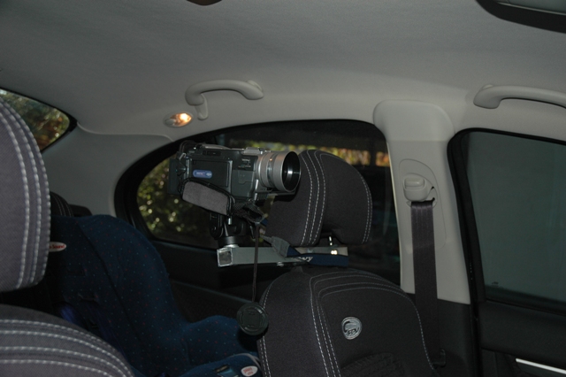

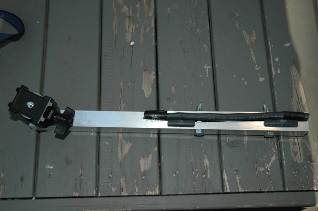

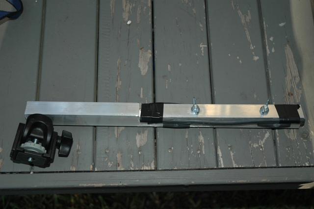

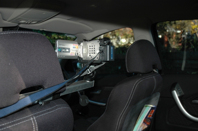

ZAP No boost, no bottle, just my foot on the throttle! Lifetime Members 7,935 Member For: 21y 4m 7d Gender: Male Location: Sydney Posted 13/05/06 07:23 AM Share Posted 13/05/06 07:23 AM Guys I am going to WSID next week, so I thought I would dust off the old video camera. The only problem was, how to mount it safely in the car.I thought about the best way to mount it and decided on the passenger headrest, as it is strong, high and level.I went to my local camera shop and bought a tilt/pan bit for my camera for $28. I then went to bunnings and bought 2 bolts, wingnuts and washers + some alloy squarebar (1m) and a alloy cutting wheel for my grinder total ($14).I used some rubber vac hose and split it on one side to line the edges to reduce the vibration. I took the camera around the block for a fang and over a few speed humps and the camera is rock steady.I did not think to take any pictures of the construction, but from the pics, you should be able to see how simple it is.I basicly drilled the holes for the headrest, bolts and the camera shoe. I then got the grinder and cut 1/2 the squarebar so that I can clamp it onto the headrest without removing it. I then buffed the edges to clean the rough edges and cut the vac hose on one side. I bolted the whole lot together and it was all done in about 30 mins. Link to comment https://www.fordxr6turbo.com/forum/topic/25356-video-camer-incar-mount/ Share on other sites More sharing options...

ZAP No boost, no bottle, just my foot on the throttle! Lifetime Members 7,935 Member For: 21y 4m 7d Gender: Male Location: Sydney Posted 13/05/06 12:44 PM Author Share Posted 13/05/06 12:44 PM I am happy to lend the camera and mount to any of the guys coming to WSID next wednesday. Just a few things I thought about after I built the mount. I would use a jigsaw instead of the grinder as it will be neater. I do not know if this will pass screwterneering, does anyone know how they are with cameras in the cars ? Link to comment https://www.fordxr6turbo.com/forum/topic/25356-video-camer-incar-mount/#findComment-381247 Share on other sites More sharing options...
