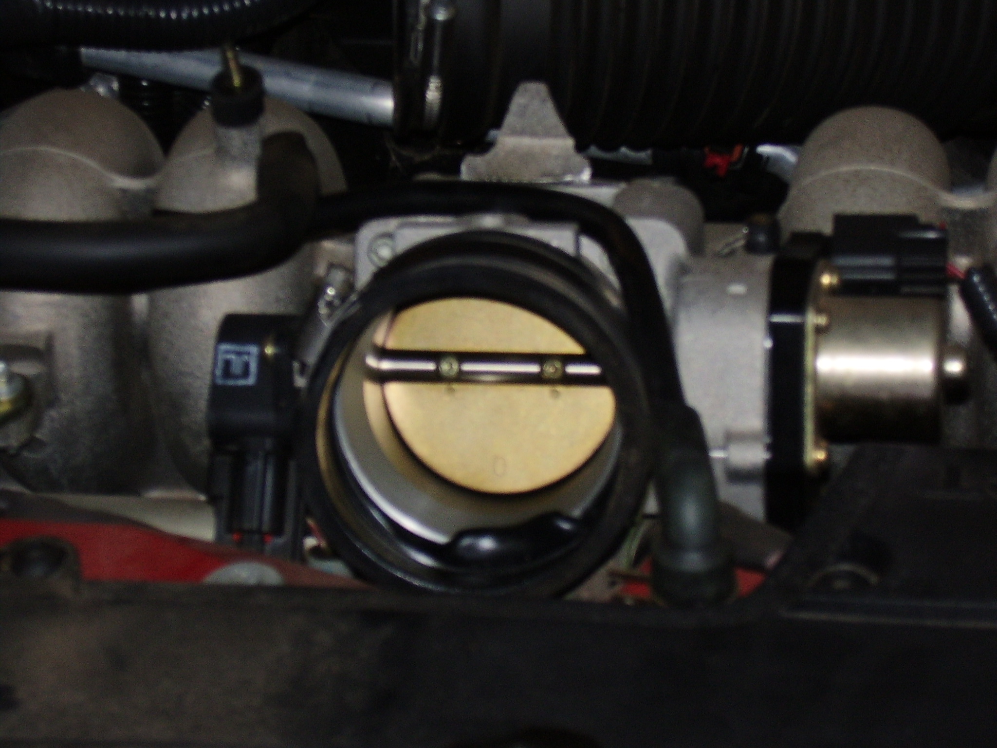

Street Tuner Member 727 Member For: 22y 29d Posted 29/01/06 12:23 AM Share Posted 29/01/06 12:23 AM That ones a bit harsh on Ford.the cars work fine from factory with none of the above problems, they haven't set the cars up to run 10 PSI or more.Common on all turbo cars is to blow out the spark when you up the boost, you should know this if you've worked on a high performance turbos.Russ<{POST_SNAPBACK}>Many of these cars have problems with poorly fitted hoses particularly around the throttle body, and loose clamps straight from the factory. I suggest you have a look at a few cars before categorically stating 'none' of thes problems occur. In the year 2005 adding 5psi of boost on a multi coil sequential ignition engine should not result in spark misfiring problems if the system is specified correctly. Maybe on a 1985 Cordia turbo. These days suffering spark blowout on a modern generation engine is a very rare occurence indeed, and generally points to a manufacturer using parts with output regarded as 'marginal' which is why some Ts with suffer this issue and some wont. This is what I have learned from 20 years of tuning high performance turbo engines. Link to comment Share on other sites More sharing options...

Xtreme F6 Team Xtreme Donating Members 1,680 Member For: 19y 11m 14d Gender: Male Location: Perth Posted 29/01/06 03:33 AM Share Posted 29/01/06 03:33 AM That ones a bit harsh on Ford.the cars work fine from factory with none of the above problems, they haven't set the cars up to run 10 PSI or more.Common on all turbo cars is to blow out the spark when you up the boost, you should know this if you've worked on a high performance turbos.RussMany of these cars have problems with poorly fitted hoses particularly around the throttle body, and loose clamps straight from the factory. I suggest you have a look at a few cars before categorically stating 'none' of thes problems occur. as Martin has said this is one of the biggest issues I come across when doing the usual checks on these motors, This and ppl just not doing up there clamps Link to comment Share on other sites More sharing options...
