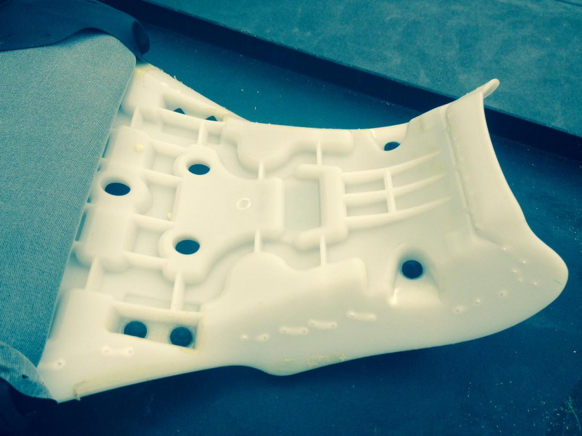

Boganspeed Will do skids for food Silver Donating Members 1,177 Member For: 13y 6m 26d Gender: Male Location: Perth SOR Posted 30/07/14 07:29 AM Share Posted 30/07/14 07:29 AM Okay Brains Trust, I need some advice.I've stripped this bike seat and will be having it trimmed without any foam.What I'm looking for is something to fill all the cavities so the trimmer can just lay a piece of 3 mill rubber over it and then cover it.I was thinking of maybe fibreglass resin that I can pour in and let it set but something rubbery would be even better.Any ideas? Link to comment https://www.fordxr6turbo.com/forum/topic/21890-wa-spotted-chit-chat-thread/page/2953/#findComment-1488611 Share on other sites More sharing options...
.Stripes. All stock bar the k&n panel filter Silver Donating Members 8,061 Member For: 13y 2m 17d Gender: Male Location: Perth Posted 30/07/14 07:42 AM Share Posted 30/07/14 07:42 AM Filler foam? Link to comment https://www.fordxr6turbo.com/forum/topic/21890-wa-spotted-chit-chat-thread/page/2953/#findComment-1488616 Share on other sites More sharing options...

Boganspeed Will do skids for food Silver Donating Members 1,177 Member For: 13y 6m 26d Gender: Male Location: Perth SOR Posted 30/07/14 09:46 AM Share Posted 30/07/14 09:46 AM On 30/07/2014 at 7:42 AM, .Stripes. said: Filler foam?Thought of that but it doesn't have any memory. Once it's squashed down, it'll stay there.So not really suitable. Link to comment https://www.fordxr6turbo.com/forum/topic/21890-wa-spotted-chit-chat-thread/page/2953/#findComment-1488656 Share on other sites More sharing options...
Lennox Member 2,586 Member For: 12y 3m 4d Gender: Male Location: Perth Posted 30/07/14 09:53 AM Share Posted 30/07/14 09:53 AM Selleys pro series sealant? They use it between concrete slabs in construction jobs I've been on..it's urethane so it dries like a hard rubber that's flexible but goes back into shape as well. Link to comment https://www.fordxr6turbo.com/forum/topic/21890-wa-spotted-chit-chat-thread/page/2953/#findComment-1488660 Share on other sites More sharing options...
GeGe6 Donating Members 1,980 Member For: 12y 10m 23d Gender: Male Location: Perth, SOR Posted 30/07/14 10:13 AM Share Posted 30/07/14 10:13 AM Could you use some sort of silicon, then prep seat by spaying with cooking oil.Fill with a silicon and lay baking paper over top to screed level, removing excess.Leave it to dry so it was a cast mould of the grooves. Link to comment https://www.fordxr6turbo.com/forum/topic/21890-wa-spotted-chit-chat-thread/page/2953/#findComment-1488662 Share on other sites More sharing options...
Ralph Wiggum Moar Powar Babeh Lifetime Members 19,332 Member For: 19y 8m 7d Gender: Male Location: Perth Posted 30/07/14 10:20 AM Share Posted 30/07/14 10:20 AM Two part liquid upholstery foam Link to comment https://www.fordxr6turbo.com/forum/topic/21890-wa-spotted-chit-chat-thread/page/2953/#findComment-1488663 Share on other sites More sharing options...
