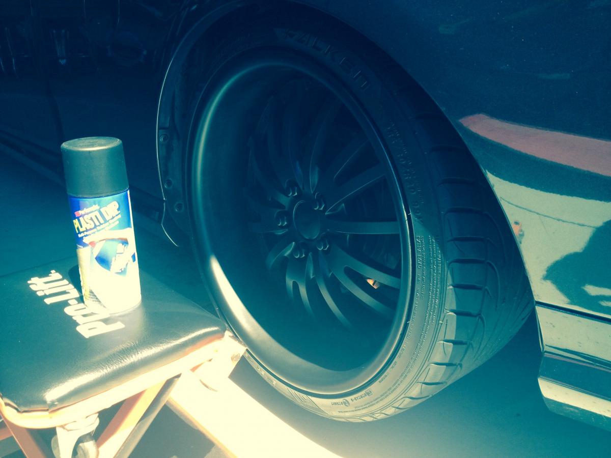

Boganspeed Will do skids for food Silver Donating Members 1,177 Member For: 13y 5m Gender: Male Location: Perth SOR Posted 24/12/13 02:40 AM Share Posted 24/12/13 02:40 AM Been looking at options for my rims.I really loved the look of the full black plastidipped wheels but didn't like the way the textured surface held dirt and sand.So I peeled the plastidip off the lips a few months back but was never completely happy with the look so I looked into powder coating and whatnot but in the end I opted for the $60 DIY option and am recoating the lips today.Couple of lessons learnt today.1) wax and grease remover is great for making sure everything is spot on clean prior to coating but the existing plastidip coating didn't like it at all and rubbed off like it was thinners. No stress though, just resprayed affected areas.2) my shiny tyre stuff won't let masking tape stick to the tyre. But on the same token, neither does the plastidip so clean up should be a piece of piss.Couple more coats and then I'm done. Link to comment Share on other sites More sharing options...
Lennox Member 2,586 Member For: 12y 1m 9d Gender: Male Location: Perth Posted 24/12/13 04:12 AM Share Posted 24/12/13 04:12 AM (edited) Cheers for the tips. Was wondering about an easy way to get plastidip off I bought some secondhand rims that someone has dipped roughly and there is a bit of overspray to get rid of Btw can you use those strong mag wheel cleaner sprays or will it take off the plastidip? Edited 24/12/13 04:13 AM by Lennox Link to comment Share on other sites More sharing options...
Boganspeed Will do skids for food Silver Donating Members 1,177 Member For: 13y 5m Gender: Male Location: Perth SOR Posted 24/12/13 05:22 AM Share Posted 24/12/13 05:22 AM If it's plastidip mate, you just pick at it with your fingernail or a toothpick and once you get an edge, it'll just peel off like a real thin layer of shrink wrap.Seeing how easy wax and grease remover broke down the plastidip, I wouldn't use anything other than soapy water to clean it.Really mate, it's that easy to spray on, if it's a bit rough, you might want to just peel it off and redo it. I reckon 3 cans would probably do a set of wheels, I used 4 originally to be sure.1.5 today for the lips and a quick recoat of the rest. Link to comment Share on other sites More sharing options...
Lennox Member 2,586 Member For: 12y 1m 9d Gender: Male Location: Perth Posted 25/12/13 11:00 AM Share Posted 25/12/13 11:00 AM The painting itself is fine just a lot of little overspray specs on the dish and I cbf sitting there scraping it all off haha so ill use wax and grease remover. Cheers Link to comment Share on other sites More sharing options...
