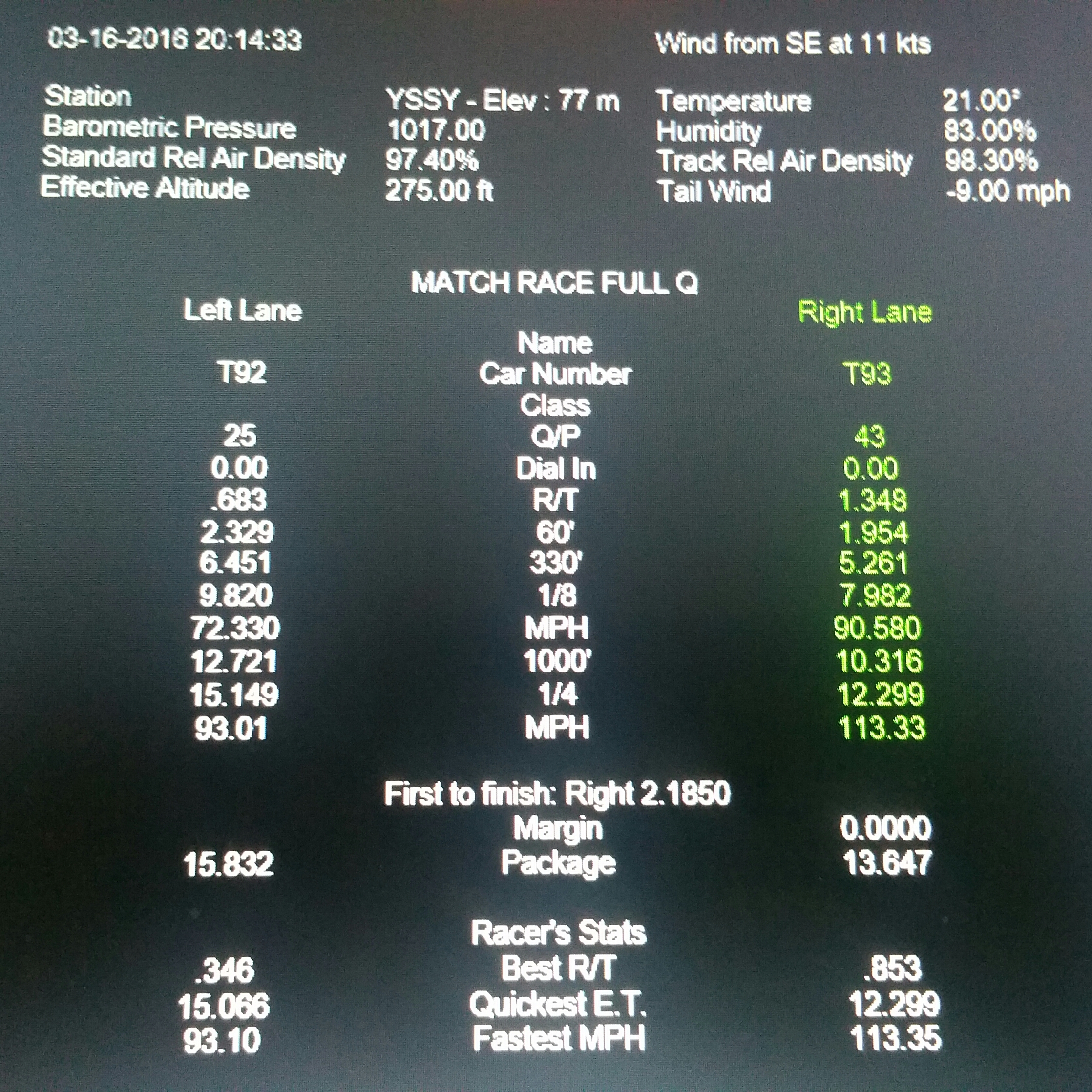

peps New Member 18 Member For: 10y 2m 21d Posted 05/04/16 12:43 AM Share Posted 05/04/16 12:43 AM 60' 1.954 330' 5.261 1/8 7.982 Mph 90.580 1/4 12.299 Mph 113.33 Link to comment Share on other sites More sharing options...
discostig Manual mode ________________________ All day, erryday Donating Members 13,798 Member For: 17y 3m 15d Gender: Male Location: Probably above atmospheric pressure Posted 05/04/16 05:20 AM Share Posted 05/04/16 05:20 AM Seems about right to me, 12.2 at 113mph. Not overly far off either way by the looks? Lowering the 60' is difficult, 1.9 is the best I've ever done on street tyres. I also only use foot brake. Link to comment Share on other sites More sharing options...
camo86T Silver Donating Members 1,810 Member For: 11y 27d Gender: Male Location: SW Sydney Posted 05/04/16 07:06 AM Share Posted 05/04/16 07:06 AM Think peps was questioning what was left in it as he ran et streets, not street tyres? Link to comment Share on other sites More sharing options...
peps New Member 18 Member For: 10y 2m 21d Posted 05/04/16 07:49 AM Share Posted 05/04/16 07:49 AM Correct if tyre pressure or the airbags can be changed to improve. Im guessing so if 1.9 is possible on street tyres. Link to comment Share on other sites More sharing options...
MattyP MattyP Cruise Control 6,317 Member For: 12y 10m 7d Gender: Male Location: Central Coast Posted 05/04/16 07:50 AM Share Posted 05/04/16 07:50 AM Ive done many 2.0s on street tyres, 275 wide though Link to comment Share on other sites More sharing options...
Lennox Member 2,586 Member For: 12y 13d Gender: Male Location: Perth Posted 05/04/16 11:39 AM Share Posted 05/04/16 11:39 AM 28 is pretty high for et streets. Drop em to like 20 and see how you go. That mph seems a little low as well for 315rwkw (well comparing to mine anyway), I went last week and it was quite humid and I was hitting about 186kmh/115mph and 12.2-12.4 with 1.8 to 1.9s 60 footers Are you manual shifting as well? Best I've done with this power is 11.87 on a nice cold winters night so hopefully you'll be able to hit something like that with practise if it's cold. Link to comment Share on other sites More sharing options...
peps New Member 18 Member For: 10y 2m 21d Posted 07/04/16 02:22 PM Share Posted 07/04/16 02:22 PM Thanks for your help.. ill definitely drop the tyre pressure next time I run.. just with the airbags + leaf springs does anybody have an idea on how inflated I should have them.. either way the rear doesn't go full hard. So im not to sure as my understanding is the rear should be hard front soft. Link to comment Share on other sites More sharing options...
Lennox Member 2,586 Member For: 12y 13d Gender: Male Location: Perth Posted 07/04/16 10:26 PM Share Posted 07/04/16 10:26 PM Just a rookie myself but pretty sure you want the rear soft so it can squat 1 Link to comment Share on other sites More sharing options...
MurdoK Donating Members 719 Member For: 14y 8m 18d Gender: Male Location: Perth,WA Posted 07/04/16 10:29 PM Share Posted 07/04/16 10:29 PM With lennox, weight transfer and all that. Link to comment Share on other sites More sharing options...
discostig Manual mode ________________________ All day, erryday Donating Members 13,798 Member For: 17y 3m 15d Gender: Male Location: Probably above atmospheric pressure Posted 08/04/16 06:12 AM Share Posted 08/04/16 06:12 AM That's why I drive around with all my work gear in the boot Link to comment Share on other sites More sharing options...
