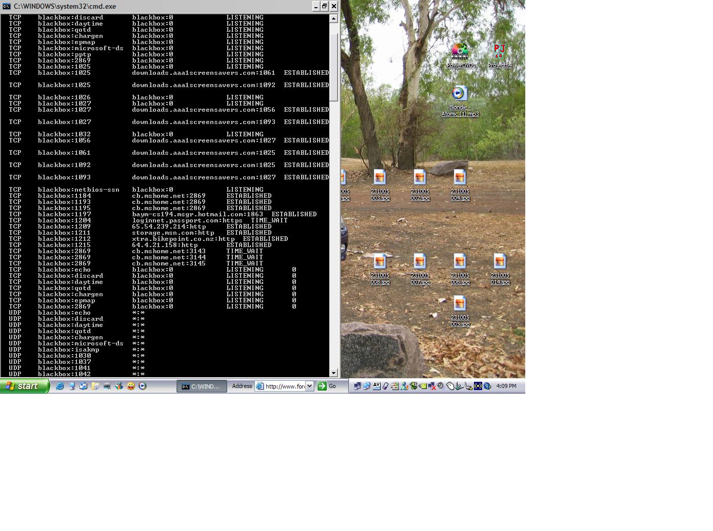

NT TURBO Member 1,128 Member For: 22y 2m 5d Gender: Male Location: Darwin NT Posted 28/10/05 01:17 PM Author Share Posted 28/10/05 01:17 PM hmm means to me?? Link to comment https://www.fordxr6turbo.com/forum/topic/20964-pc-prob/page/2/#findComment-309511 Share on other sites More sharing options...
XR64T Are we there yet? Donating Members 703 Member For: 21y 7m 19d Gender: Male Location: Sydney, NSW Posted 28/10/05 03:00 PM Share Posted 28/10/05 03:00 PM NT TURBO said: hmm means to me??Hey mate,You have a serious amount of sh1t running there... With everything closed down, should be maybe 20 lines on a clean machine.You have quite a few web (http) sessions up there, but you only have the forum showing. What else is running? Right click on the bottom task bar and choose task manager. Check the application and processes tabs and look for anything unusual. Sort by CPU and look for anything at the top of the list using up CPU cycles. Link to comment https://www.fordxr6turbo.com/forum/topic/20964-pc-prob/page/2/#findComment-309540 Share on other sites More sharing options...
mickq Member 740 Member For: 22y 28d Posted 29/10/05 11:38 AM Share Posted 29/10/05 11:38 AM NT TURBO said: hmm means to me??<{POST_SNAPBACK}>hey a question, who is your Internet Service Provider (ISP)?is it a company called hotline.net.au or similar? And do you have something like a download limit alerter or something installed from them? That entry is the only one I dont recognise. The 66.249.89.104 entry is OK...that's google.The blackbox.mshome.net bit is ok too, as that's something Windows makes up when you use Internet Connection Sharing (ICS) on your PCs.The large number of UDP listening ports is a little unusual, but none of them look suss and nothing is actually connected to them (at the time you did netstat).It also seems you have netbios turned on. if you dont need it, turn it off. You wouldnt believe what you can get access to using that if you know what you are doing - you can even browse other people's hard disks!Just as a safety measure, try this (if it kills your net connection on the other PC, then un do it)1) Go to Control Panel2) Double click on Network Connections.3) Right Click on Local area Connection and choose Propeties4) A bunch of tick boxes will appear. For normal use you should ONLY have ticked the following:- Client for Microsoft Networks- Internet Protocol (TCP/IP).- You may also have one such as Internet Connection Sharing (ICS). Tick that as well if its there.UNTICK File and Printer Sharing for Microsoft NetworksUNTICK QOS Packet Scheduler (dont need it). Also, what sort of internet connection do you have? Dial up modem, ADSL, Cable internet? Link to comment https://www.fordxr6turbo.com/forum/topic/20964-pc-prob/page/2/#findComment-309752 Share on other sites More sharing options...
NT TURBO Member 1,128 Member For: 22y 2m 5d Gender: Male Location: Darwin NT Posted 31/10/05 02:06 AM Author Share Posted 31/10/05 02:06 AM My ISP is westnet. And it is an ADSL connection.Sorry for the slow reply but my net is down until I fix this, I will have another look at it tonite.BTW CB is the computer at the phone point, and blackbox is the puter in my other room. Link to comment https://www.fordxr6turbo.com/forum/topic/20964-pc-prob/page/2/#findComment-310116 Share on other sites More sharing options...
NT TURBO Member 1,128 Member For: 22y 2m 5d Gender: Male Location: Darwin NT Posted 31/10/05 06:42 AM Author Share Posted 31/10/05 06:42 AM And this machine, how do I terminate connections.?? Link to comment https://www.fordxr6turbo.com/forum/topic/20964-pc-prob/page/2/#findComment-310228 Share on other sites More sharing options...
