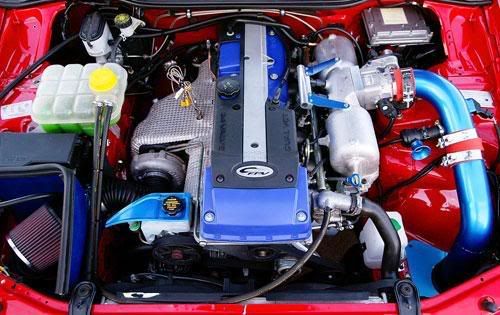

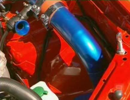

ROLMDL role model Member 1,111 Member For: 19y 2m 3d Gender: Male Location: Melbourne,S.E Posted 15/03/07 01:23 PM Share Posted 15/03/07 01:23 PM does anyone know if the FPV DRFT6 car still uses the same bosch BOVlike we have on out T's? I got a couple of pictures from the car and from the looks of it its the same BOV we have but the trumpet on the side outletwere I thought boost comes threw?? then why have FPV desigin it like this on theDRFT6???here a few pics. Link to comment https://www.fordxr6turbo.com/forum/topic/19378-bov-reverse-vented/page/2/#findComment-509027 Share on other sites More sharing options...
qwigybo Member 288 Member For: 19y 9d Location: bendigo home of SFA Posted 19/03/07 06:01 PM Share Posted 19/03/07 06:01 PM (edited) that's the right side to have vented I originally thought the same thing and blocked off the wrong side.now it makes a nice sneeze soundwouldn't mind that plenum on the drift6 either Edited 19/03/07 06:02 PM by qwigybo Link to comment https://www.fordxr6turbo.com/forum/topic/19378-bov-reverse-vented/page/2/#findComment-510952 Share on other sites More sharing options...
